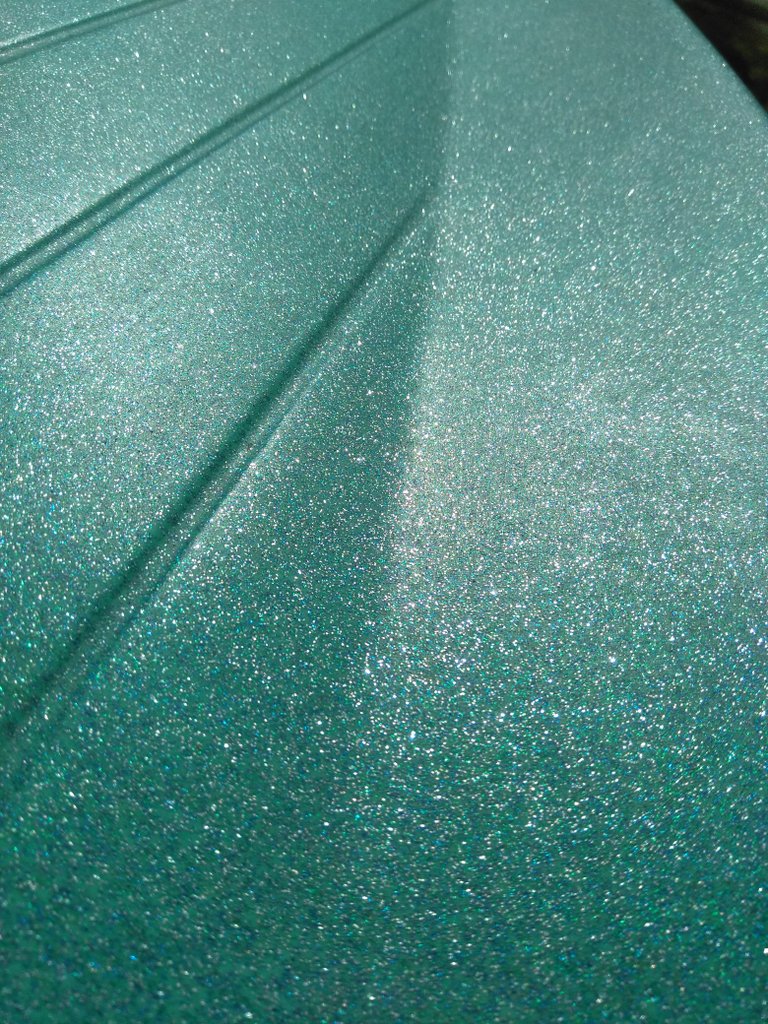

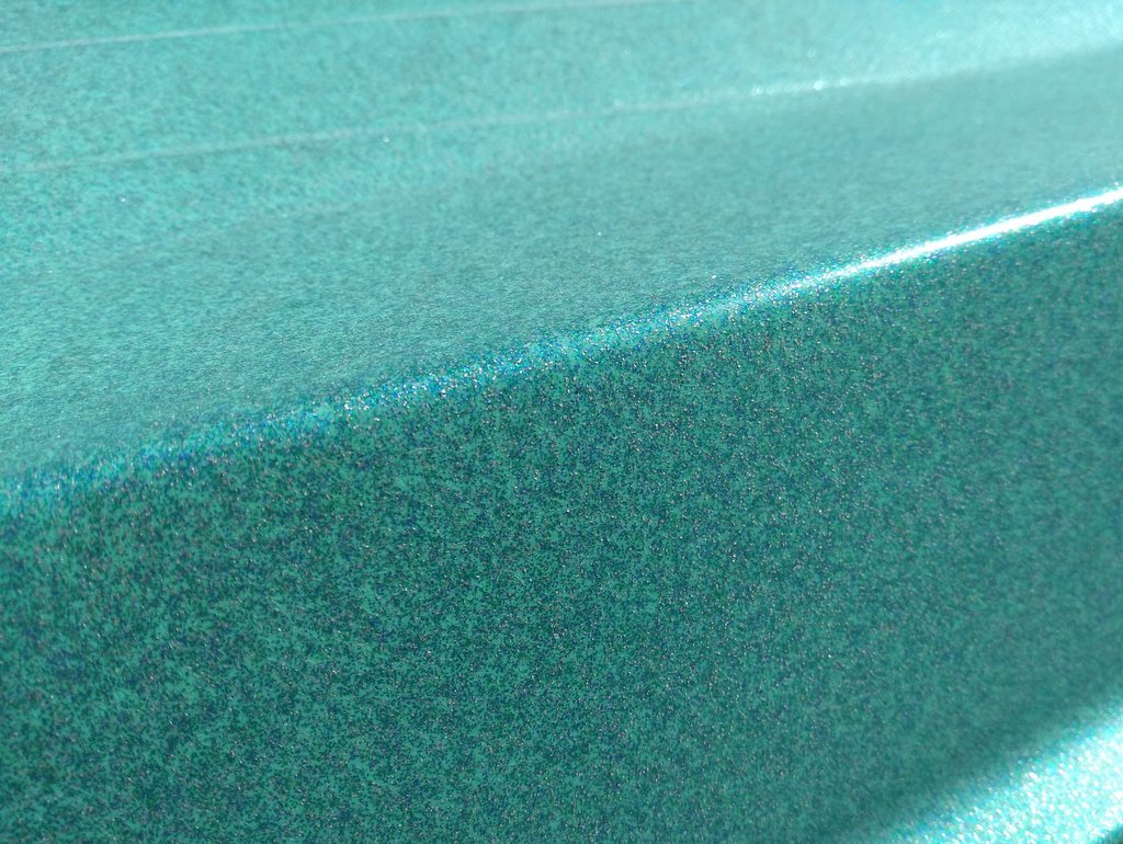

Hi folks.
I would like to save the metalflake finish on the topside of my G3, or atleast postpone a total refinish for a few years as I don't have the funds to do it correctly now, but would like to continue using the boat, without further degrading the finish.
It seems to have years of sun-damage, and is very faded, the clearcoat seems to be gone and the finish is rough to the touch.
I live in a 3rd world country and there is no metalflake specialists, or bass boat gelcoat repairers nearby.
Is there any general automotive products or methods you would recommend to thoroughly clean and prep the topsides with, and to apply a sealer or clearcoat of some sort which would enhance and protect the remaining metalflake? And not lift and peel within a season.
