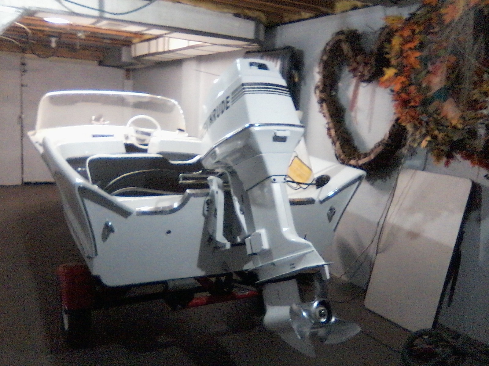

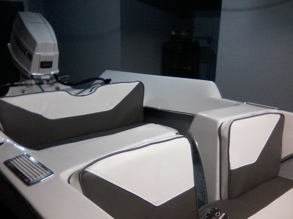

This is the second ski mate I've rebuilt. "Original" is subjective when it comes to old first generation glass boats. Whatever was on the shelf or could be purchased from manufactures in bulk were used. When that supply ran out the builders just used others.

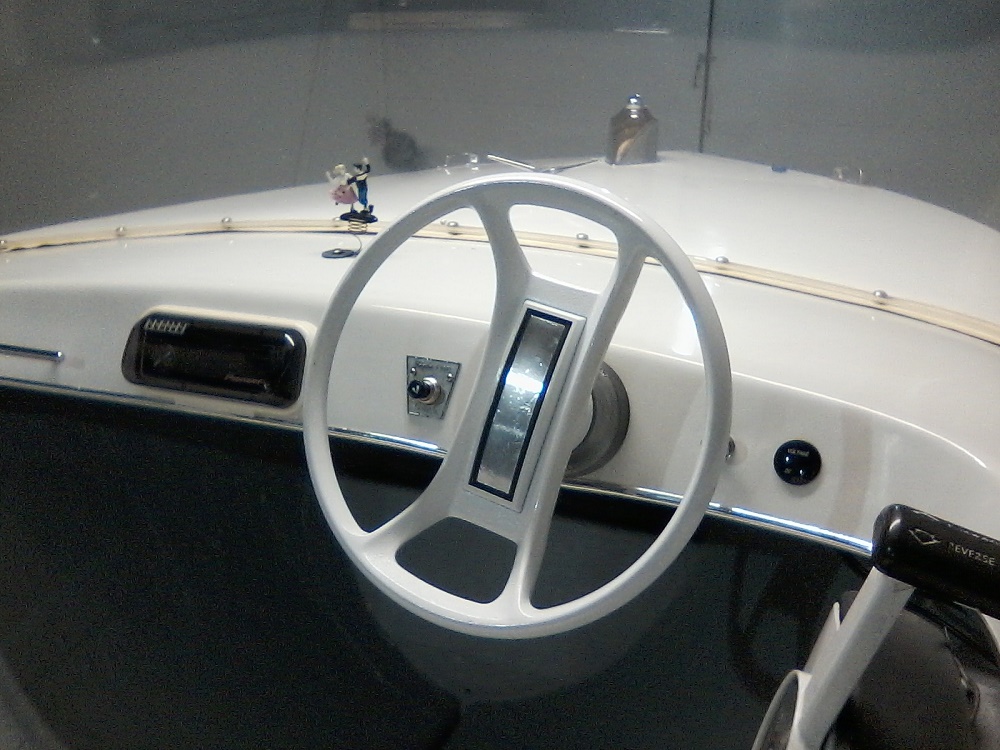

The white one has the original hardware. The original steering wheel was no doubt a cable pulley system. the push pull that is on there now is far better and I would stick with that. The hole in the bow could be from just about anything, spotlight? air horn? flag? I don't believe the ski mate came with seat back aft. I've seen some with backs and others without. Filling holes is a pretty easy project but then you have to match paint etc. If you like the boat get it and enjoy it. I'll bet the padding on the dash is hiding some pretty nasty holes from gauges, radio switches et al.

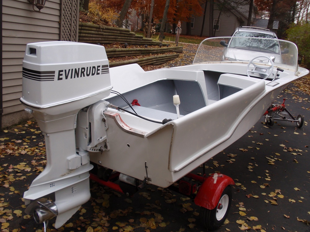

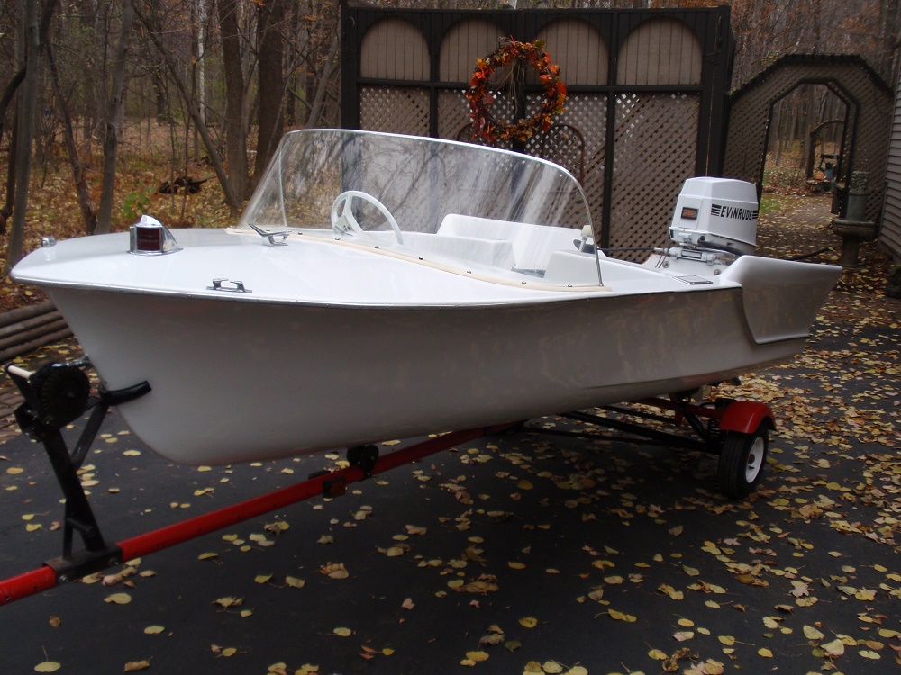

The white one has a '78 Evinrude 70hp. It's a 1960 and has the molded front seat backs. The orange one is a '57-59 (could never figure it out) but has lower, smaller fins with no seat backs or windshield.

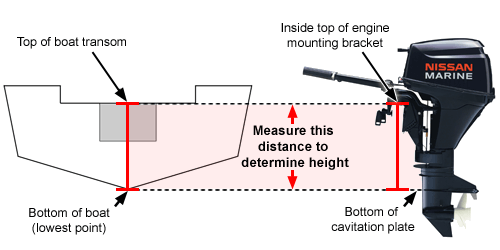

As a side note if you look at the white boat you will see that I raised the transom so I could put a long shaft motor on it. It initially came with a 15" transom. If down the road you want to upgrade to a long shaft motor it's really not that difficult to do if you're a little handy with some basic tools.
