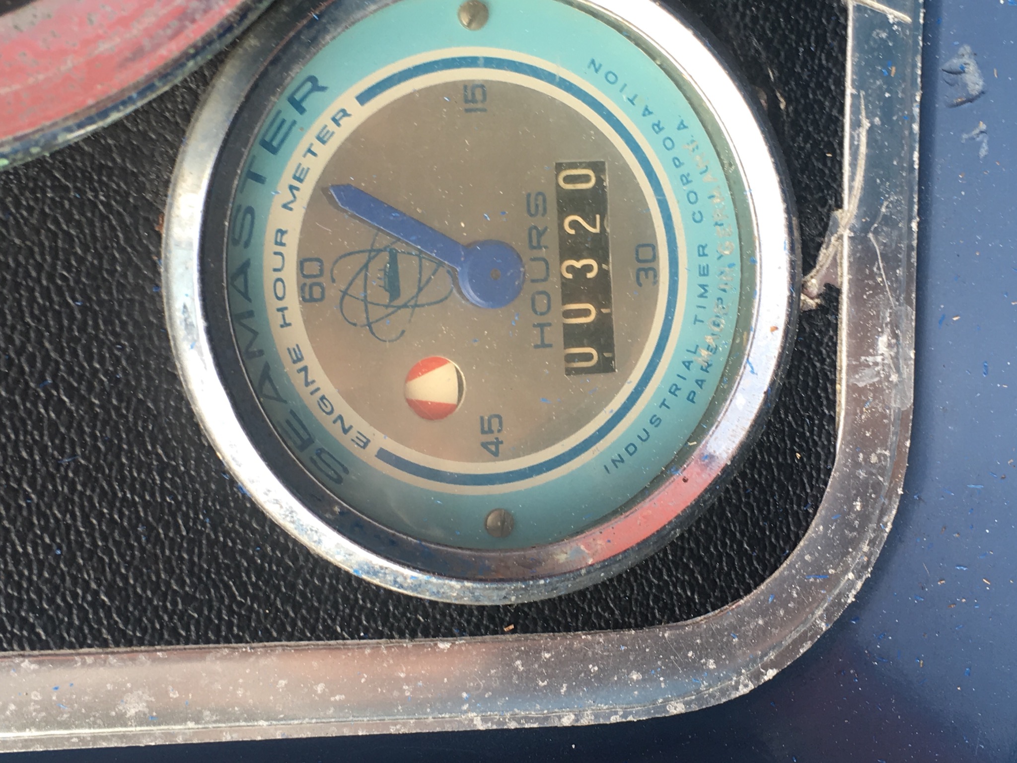

TOPIC: Barn Find 320hr Evinrude Rogue 200

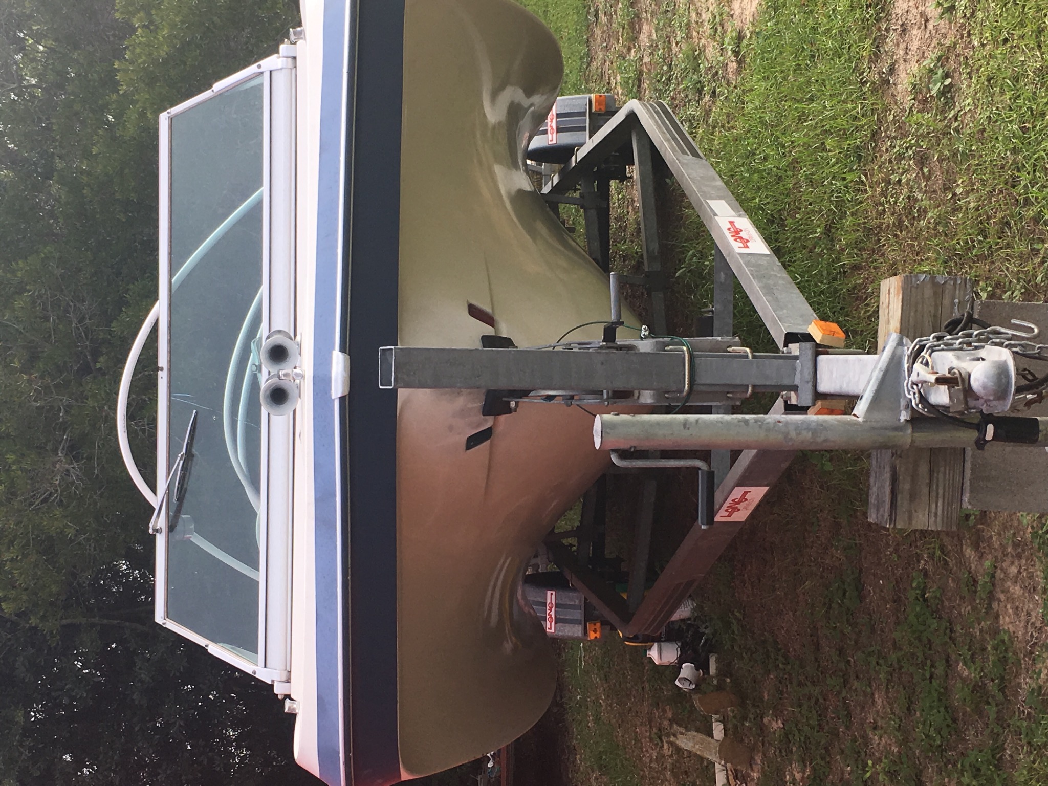

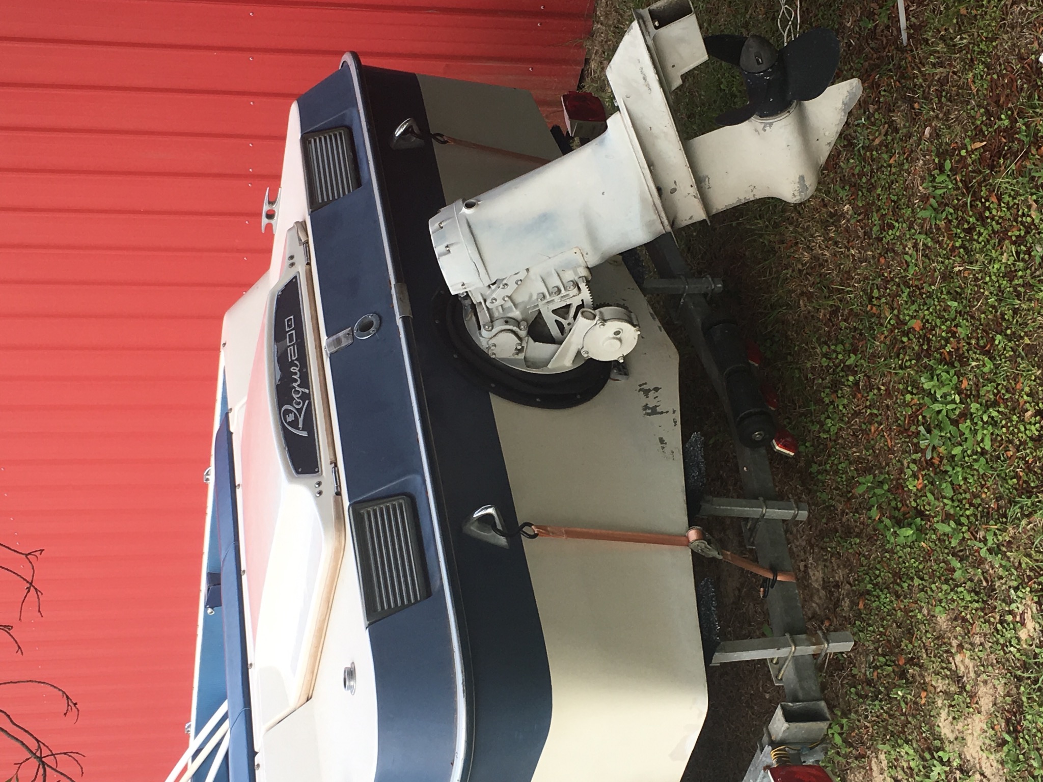

The trailer was backed in once.

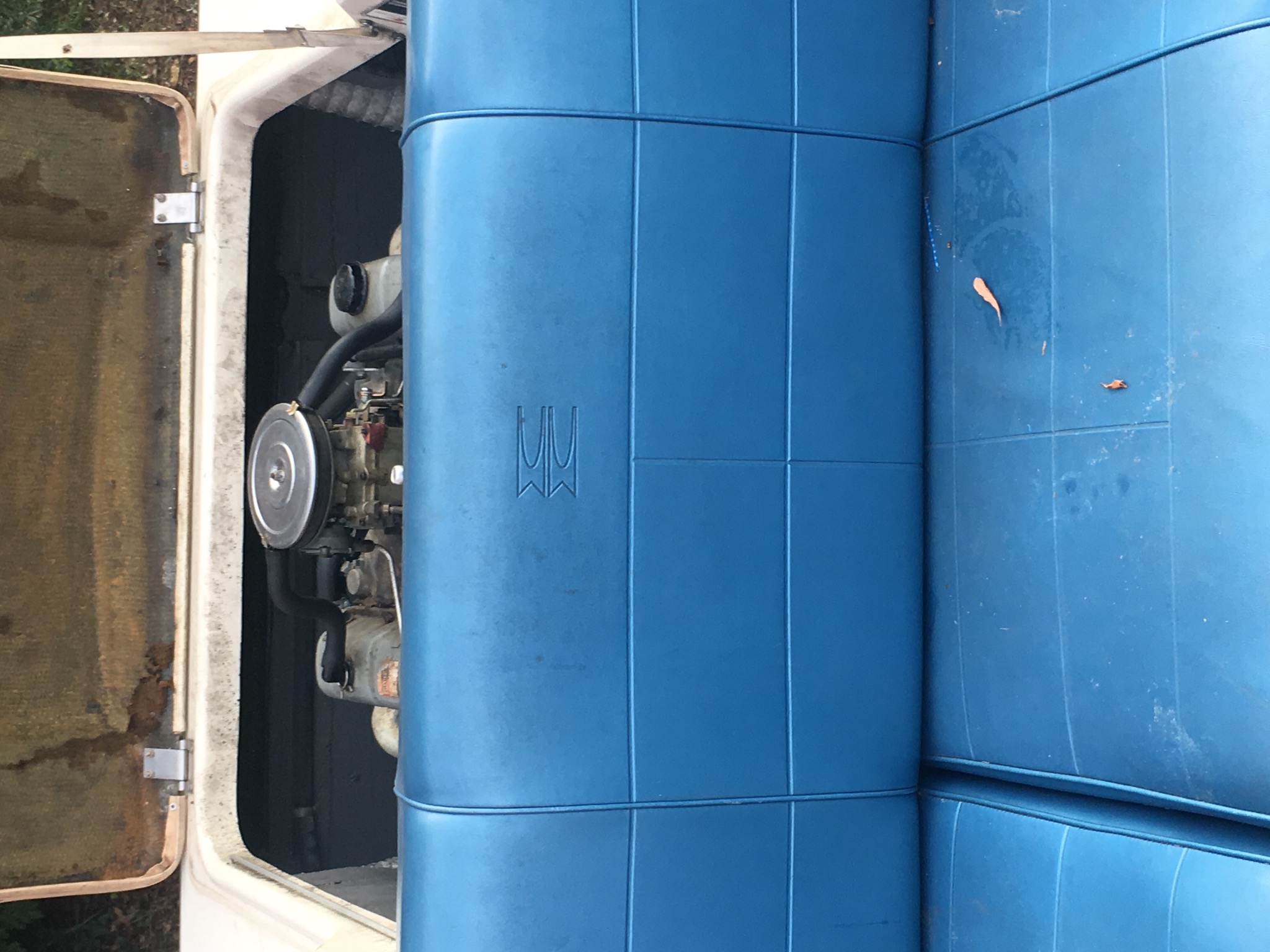

Picked the boat up with the new trailer and parked it. The top is all original and still perfect.
The only 2 thing not original is the fan/blower motor and the trailer.
Are these boats designed for Saltwater use if flushed properly.
Would It be a disservice to put Hours on this boat and use in salt and brackish water.

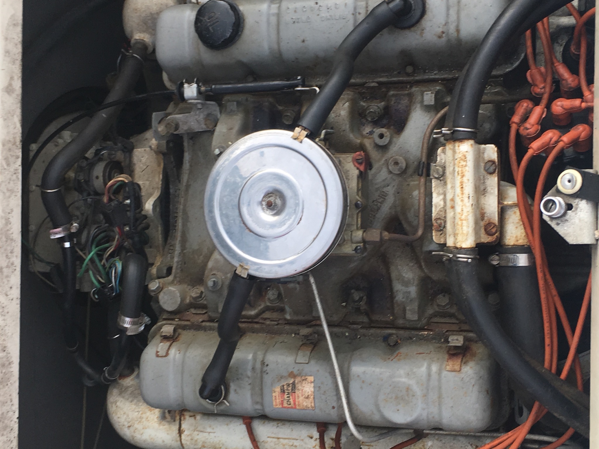

If you think I should sell it, would you just buy the few things it needs. Gas Tank, mechanical fuel pump repair kit or after market Pump, a battery and the foot needs to be serviced I would think. Maybe check the roller bearing.
Are the parts mentioned for the Buick Motor easy to find?
I was told it’s Buick nail Head but according to what I’ve read it’s not. Is that true?

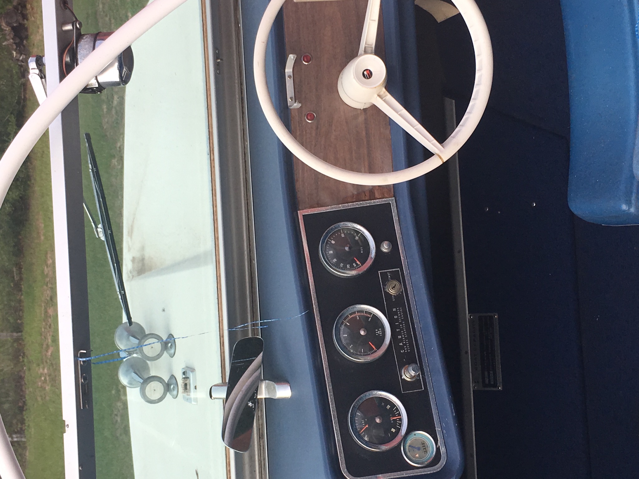

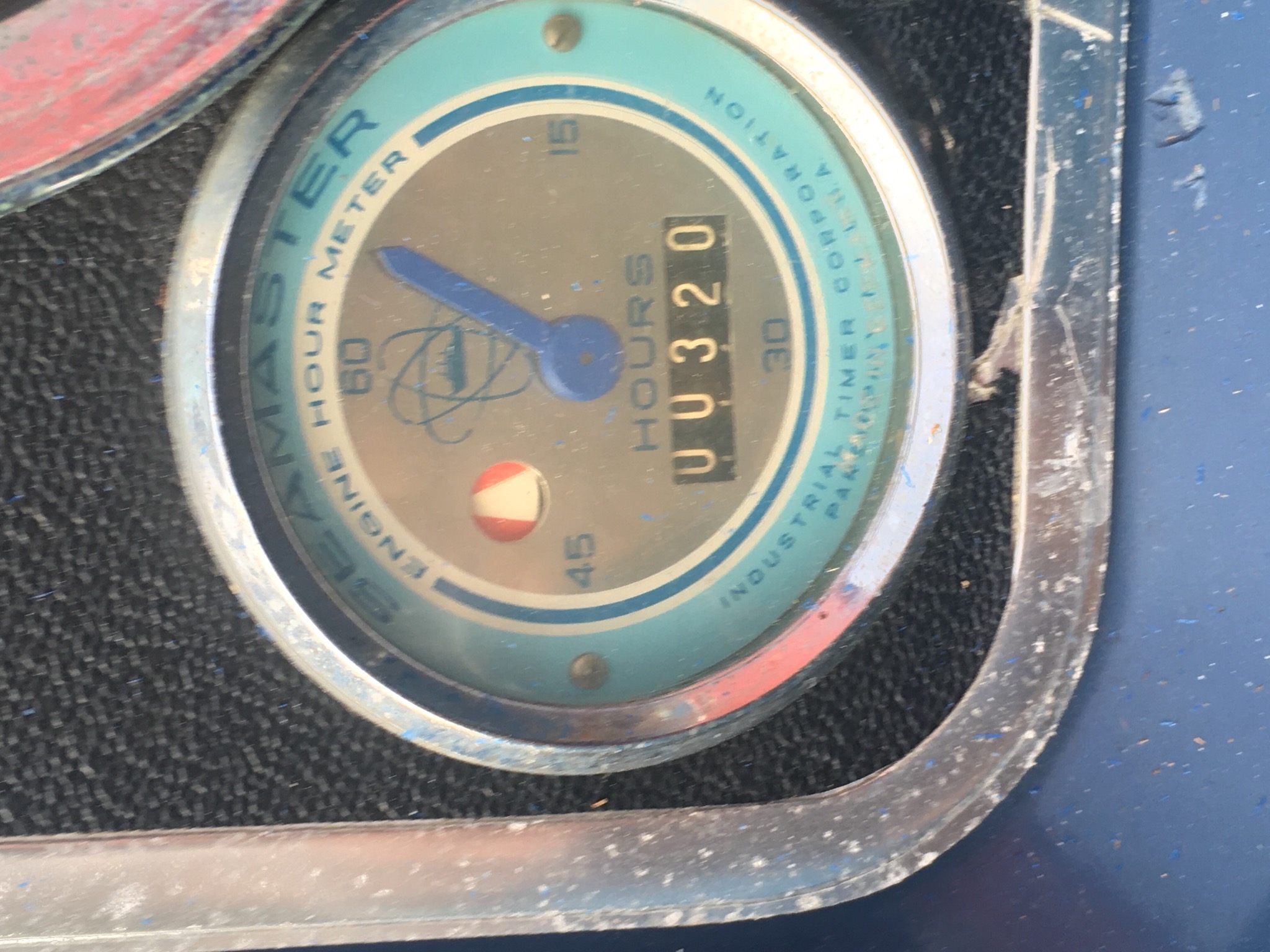

If I was going to ever try to bring a boat back to showroom condition this would be the boat .
Zoom in on the aluminum trim around gauges.
If I keep it I’m going shine that up.
What’s worth more,a boat in showroom condition.

Wow, That is almost a spittin' image of the first boat I fixed up. That is a platform that can't be beat for what you are describing. The fiberglass on that thing is probably 1/4" thick and tough as nails, you could run over logs etc and hardly hurt it. Built during the time when glass boats were coming into production and they weren't sure how they would hold up. The boat is stable as a rock, you could stand on a gunwale and not tip over. The motor is iron and bulletproof and as you say parts are still around. The lower unit might be suspect with the electric shift but if it was taken care of it should be ok. There is a special OMC oil for those lower units that is still sold I think it's called type "C". What's really nice about those LUs is that you can tilt them completely out of the water if you get is some really shallow spots. Parts for the 800s are getting harder to find but they're still around.
If you decide to part it out post the parts on eBay. There is a website somewhere that is dedicated to those boats, just search google.
Some of those lower units had a garden hose connection on the starboard side where you could connect to flush it out.
