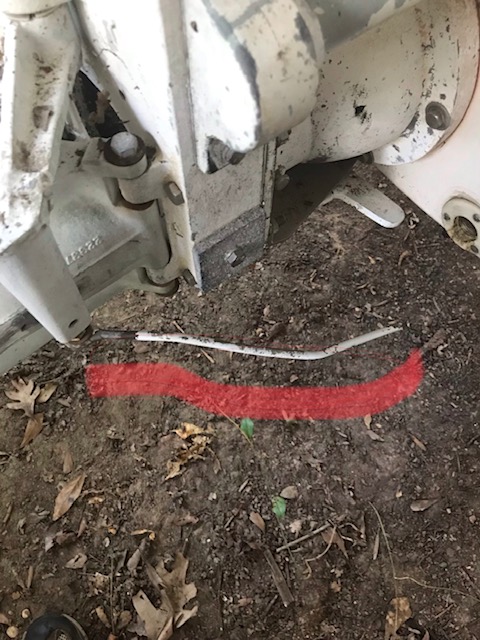

I have highlighted a rod coming from the directional nozzle on the jet but I fail to see where it connects or that anything is missing. Can anyone identify that part?
Thanks

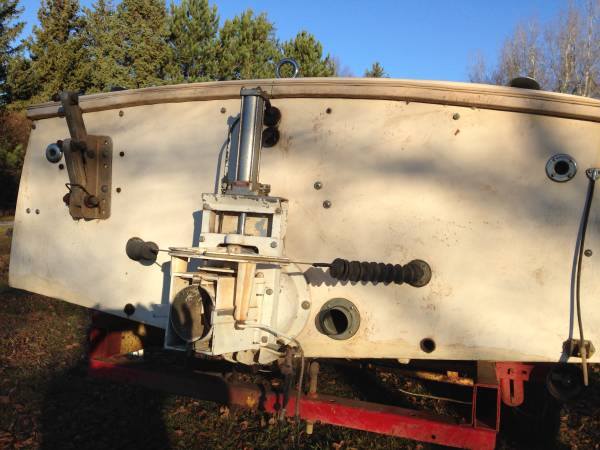

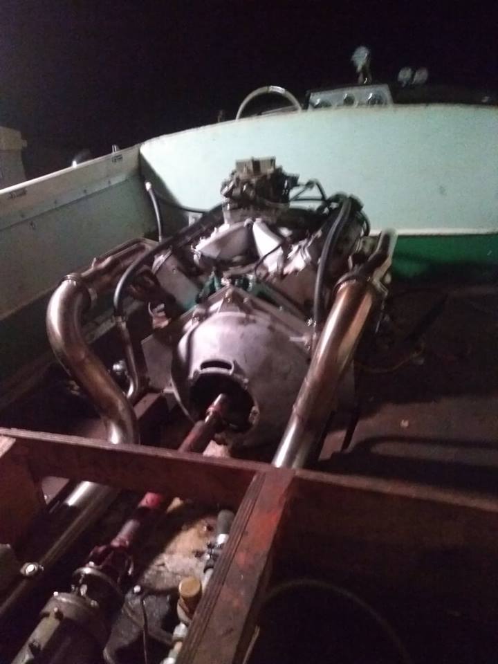

The Rod connects to a "rudder" plate under the jet. it connects the steering gates to this rudder, and any slight of miss alignment will cause the wheel to pull hard to one direction or the other, just bend the rod until the pull in the steering wheel is gone. Second Picture is just to show off my LS Swap to a fellow Turbocraft owner.
Good luck in your project.
