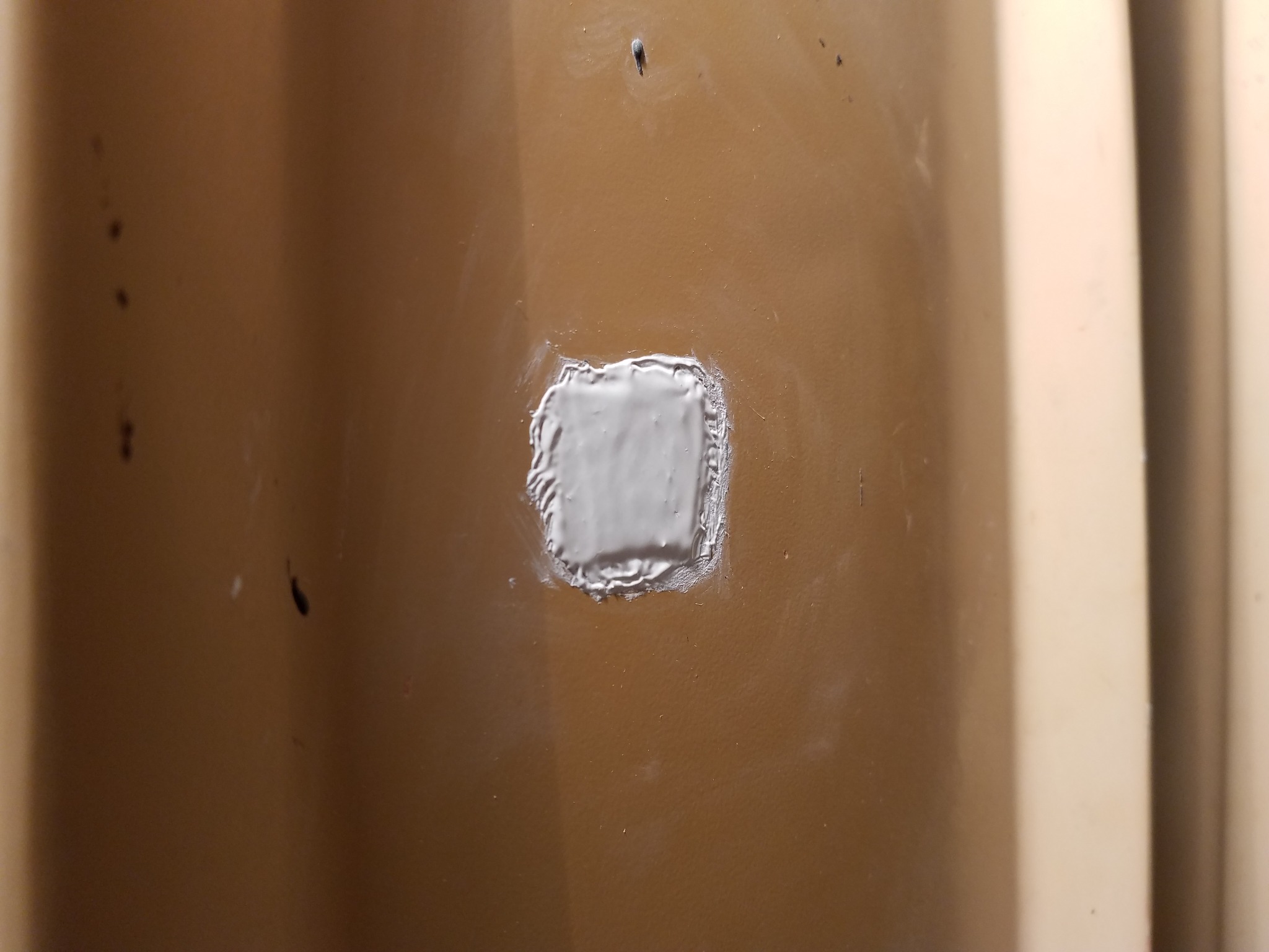

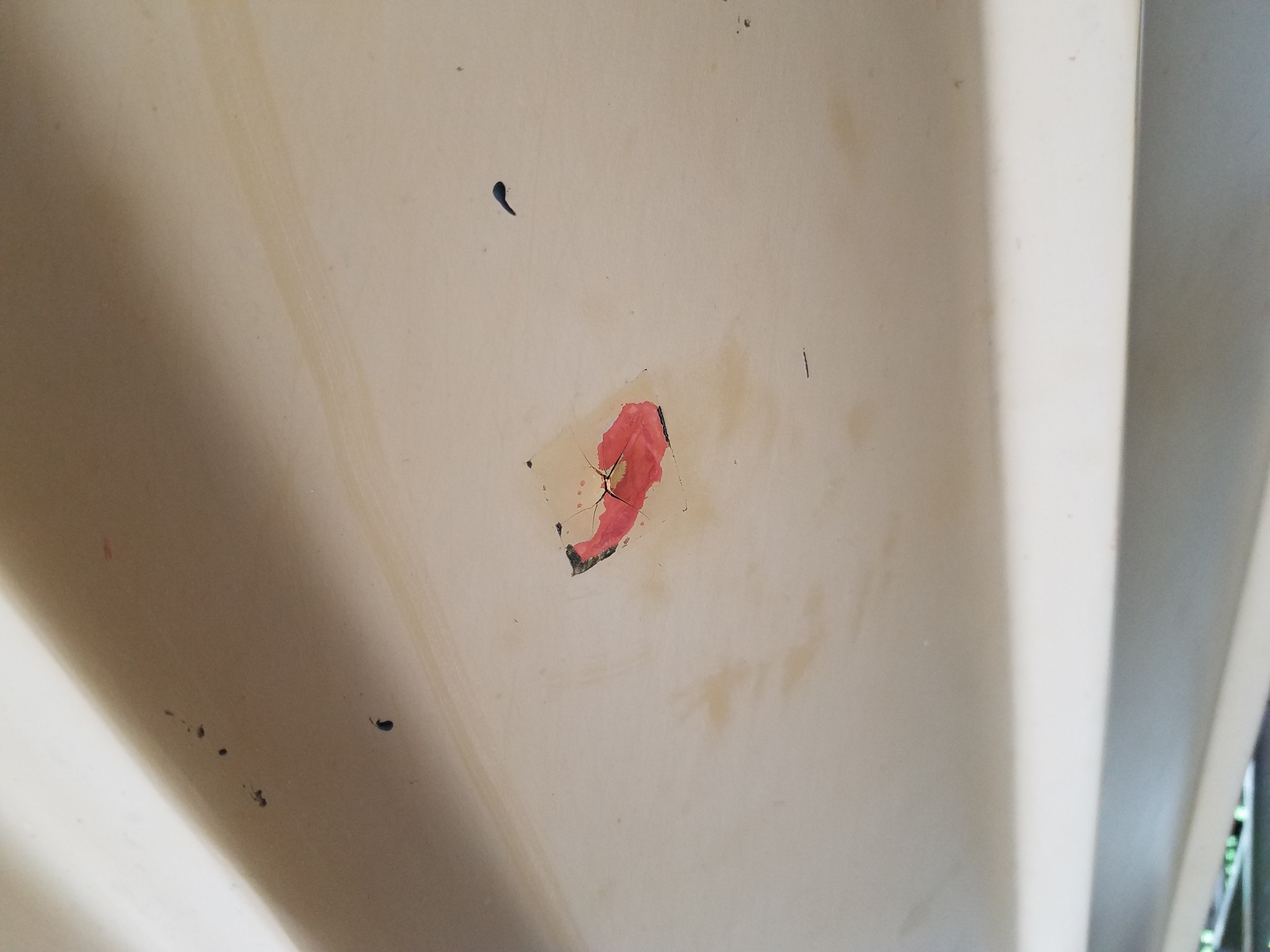

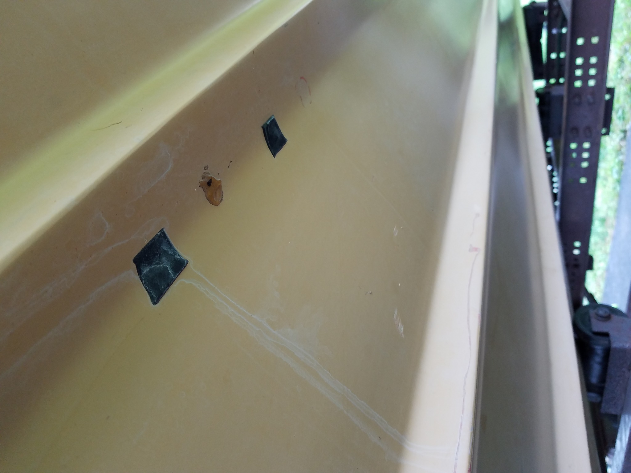

About 10 years ago, the hull on my boat was patched by an auto body shop from too long of bolts being used for the seats. Occurred in 3 spots, patches are about 1" square. I noticed one of the patches which is a hard plastic fell off. The auto body shop that did the repair is very busy and my boating season is about over. Is there a way i can do the repair myself? I attached a couple pics. It is below the waterline.

That is a pretty simple repair requiring so simple tools and while you are at it you might as well go ahead and fix the other two holes.
With a Dremel Tool or other small sander/grinder carefully grind to area back an 1-2 inches to good solid glass. Rough up the Gel coat a bit with 80 grit paper and wipe it all down with Acetone.
Using a Chop Strand (available at auto parts stores in a kit with resin, Bondo brand) and see if you can get a small piece of fine fiber glass cloth. Cut layers of glass like a Topo Map with a layer the fit inside the hole and slowly getting larger working the glass matte in wet layers into each area....No Bubbles between layers, layer 2-3 layers and let cure, lightly sand with 80 grit paper and add additional layers until the area is built up to just above the Surface of the gel coat.
Sand back to the Gel Coat and apply some sort of Bottom Coat or other marine sealer to seal and finish the repair.
Good Luck,
Karsten

Sorry......Don't make the holes any bigger.....grind and sand back to good Glass and Gel Coat leaving the wood intact (unless the wood has been wet and rotted. Just a simply Screw Hole don't remove any good wood just Gel Coat and back to good solid Glass.
You can try Marine Tex....Water Proof Epoxy.
Karsten

So if i grind back the spauling gelcoat and loose fiber, can i just buy fiberglass resin with a hardener and use a syrenge to try to get it into the hole. Then put fiberglass resin with hardner kind of flat where i ground back. Once that is dry, then put a layer of marine tex to seal it or is just the resin fine? I am not sure about the resin part, if i use straight resin or if i have to mix fibers with it. I don't think i can use any cloth as the area is quite small. How long does it take for the resin to harden. I got a cost of $200 for an autobody shop to do it using just resin i think and not any painting. I thought though if just resin, you had to use a layer of gelcoat though or is resin itself fine?

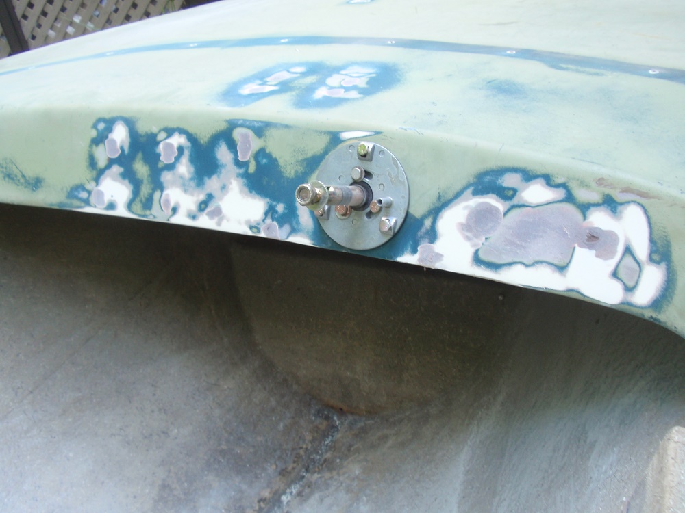

Go to your local auto supply store, Auto Zone etc and pick up a qt can of "body filler". It comes with a small tube of cream hardner. Clean up the hole like the others described, scoop up a golf ball size of the filler out of the can, squeeze out about 3/4" of hardner on top of that ball, mix it together and squish it into the hole, take the paddle that comes with the can of filler and spread it out evenly. It will set up in about 1/2 hour. take some sand paper and smooth the area down. After you do that you'll feel more comfortable using the product and be able to fix up some imperfections that are in your first attempt. Here are some pictures of holes I filled last week. These were holes from buttons and switches and gauges on an old dashboard. I grinded around the hole, put masking tape behind the large holes and laid in the filler.
The little smudeges of red is body filler "glazing putty" . comes in a tube that you can use your finger to fill in pit holes. no mixing needed.

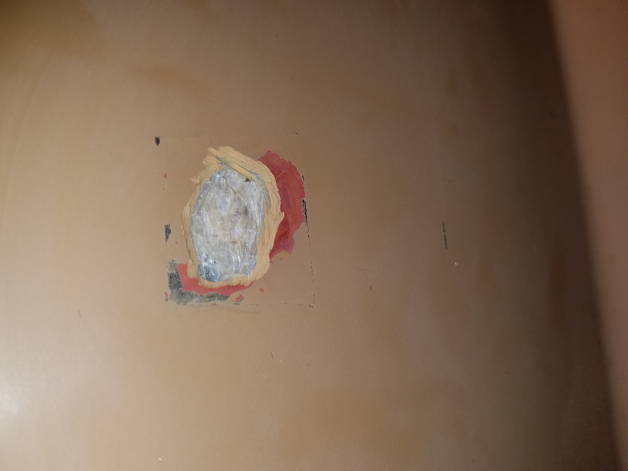

Made the repair yesterday with white marine tex. When i cut and ground away the gel, i could't really see any damaged fiberglass. It it was, it was very tiny. Might sand it some to smooth the corners and maybe a little paint or i might just let it as is. I got the 2oz kit which i had to mix the whole thing so i touched up some other areas. Too bad i had to use all of it at once but figuring out the 5:1 ratio would have been tough and messy. Thanks for the info.
