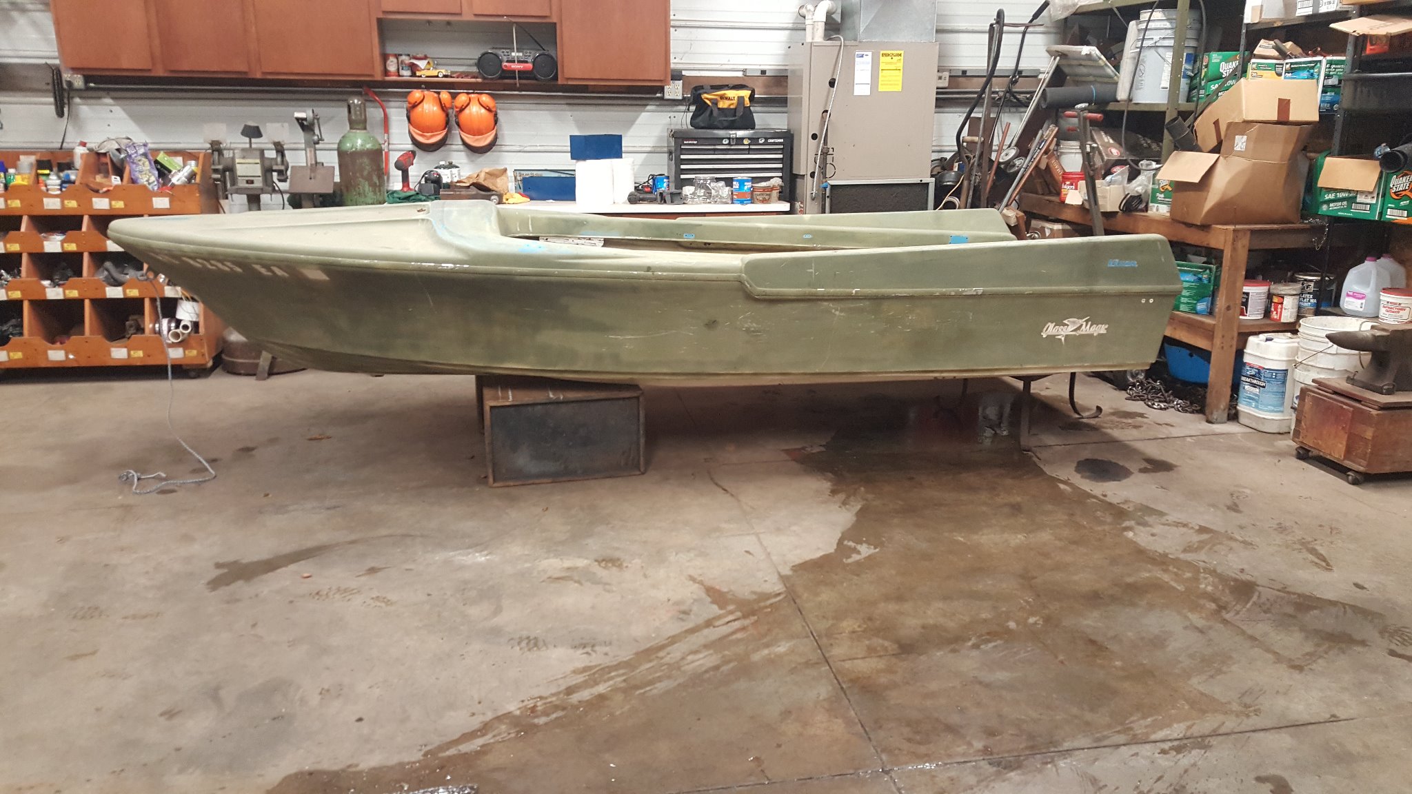

Picked up this solid Glass Magic and have it in the garage and not in the field. Somebody painted the entire thing camo (some peoples kids). Making good progress. Cheers.

Any reloadables in the bilge?
What did you use to remove the paint?
1960 Glass Magic Vixen..........duck boat? 8 years 1 month ago #137489
  • Nemo
  • Nemo's Avatar Topic Author
  • Posts: 16
  • Karma: 1
I tried a lot of things. acetone, oven cleaner, mineral spirits, heat, etc.. The only thing that works is sanding. Wet sand on the upper turned out ok.

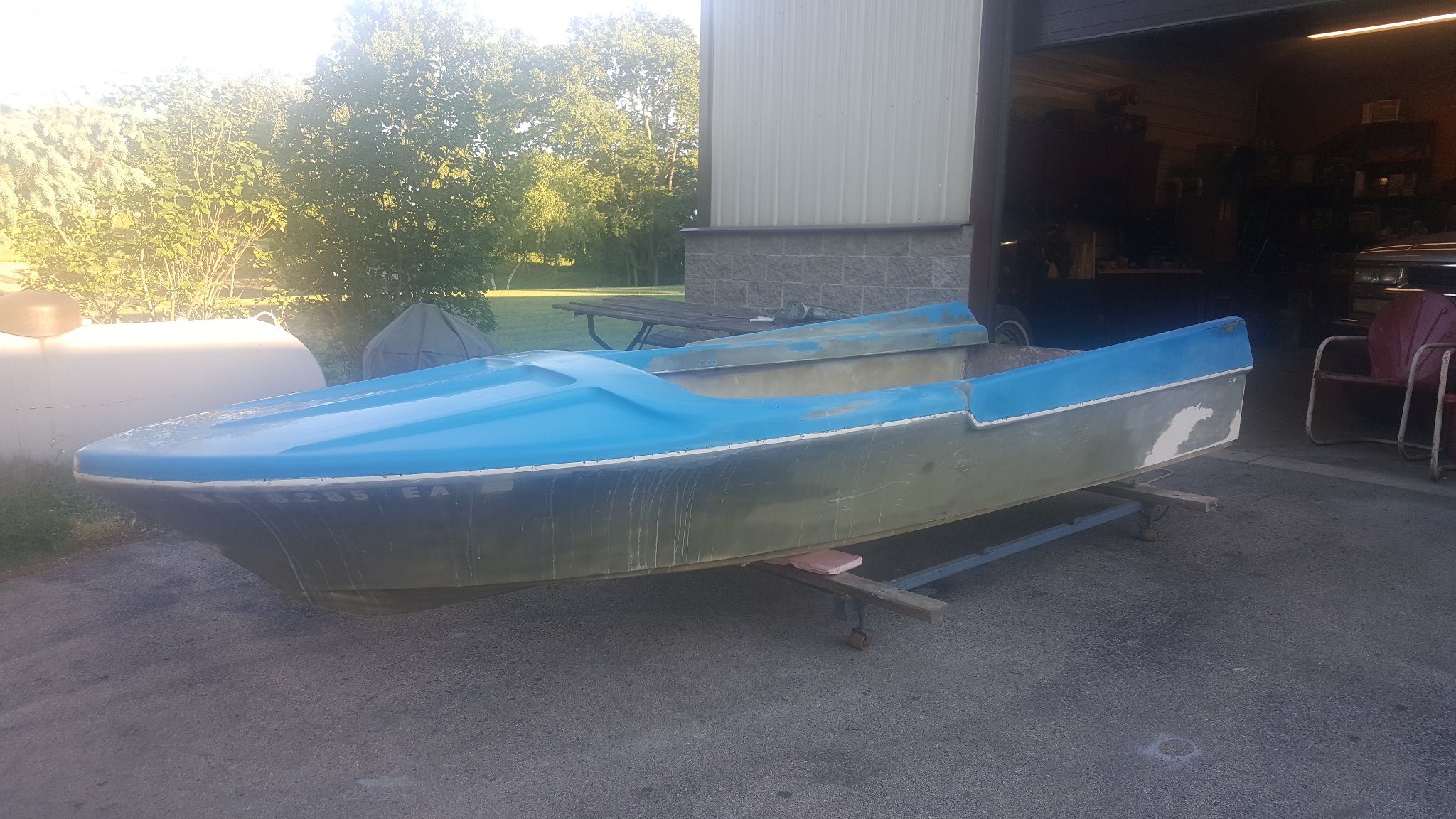

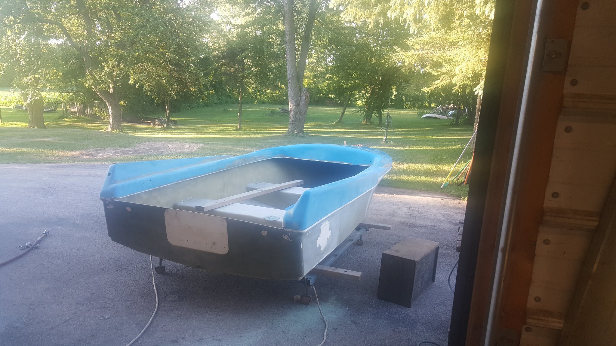

1960 Glass Magic Vixen..........duck boat? 8 years 1 month ago #137554

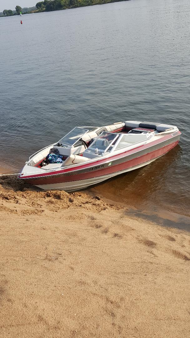

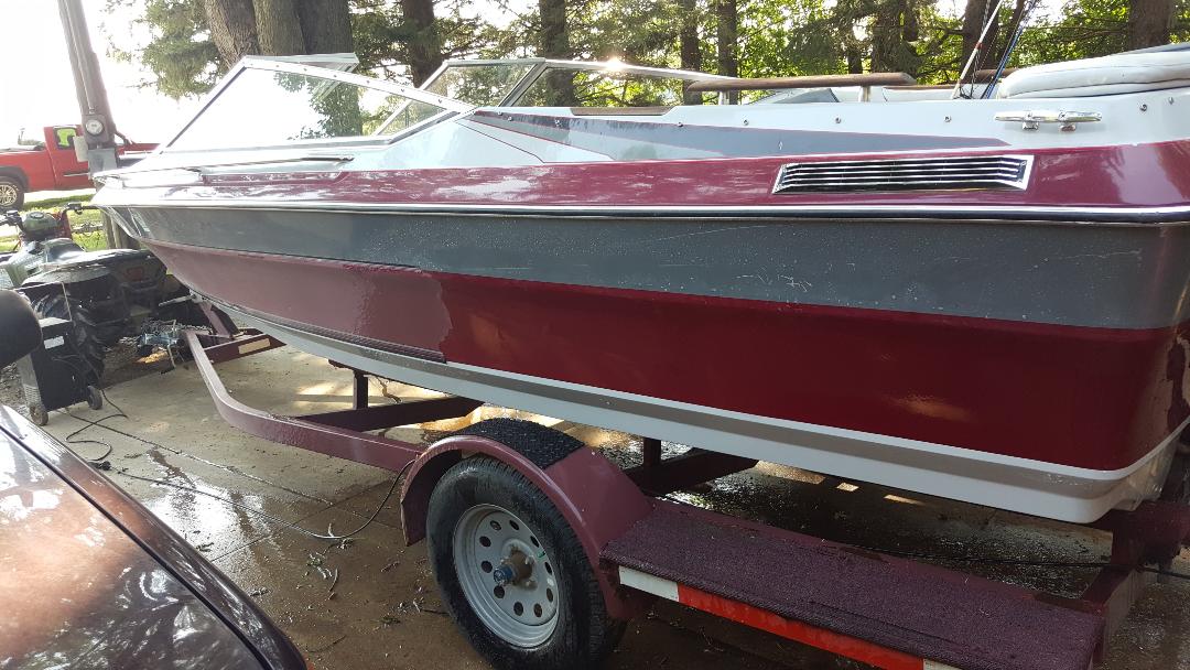

SO this is the boat that I was talking about, You can see the mid stripe was painted with red oxide epoxy primer. My son got to picking at it and found there was no sanding prep done. However on some spots there was as he got into it which made stripping it a challenge. Those spots were color sanded before buffing.
Here you can see it half stripped off with citristrip and its some work and you have to let it sit because its not all that aggressive compared to aviation stripper we use at the shop. It does not stain or hurt the gelcoat is the reason for using it.
Now that its stripped comes the Buffing and this one to start with was done with 3M super duty because it was not all that bad but it did leave some spots that will have to be color sanded and buffed with our new product line from Vengeance products. That stuff rocks and blows ppg and 3m in the weeds.
SO now we have the finished project ready to get final buffing and sealer coats. We will run new stripe lines when the polishing is completed. SO there ya have it guys Citristrip rocks. I have taken duck paint off a bunch of mercs and omcs to save the original paint and it works great. It will take off most paints that do not used catalysts, and even some that do depending on the quality of the paint. High end paint like PPG or DUpont are hard to strip, hardware store paint and brightsides fall right off.
