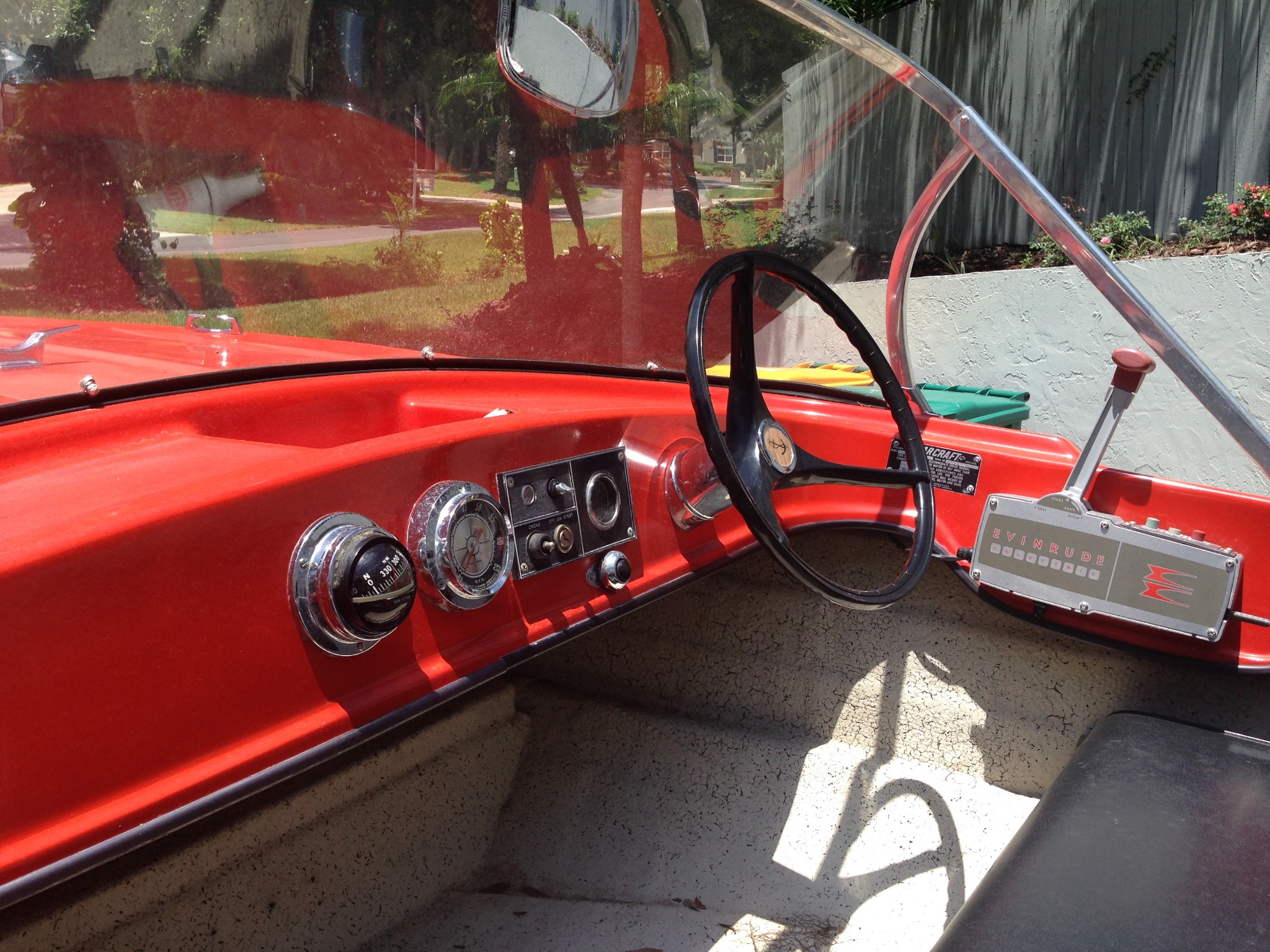

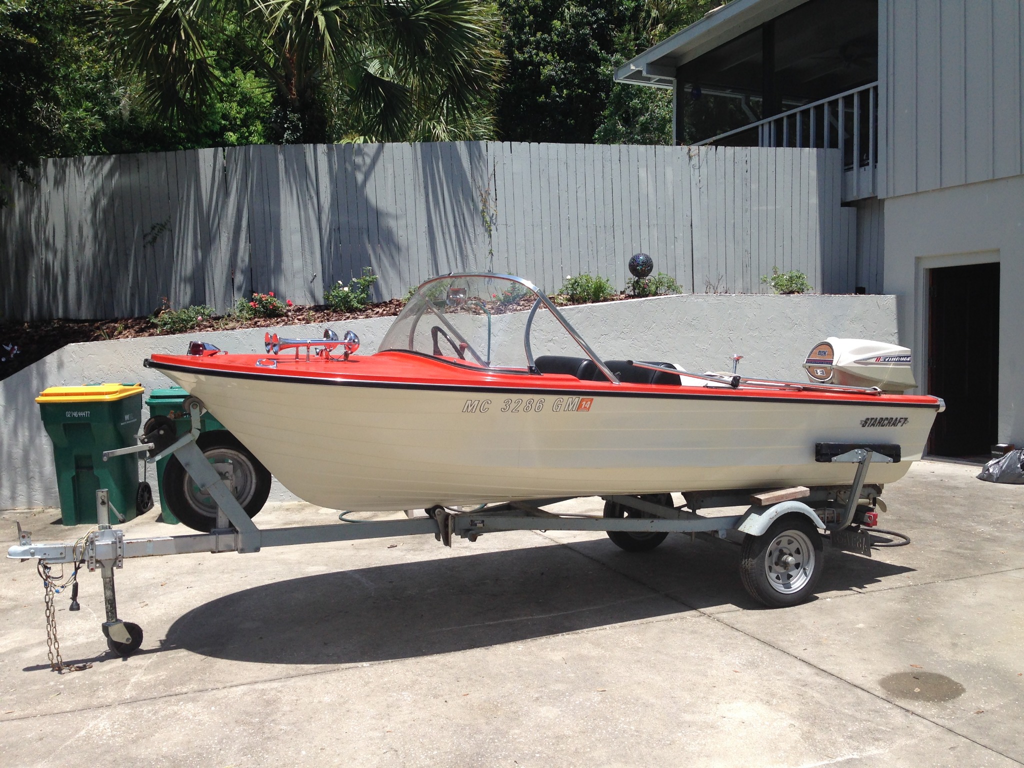

I just purchased a 1968 Starcraft "Arrow" with a 1968 40hp Evinrude from the original owner. It has been in storage for at least 30 years and in his garage for another 20. It hasn't been in the water no more than 12 to 15 times with 30 to 50 hours of total running time. It is all original and in fine shape and I would like to leave it that way. My only problem is that I have the boat in Florida where it is hot and the the original upholstery is black and impossible to sit on. Would changing the upholstery to a light color that was offered by Starcraft during that time have an effect on the value (not that it is worth much) or should I just have a seat cover made and leave as is.
