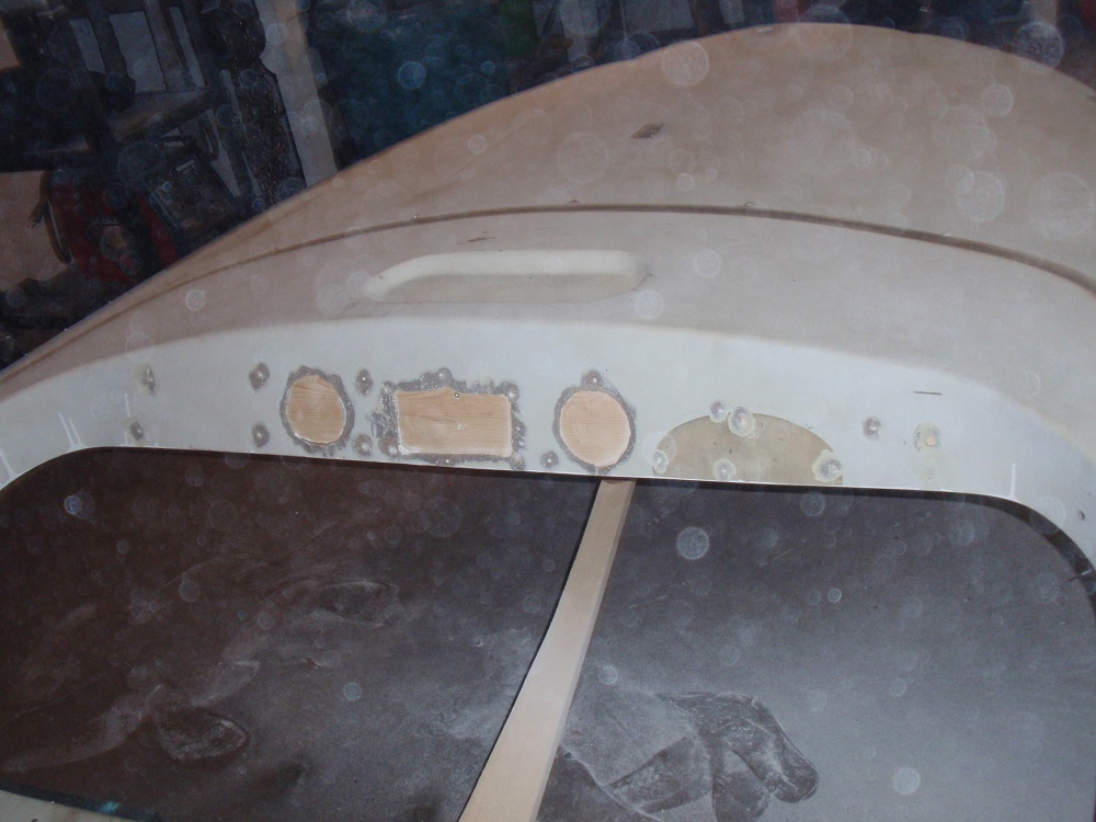

Welcome aboard. Filling those holes are easy peasy. Here's what I do. Put a small patch of glass matt or cloth on the back side of the hole. Feather the outside of the hole on the outside, if you don't do the feathering that dang hole will show up like a bad penny. Then fill the hole with your favorite filler, Bondo type stuff, finish it off with auto body putty that comes in a tube then you can blend the entire area when you finish off the rest of the boat.

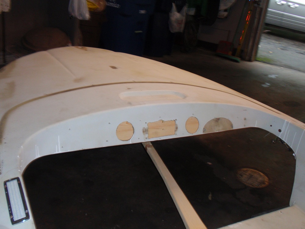

The larger holes in these photos were backed up with a complete new board behind the dash so don't get mislead.
