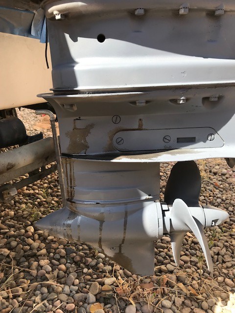

I posted earlier in the JEGO forum and was told it was the drive shaft seal. One thing I noticed. it did not leak when in the down position. I tilted the motor up, still no leaks. As soon as I put the motor in the down position, big leak. Would it still be the drive shaft seal or something else along with the drive shaft seal? The leak is coming from the two small weep holes.

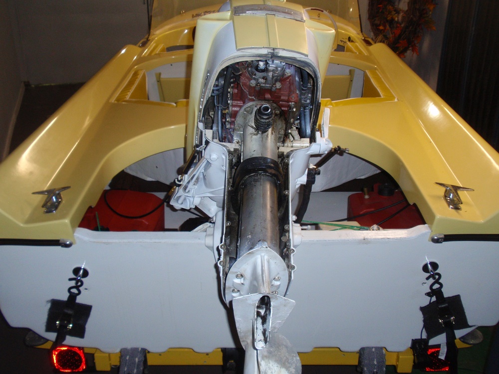

Just to help you understand somewhat clearer I snapped this while I was changing my water cooling impeller. As you can see with the cover off all the open area that actually fills with water while your motor is in working. All that gunk that builds up in there also drains out after you take the boat out of the water.
