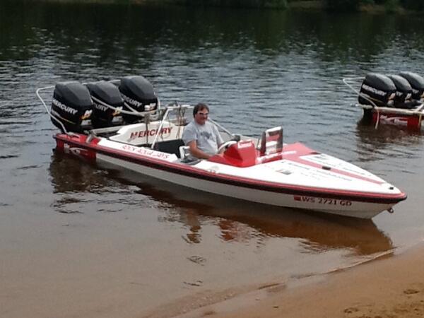

Very interesting information. My understanding is that a modern Outboard boat of 20 feet in length or more is plated for unlimited HP. This must be so because I see 20 foot ski show boats with 3 - 300hp outboards on back. Wonder how all that came about?

No. Because the US govt doesn't regulate inboard boat horsepower. And Hp regulations only apply to monohull O/B boats under 20 feet in length. So yes you can hang whatever you want on your 20 foot or longer boat. However. boat manufacturers usually make HP recommendations for o/b boats up to about 26 feet. But they are recommendations. They are based on testing of the boat to see how it performs with different sized engines.
So if you want 3 100HP engines on your 20 foot ski boat, and the weight doesn't sink the boat, well go for it. I hope your insurance covers it.
