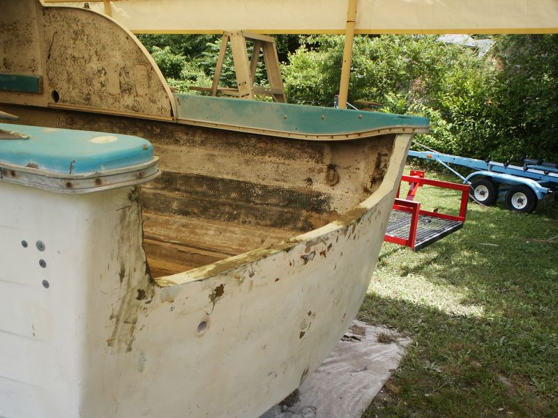

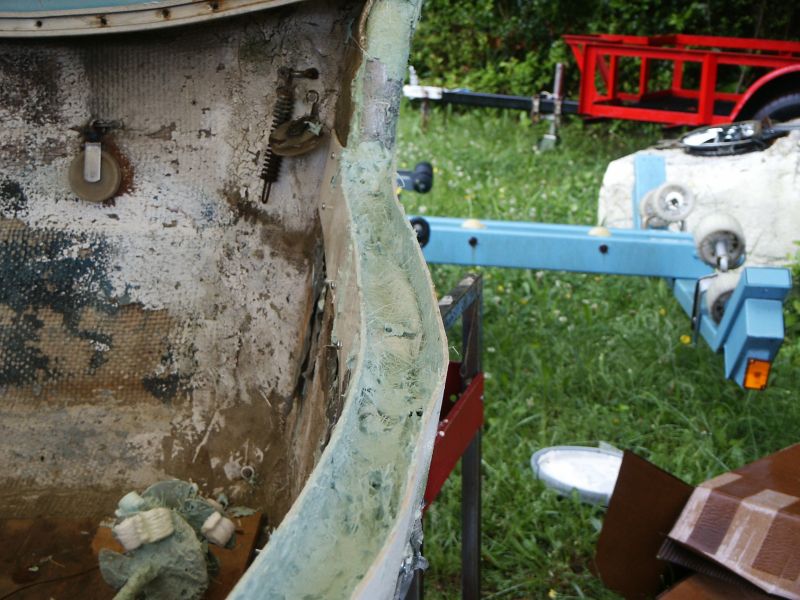

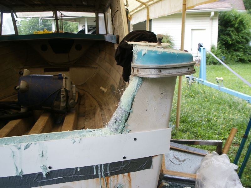

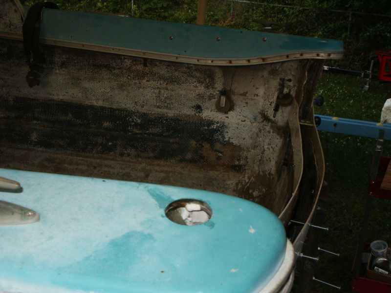

Has anyone worked with a pourable compound to fill the space where removed rotten wood leaves a hollow between the inner and outer fiberglass walls? I see Seacast on youtube, and now this Arjay pourable ceramic polyester compound, with exothermic temperature control. It doesn't get so hot that it cracks, it is light weight, $50/gal which would fill a 30x24x1.5 in cavity... the website says it is used extensively to restore plywood transoms . .. Anybody have any experience with this stuff?

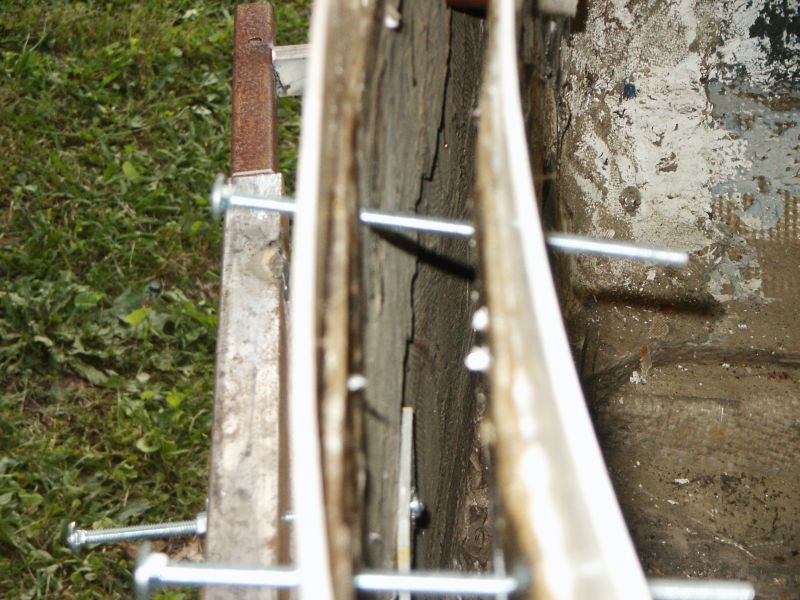

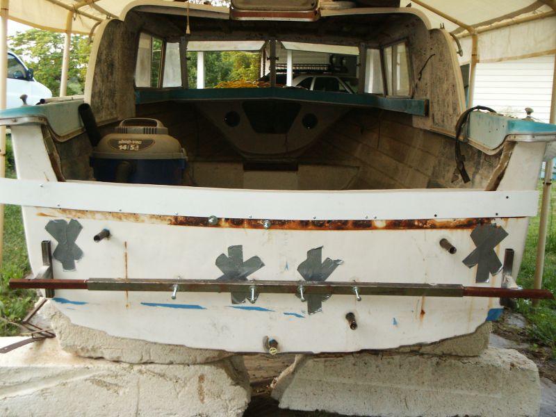

I did a transom on a 20' Lema center console with Seacast. I had to brace the inner and outer skins 'cause the stuff expands as it cures. Expensive and a PIA to use. Never again...
