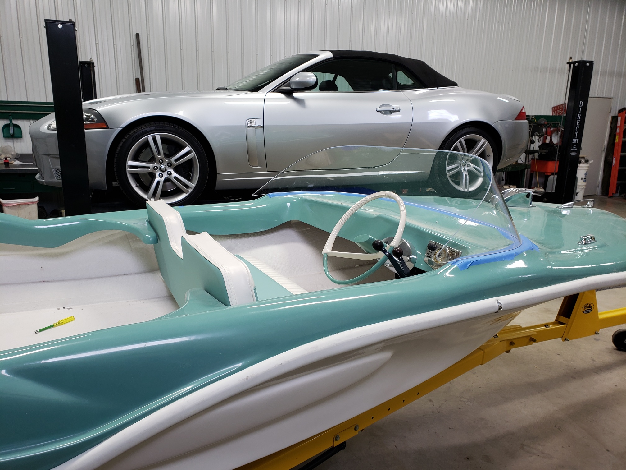

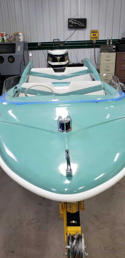

I am restoring a 1959 Redfish Shark. I needed a new windshield so I decided to make one out of 1/4 inch plexiglass. They were heat formed them in a really large oven so they hold their shape properly. I attached a picture of the windshield on my boat. Since I'm all tooled up to produce Redfish windshields, is anyone else out there interested in a windshield?

It's 12 inches tall but I'll have to get the width and length dimensions and get back to you. It is at least 4 inches shorter than the original style but I thought the original style was too ugly so I went shorter and more raked back. I attached a side view for further reference. The ends haven't been finished yet in the picture.
Redfish Shark Windshield 8 years 6 months ago #135794
Windshields are not a one size fits all. Not only the distance end to end but that __(&^E%% hump on the bow is a pain. Just sayin'.

Rocketman: My windshield is 57 inches wide. It probably wouldn't work for your boat but the hard part to describe is the curve of the bottom of the windshield and the crown of the bow. If you think the windshield might fit, I would be willing to send you a paper template of the bottom edge of the windshield so you could get an idea of its curve but I don't know how I would accurately describe the crown of the bow. Mine is almost flat, with only a rise of less than 1/2 inch in the middle. Let me know if you would want a template.
