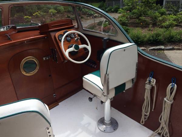

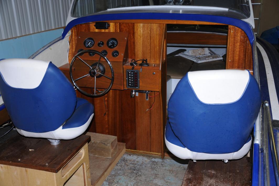

Thanks for your response. I have several cuddy's, a Catalina, a San Juan, a Farallon, Club Mariner, Bell Boy Express, and a Wizard.
I think the wood bulkheads give an added touch of class to an already classy boat, just like the high end sailboats that have nice mahogany interiors. Here are some photos that I got online that sort of show what I'm after.

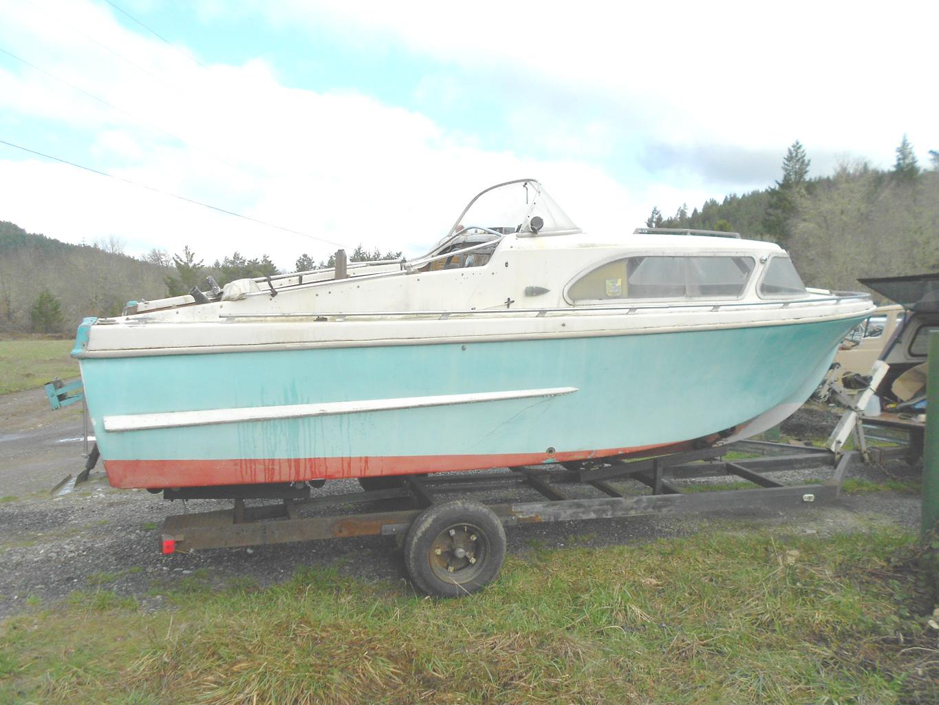

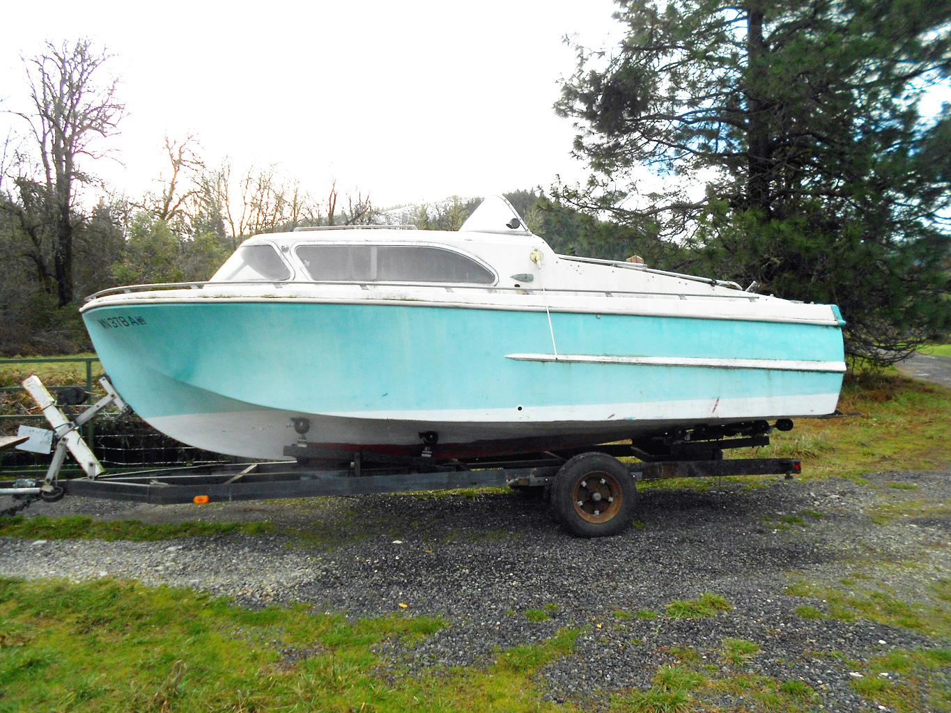

I love the cuddy cruisers.
Are they all functional or in process? Can you post a picture of the Farallon? I have been on the watch for one. The wife would not be happy but it might be worth the fight.
Wood Bulkhead in Fiberglass hull 8 years 8 months ago #135514

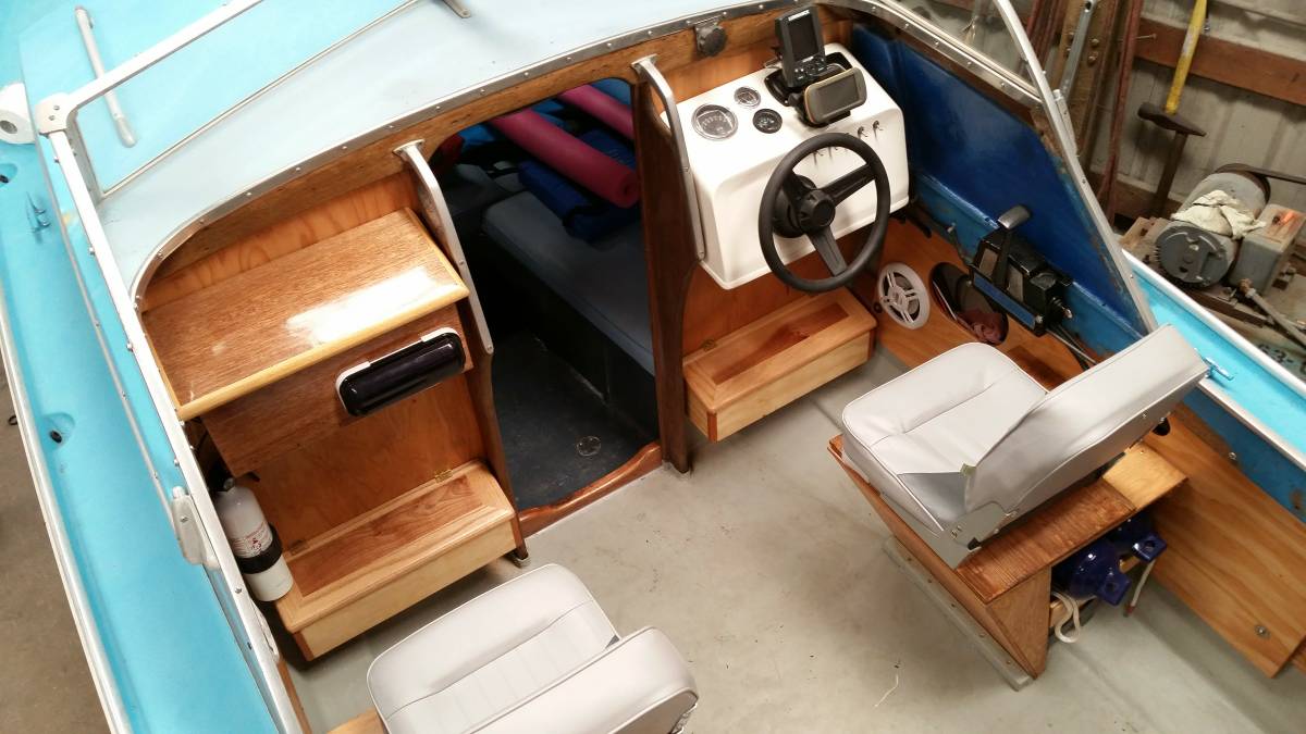

The photo above is exactly why I am sort of a procrastinator instead of a jump in and do it sort of guy. It usually takes a lot longer to fix the screw up then it does to do it right the first time...
Are all of my boats functional? Well I guess if the purpose of a boat is to float, then I'd have to say they are. LOL But they do all need complete restoration. I love the late 1950's and early 60's cuddy's and now they are at rock bottom prices and are being scrapped. I am trying to save some of them and have amassed a small collection. I can restore them in the future but may not be able to buy them in 5 or 10 years. Here is my Farallon. I drove 350 miles to Tacoma to buy it and had to install an axle on the trailer besides. But I've only seen 2 Farallons for sale in the last 15 years. And strangely enough, one just showed up near me, along with a Catalina. They are wrecks but the old lady wanted $2000 for the pair. The Farallon has two 90 HP Johnson's hanging on the back- I'm sure they would take the transom with it. I'm waiting for her to come to her senses and accept a reasonable offer.

Ahhhh...the old "drywall screws through the bottom" approach. Very interesting but not as much as the "cut out the flooring with a Skil saw set at full depth" method.

Great thread offering options for success. I must say that I had to pass on a boat with a Merc 85xs because it had 2 layers of rotten floor and then they screwed the new seating right through both and out the bottom with lots of screws like Cal showed. Too much work for the dime a dozen 70’s square nose open bow when I could find a nicely kept example for same price. The good options here are what makes this site valuable to me, so thanks all.
