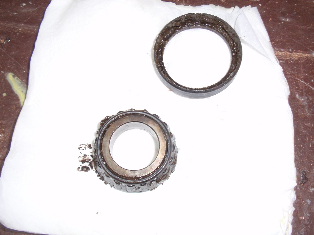

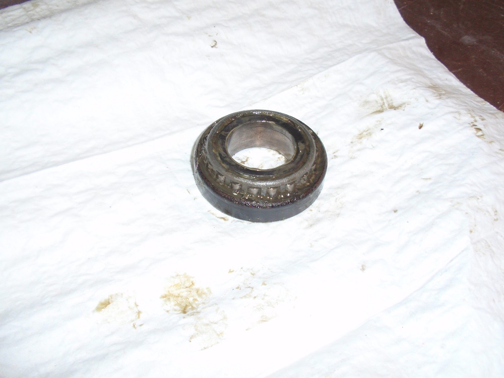

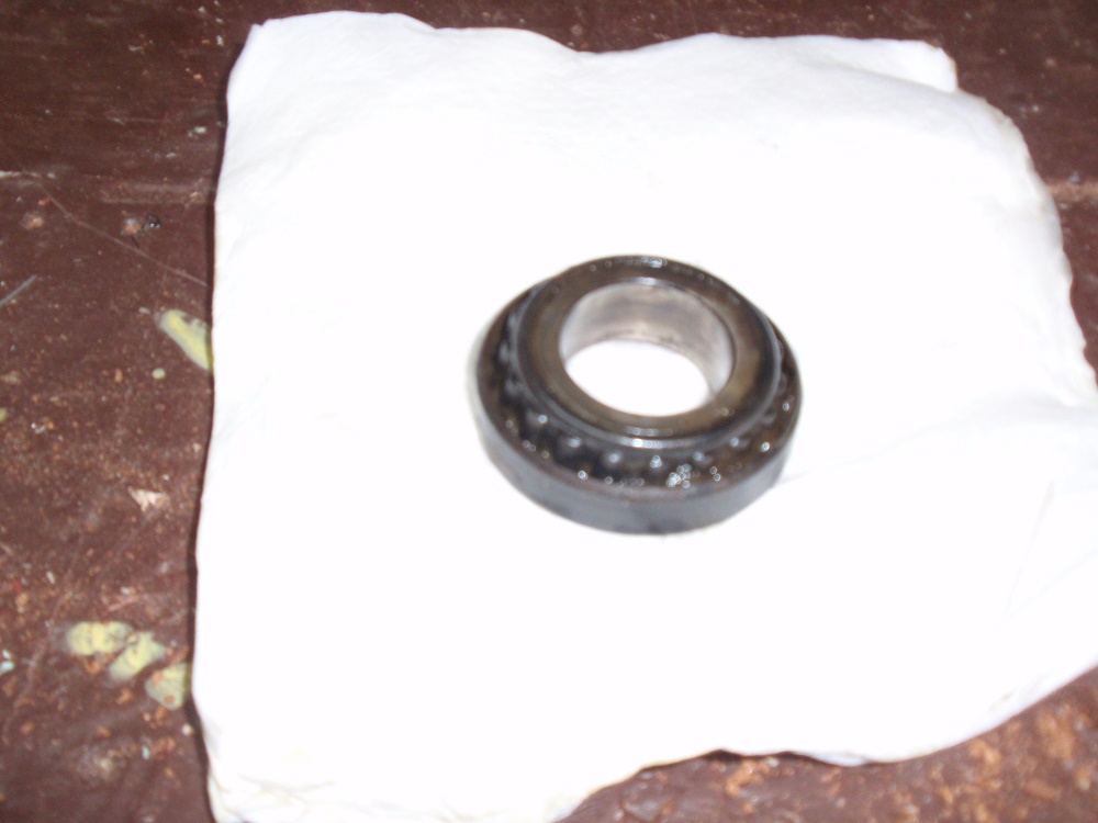

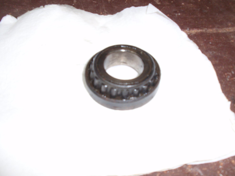

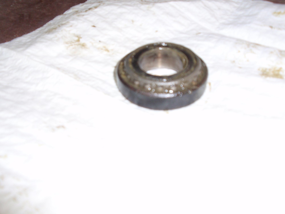

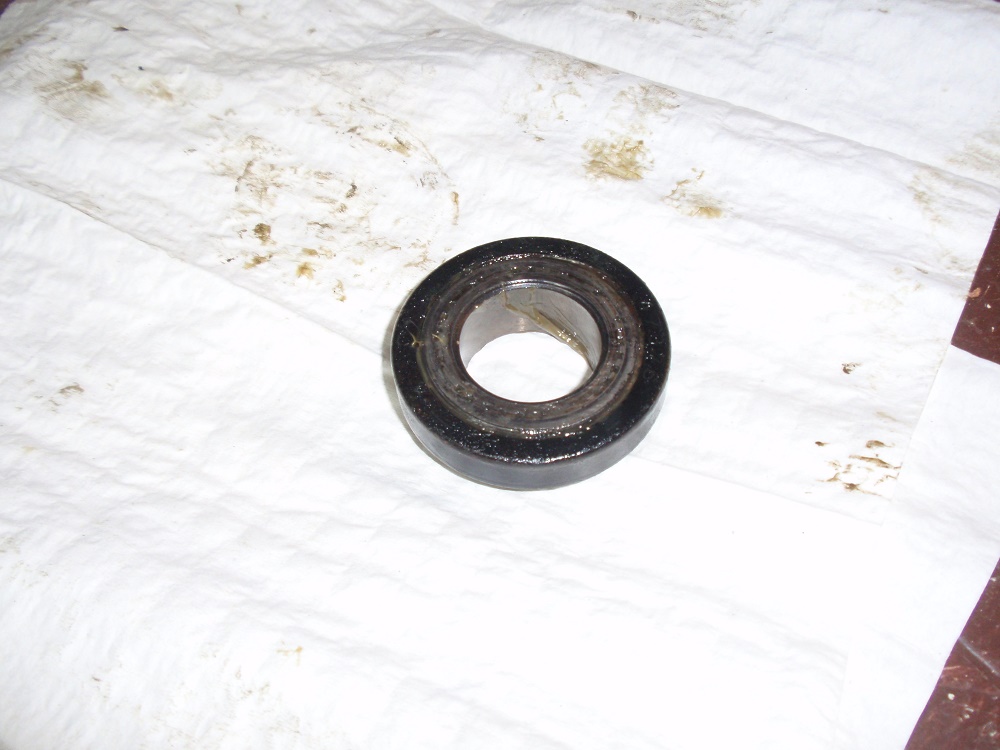

I'm taking a breather from the hustle and bustle and decided to repack the wheel bearings on the trailer I bought last Aug. Looks like the PO either put the wrong bearings in on old races or he preloaded hard enough to push the bearing through the race and into the rear seal. There's a reason to drive 65 miles on back roads at slow speeds when picking up one of these puppies.

I'm going to replace both wheel sets, front and rear. Might be less expensive just to replace both hubs.
All my years I've never seen this before.
Can't imagine what would have happened in your situation pulling down to sunny FL at highway speeds.

Went to O'Reilly this AM and picked up two complete sets of correct bearings. $37. Now just to get the races punched in. I think I have a socket that will fit the bill.
