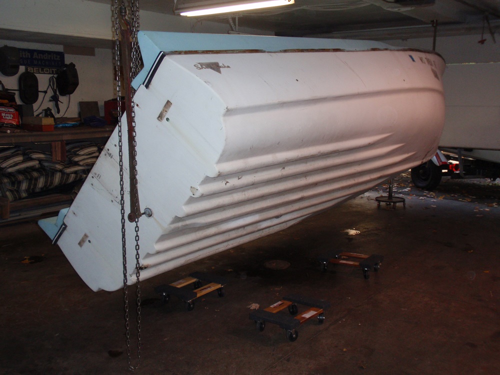

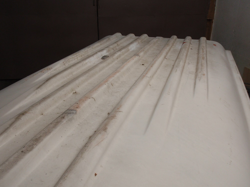

It would be next to impossible to do any keel repair from the inside on this model. The deck, bow, seat and stern flotation all would have to be cut out. That being said I think you have the right idea of flipping and just grinding off the bottom of the keel. Leave the sides of the keel intact. I've never had to do this but you should be able to dig out any gunk to be replaced. Use the new materials and then fill any voids with resin and then put about 7 layers of glass cloth and mat alternated to build it back up.

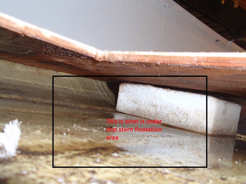

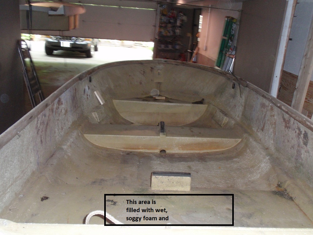

OH ya.... take the windshield, motor and any bling that would break off before you flip it. I can guarantee that the stern flotation area is filled with wet soggy foam. Cut an access hole from above and just pull the stuff out. I cut a square out (it's 3/8" plywood) that when I dried everything out I replace the square with hinges and use the area for storage.
