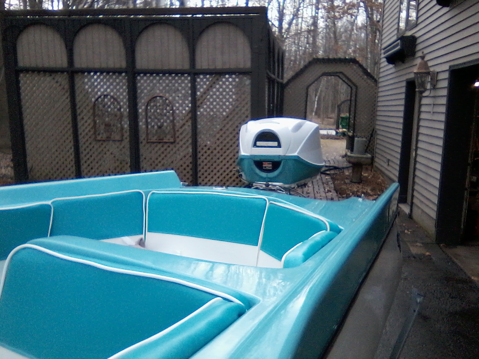

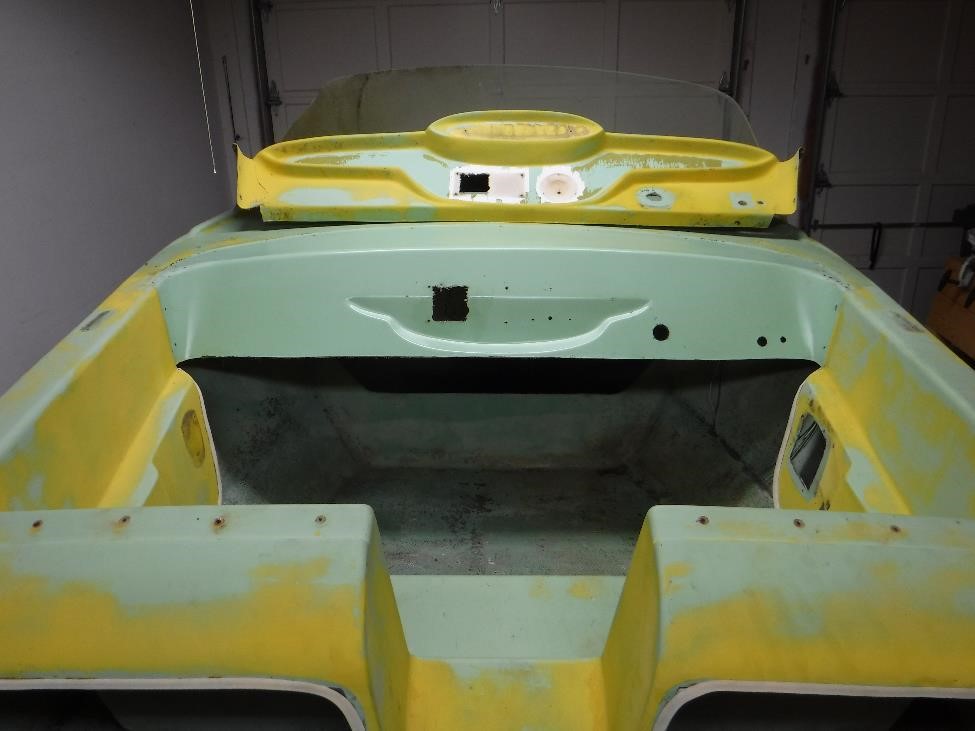

I've had very good luck with the Rustoleum brand. It does come in the basic colors but with those you can mix up a rainbow since they come in gallons, quarts and pints. For the roll and tip I use just a smidgen of thinner and hardner. This is just for the hull. For the topsides I spray thinned and hardner and then sand with 2000 grit and polish with McQuires ultimate polish. These two pictures are of two 1960 Shell Lake Rockets both with Rustoleum. The "blue" one was a mix of mostly white, a little dark blue and some of the green. You can just keep adding a few drips at a time until you get the color you want. The yellow Rocket I wanted to get close to factory so I just reduced the basic yellow with lots of white which came out a brighter yellow. Again with hardner. The chemical hardner will thin a little also so keep that in mind. Spraying will need at least five coats since you will be sanding and polishing...you don't want to rub through to the primer. Don't ask how I know. A 15' boat will take approx two quarts thinned. This will leave enough for touch up when needed. Only mix the hardner into the paint that you are going to use within the pot life because it will not store. Turns to thick jelly.
