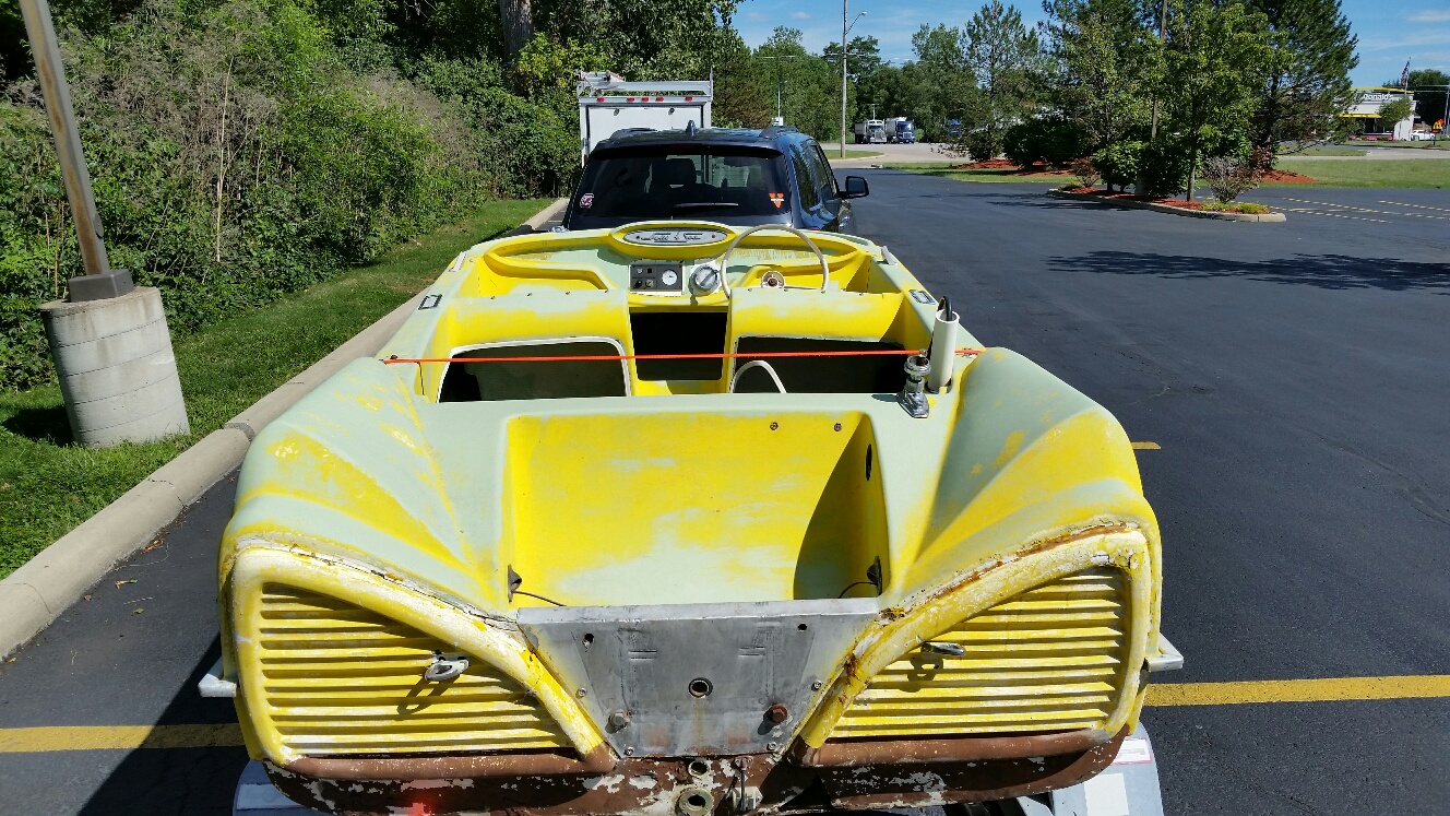

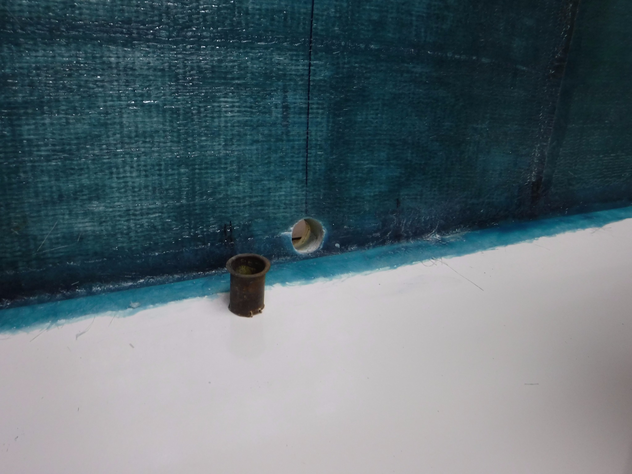

While I eliminated the sub floor drain, the main floor drain and the engine compartment drain will remain. Picture below. Once the woven roving was installed the height was perfect for the drain. If you send me your email in this thread or by PM, I will forward you the feedback I received from a contributor here on Fiberglassics regarding the foam and his test results while in the USCG.

Ok. So if I understand correctly, that new drain is higher (and now just above the new floor)...and the sub floor is basically sealed from water intrusion - correct? And even if water tried to find its way under there, there is basically no voids nor anything that would allow water absorption anyway - correct again? I will send you a PM and thanks again.

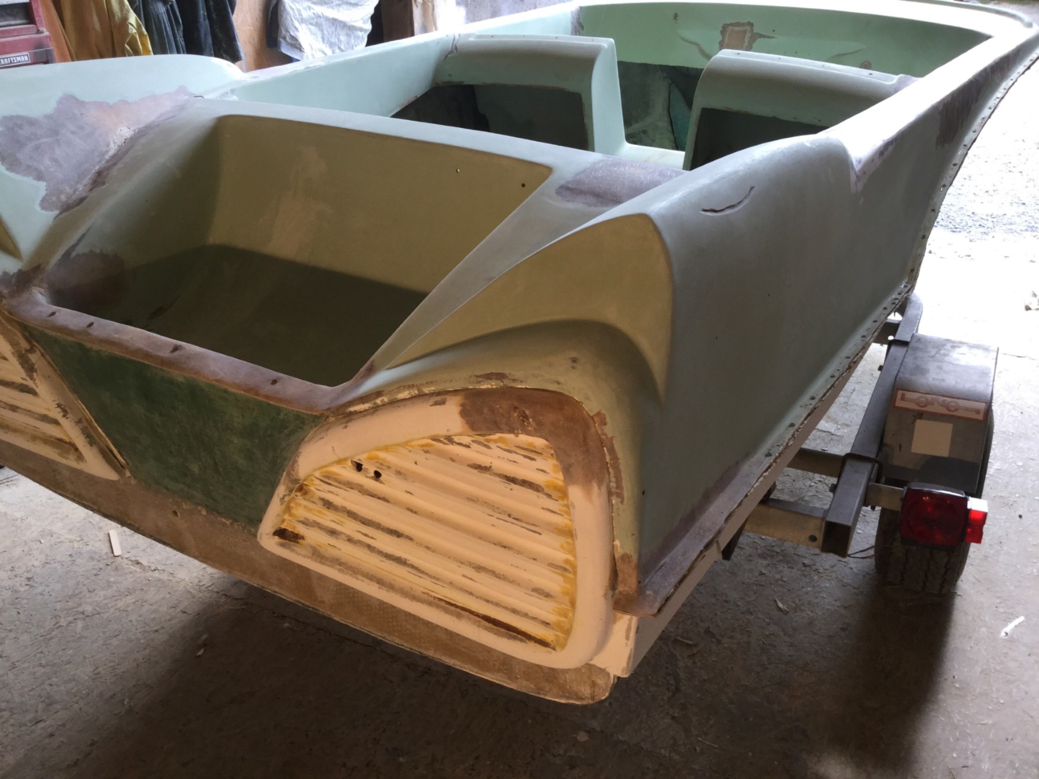

My Caribbean had 3 drains, see picture of original stern. 1-sub floor, 2-main floor & 3-engine compartment. I just eliminated the sub floor drain. The new floor is tabbed in with 2" and 4" chop strand tape and then woven roving. I do not plan to put any screws through the composite floor, rather use 4200 or 5200 to adhere components if needed. Time will tell, that might change. There will be some condensation in the sub floor air, that should me minimal. The bow and stern eyes are above the water line so no sub floor drips from those. My boat will probably not be in the water for more than 3-4 days at a clip at a show. At home we will use a lift or the trailer for daily use. The plastic was just more insurance as suggested by the gentleman that ran the tests for the USCG.

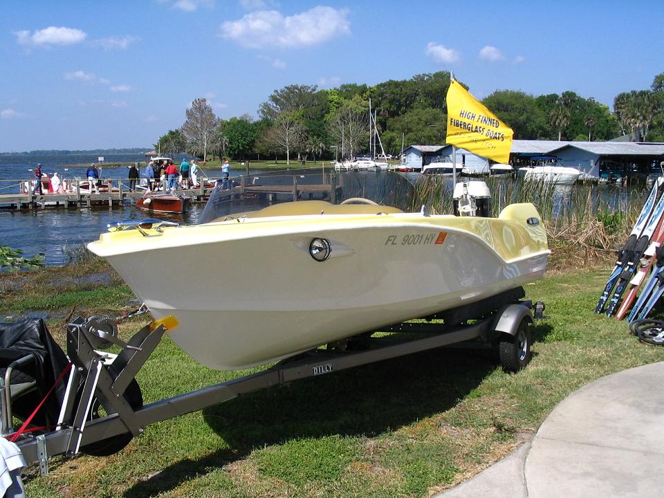

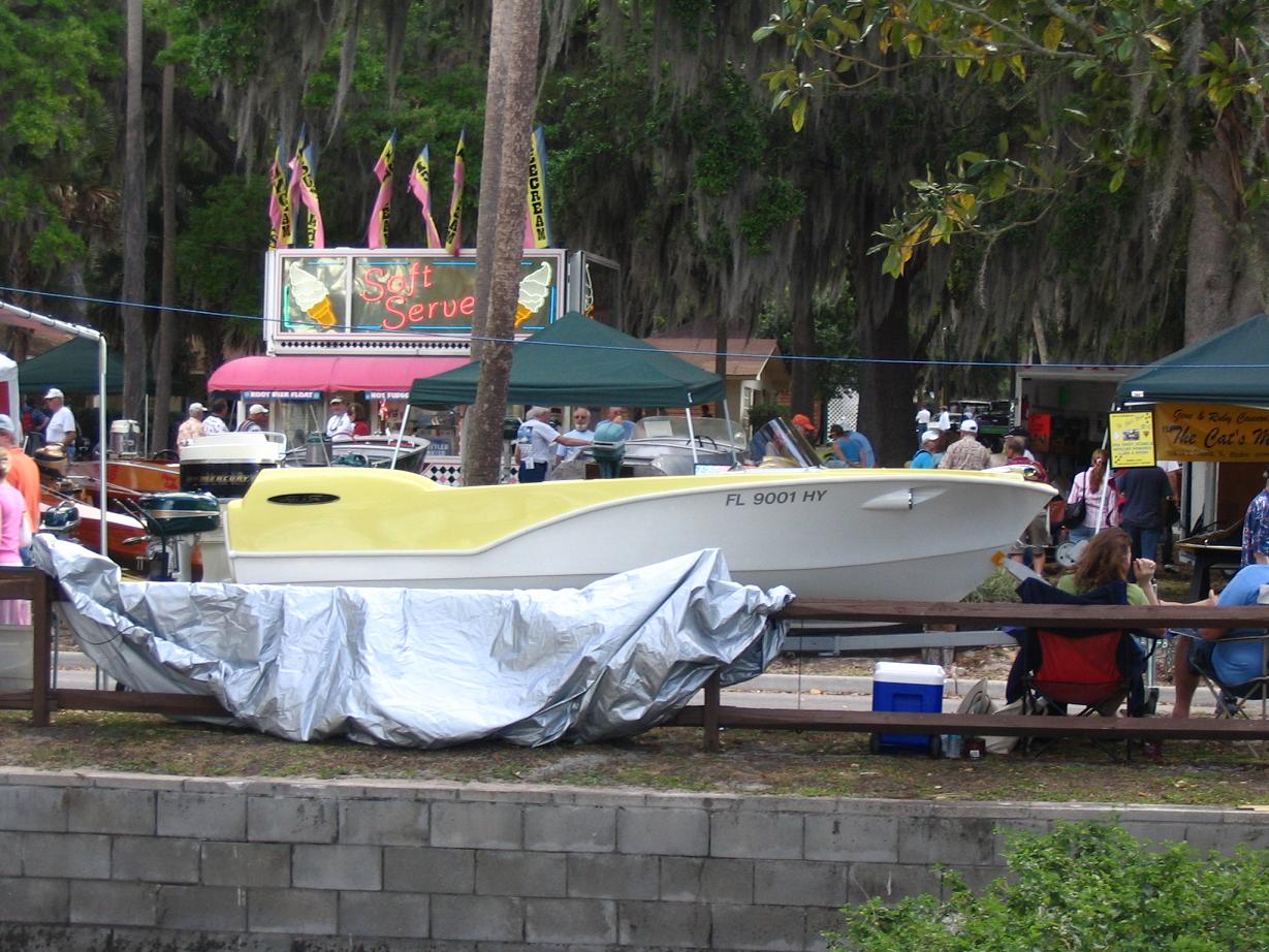

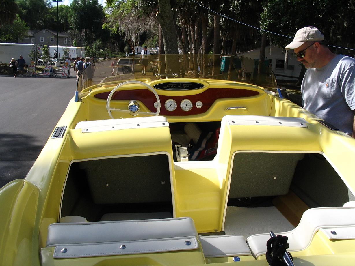

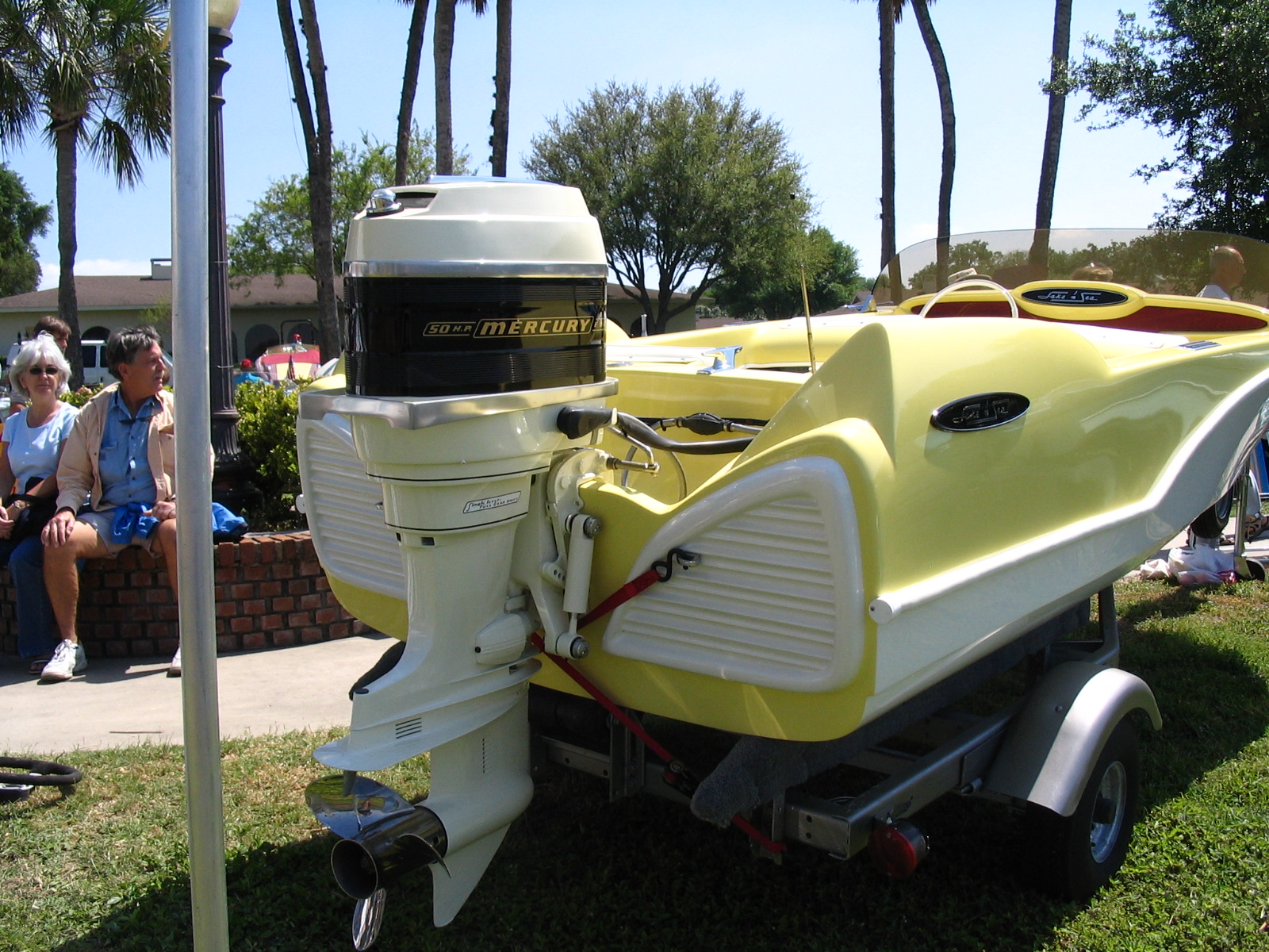

PICS OF A LAKE N SEA THAT WE WERE NEXT TO IN MT.DORA 10 YRS AGO.....RON.......
Video Lake n Sea Restoration Part 1 8 years 10 months ago #134863
  • Eric Z
  • Eric Z's Avatar Topic Author
  • Posts: 237
  • Karma: 2
  • Thank you received: 19
Thanks, A breather hole / tube up under the covered bow or stern area would work,
Great pictures. Looks like this one has some custom lights inserted, aftermarket logo plate look good too.

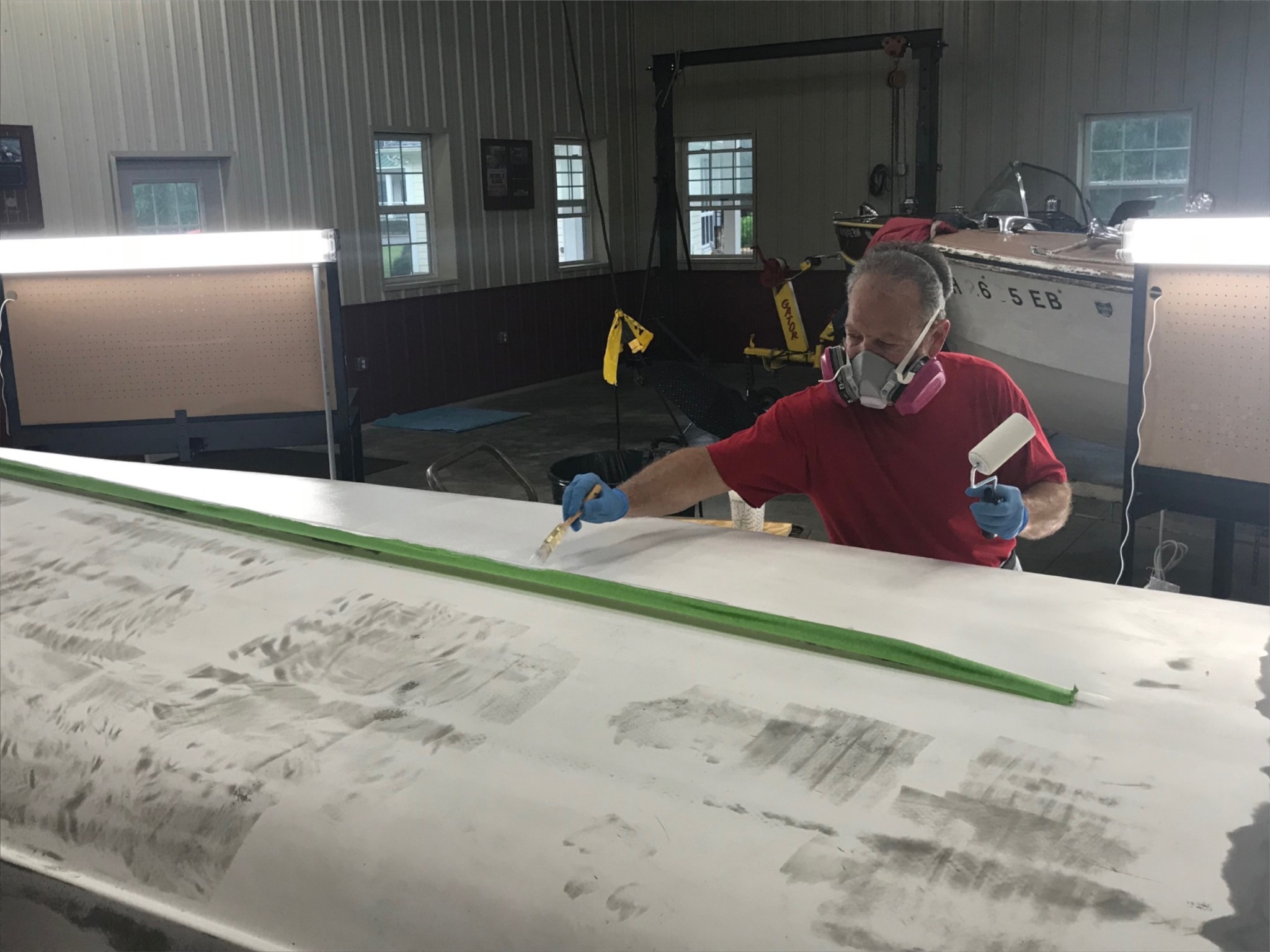

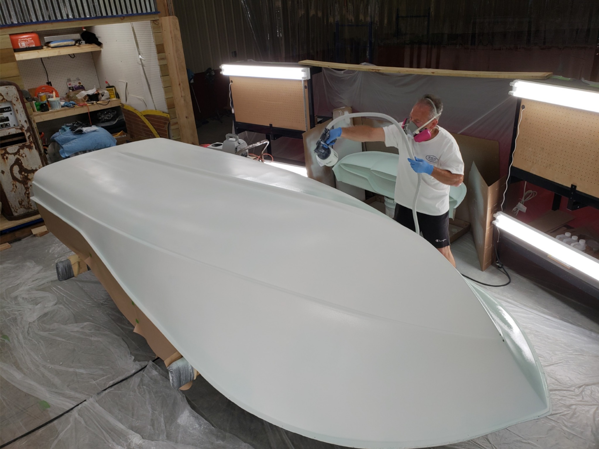

Video Lake n Sea Restoration Update 8 years 1 month ago #137439
  • Eric Z
  • Posts: 237
  • Karma: 2

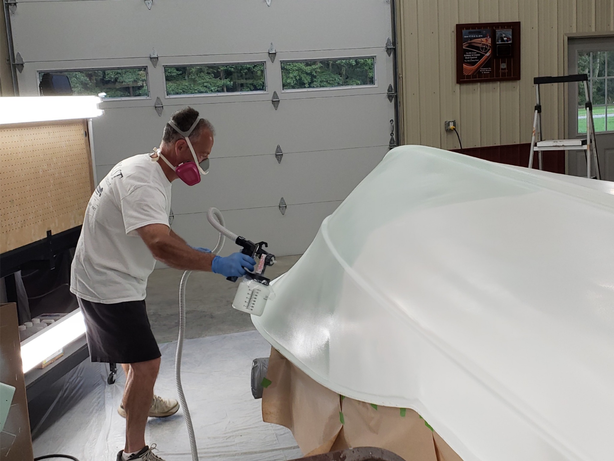

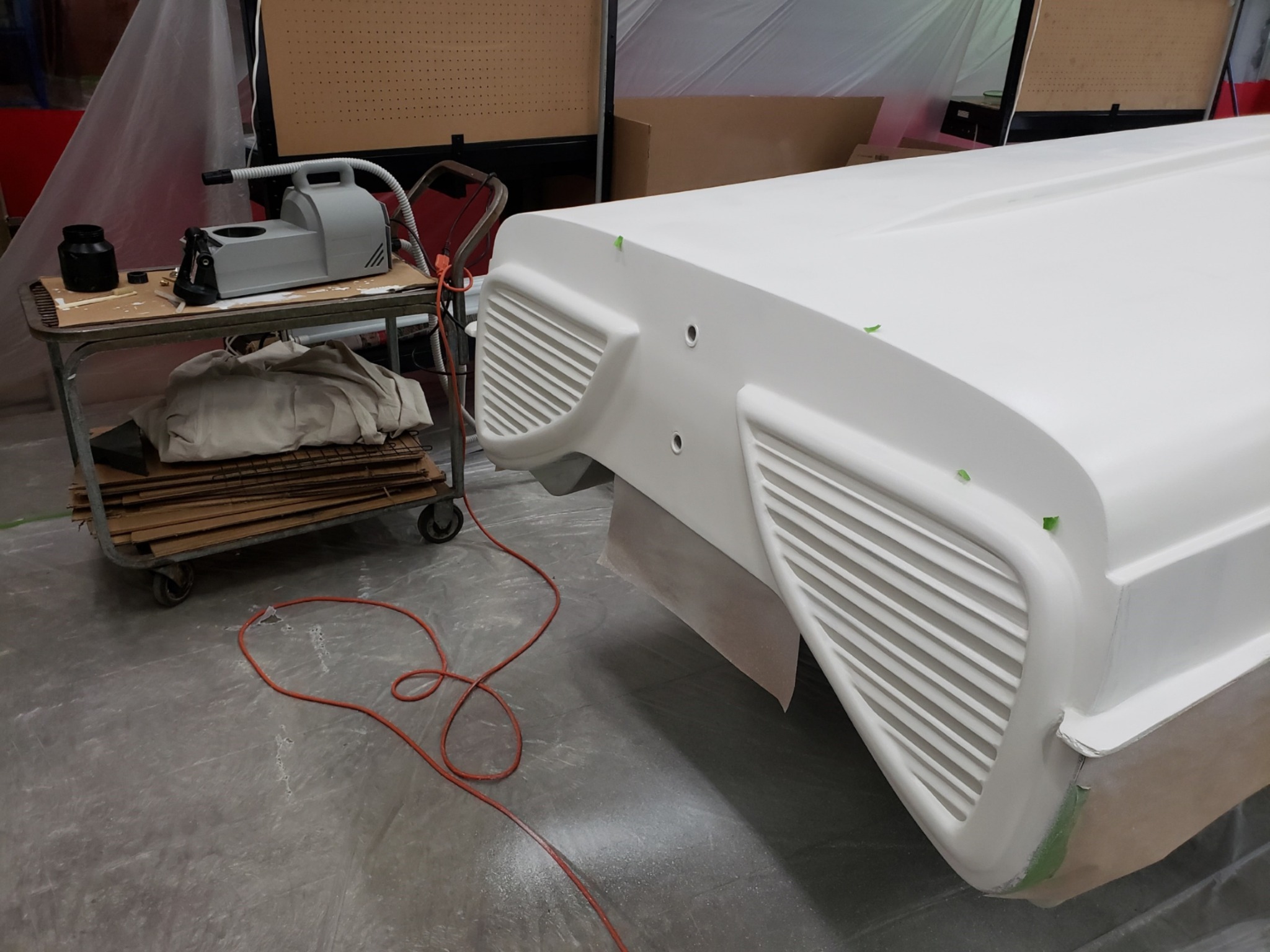

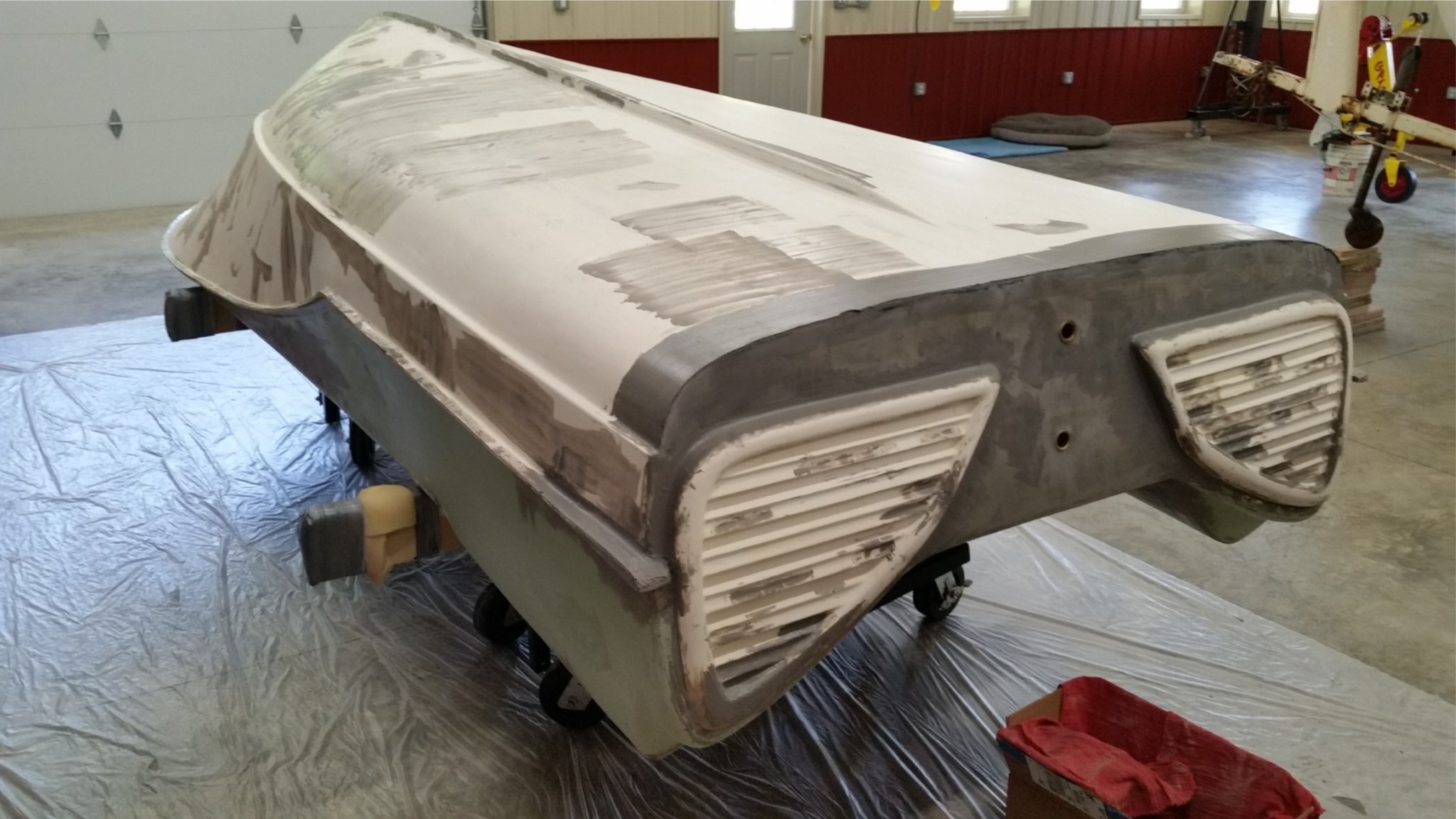

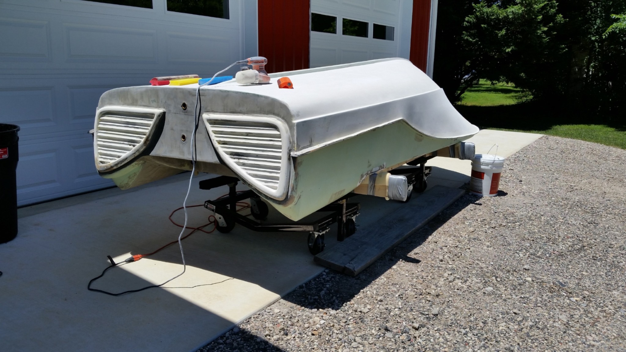

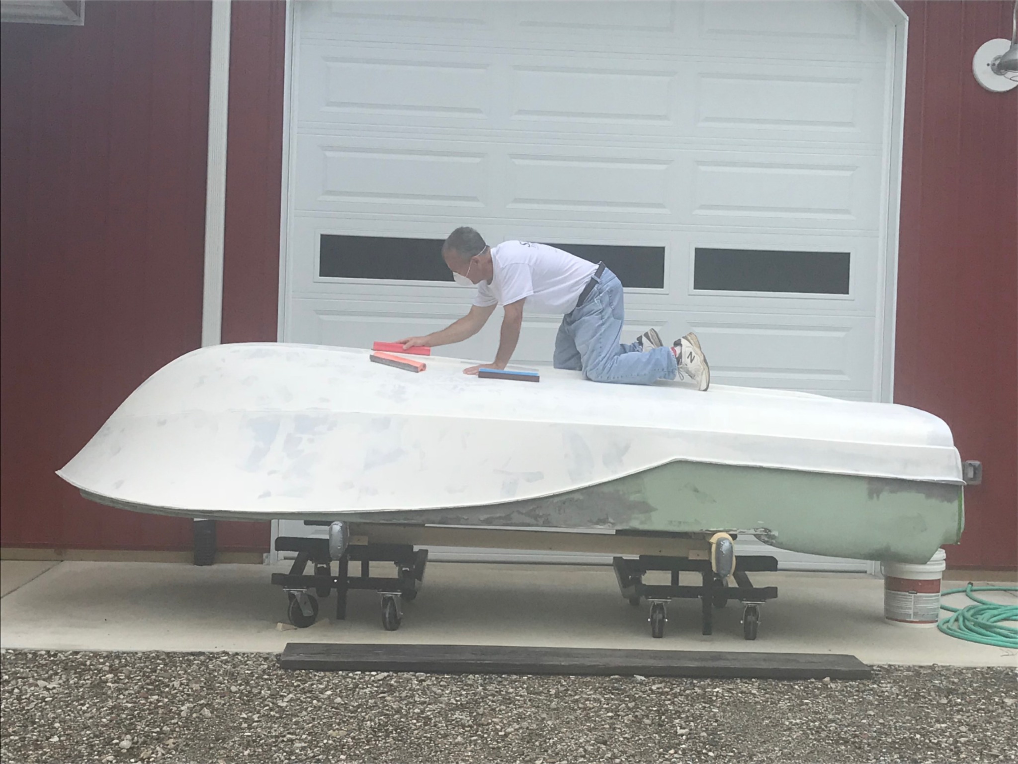

Restoration update, '62 - 14' Caribbean. Been working on it for 2 years on and off. Part 1 Video link above that was compiled last year and then the pictures skip to the current work on the bottom after the top was replaced and gel coat grinding was done. When I get time this fall, I'll pull together a Part 2 video . The restoration started in the garage, then last summer I built a new boat barn workshop. Started priming the bottom via roll & tip, then decided to try the harbor freight cheap turbine HVLP. Definitely a learning curve to thin the primer and dial in the gun. Hope to sand the last coat and start applying interlux perfection this weekend. BTW, there is a new Lake n Sea Facebook group started by Geoff Reynolds.
