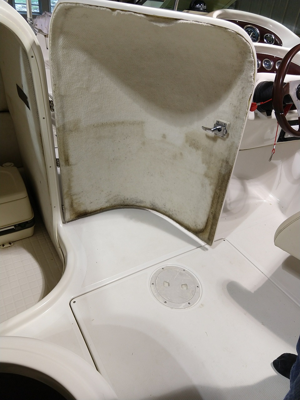

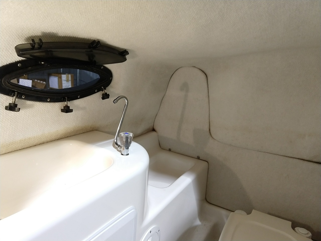

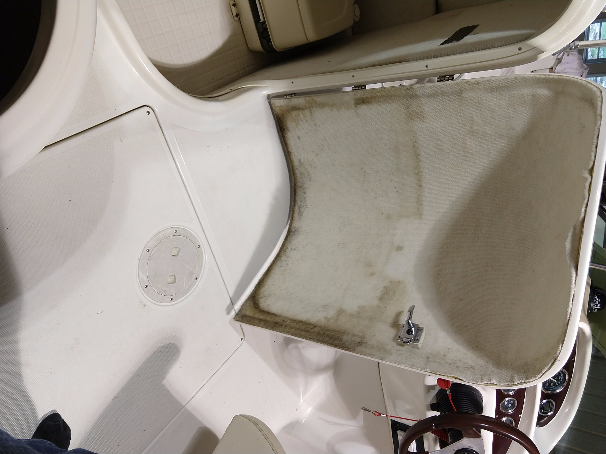

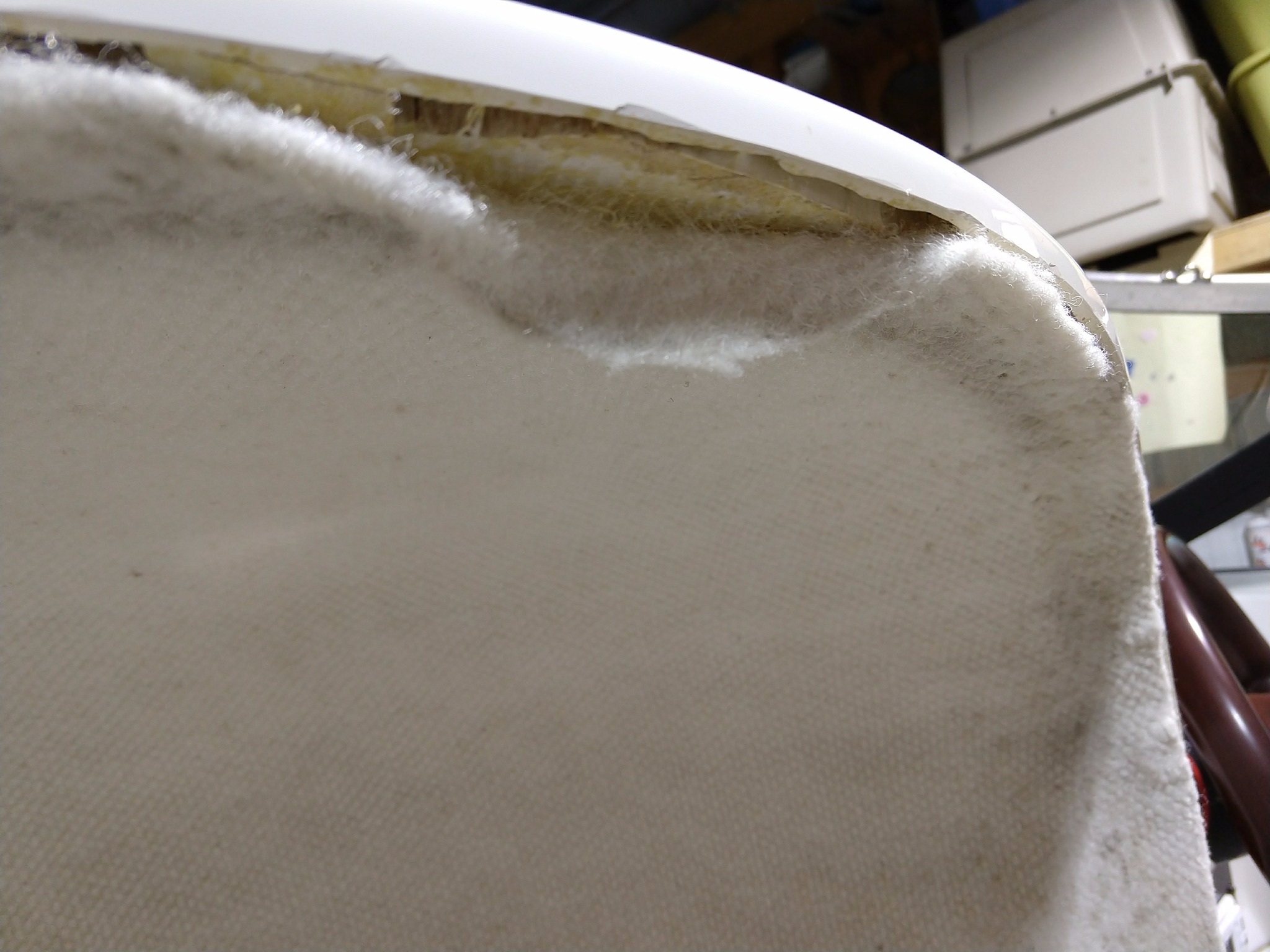

The white carpet in this head is filthy. Also, the ceiling is sagging. So my plan it to remove the carpet and see what I get in to. Any ideas what I could use instead of carpet on the walls and ceiling? If you look at the pic of the door you'll notice that under the carpet there is most likely unfinished glass.
Options that come to mind are:
  1. new carpet and sound backing
  2. skim coat or smooth the surface
  3. us a thick textured paint
Any other Ideas?
