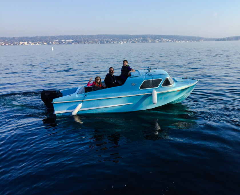

I just picked up a great ‘60 Dorsett Catalina. I love it to pieces already. Took her out yesterday for a shakedown and she handles beautifully, is just the right size and turns heads everywhere she goes. Have to get a new windshield made and spruce her up but she’s got all the important (to me) original exterior goodies. Unfortunately the PO decided it would be a good idea to bolt the seat pedestals to the wood cabin deck with lag bolts and no sealer so of course the wood rotted out and i’ll have to deal with that this winter. Is it an involved project to replace the cockpit deck? Doesn’t look too bad. I’m worried that if the seat installation is any indication of the way he goes about fixing things that I won’t be psyched when I see the stringers, but keeping my fingers crossed. Here’s a snap of us putting in yesterday

That's a really cool old boat!! Please post pics of your project if you tear out and repair the floor. I have to do the same thing, only I'm not really sure what I will find.... first boat project for me. Would be great to see how others tackle the job, and a closer look at the construction of the boat.
New here (Dorsett Catalina) 8 years 11 months ago #134807
Welcome aboard and great find!!!!!! I love those pocket cruisers.
New here (Dorsett Catalina) 8 years 11 months ago #134818
Just what I keep looking for. Nice!
