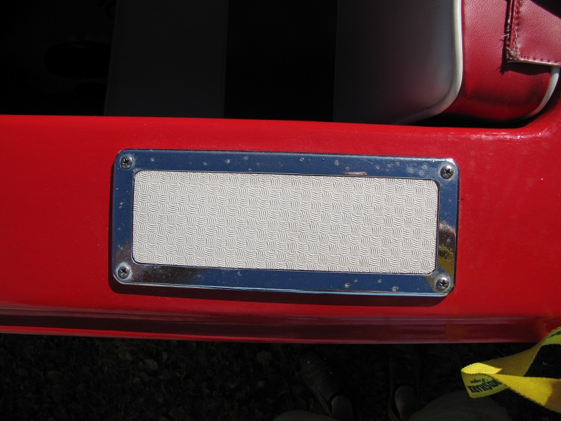

Does anyone know where I can get the white inserts for step pads? Thanx!
Re:Setp pads 16 years 2 months ago #13150
Cat,
the white step pads are impossible to find. What I did on the Tomahawk was to purchase some of the thin, sticky back step material at Defender Industries (I'm sure Weest marine has the same thing). I cut two pieces; on the size of the opening in the base of the frame and another the size of the opening. I stuck the two together (but don't just rely on the sticky back, use adhesive as well) and voila, you have an insert. Didn't come out looking too bad.
Todd (aka thetudor)
1964 Custom Craft Aqua Ray
1959 Glastron Seaflite
1959 Tomahawk Spirit
Re:Setp pads 16 years 2 months ago #13155
Cat,
classicboatconnection.com has some but they have Chris Craft on them and they're about $45 apiece! Ouch. I'm in the same situation. I need some for my boat and I'm still digging. If I get a lead I'll let you know.
Re:Setp pads 16 years 2 months ago #13247
  • CAT*FIN*k
  • Posts: 620
  • Karma: 35
I kinda figgered they were unavailable. I've been lookin' at options as thetudor suggested. Don't really want to use with the Cris Craft name. Seems once a month I could use a CNC....thanx guys!
