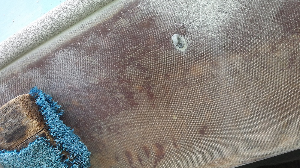

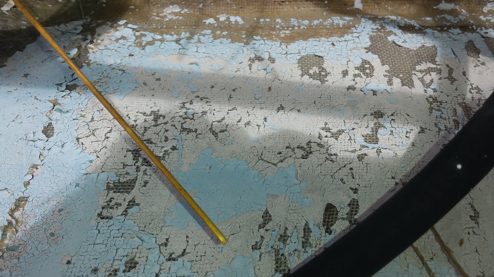

i posted a boat where a lot of the fiberglass is exposed no paint or gel coat left it just looks like screening.
as a newbie I'm asking is that a restorable condition. can it just be sanded some and painted over ???? or what would need to be done ?

Any crazing in the remaining gel coat will need to be ground out and filled or the old gel coat entirely ground off; high-build primer such as Duratec, painted or re-gel-coated. Anything is savable given enough time and money.

This is not a huge problem, don't be intimidated. What I usually do is sand the surface down smooth as possible. If you have a random orbit palm sander you can use a 200 grit or finer paper and it will do wonders to remove all the remaining gel and junk. WEAR BREATHING AND EYE PROTECTION cuz there will be glass fibers in the air. That will go surprisingly fast. Once that is done you can put several coats of high build primer to smooth it back out. Wally world or most large outlet stores will sell the primer in gallon cans. Rustoleum has it in gallons also which is less expensive than going to an auto paint store.

i had the same road rash on mine i went under the damaged area and added a couple of layers on the inside to build it up for strength and then as the others resin to build it back up and then some filler primer so you can see the voids but add something back inside to keep the strength as the surrounding areas..... then build the outside up.
