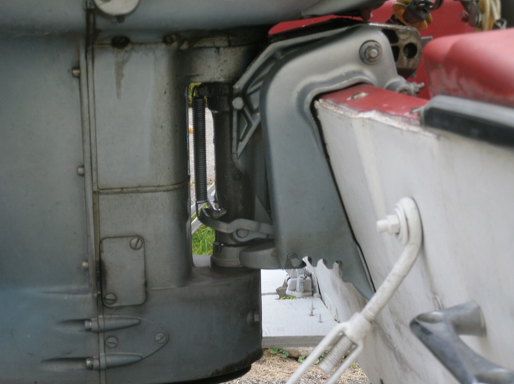

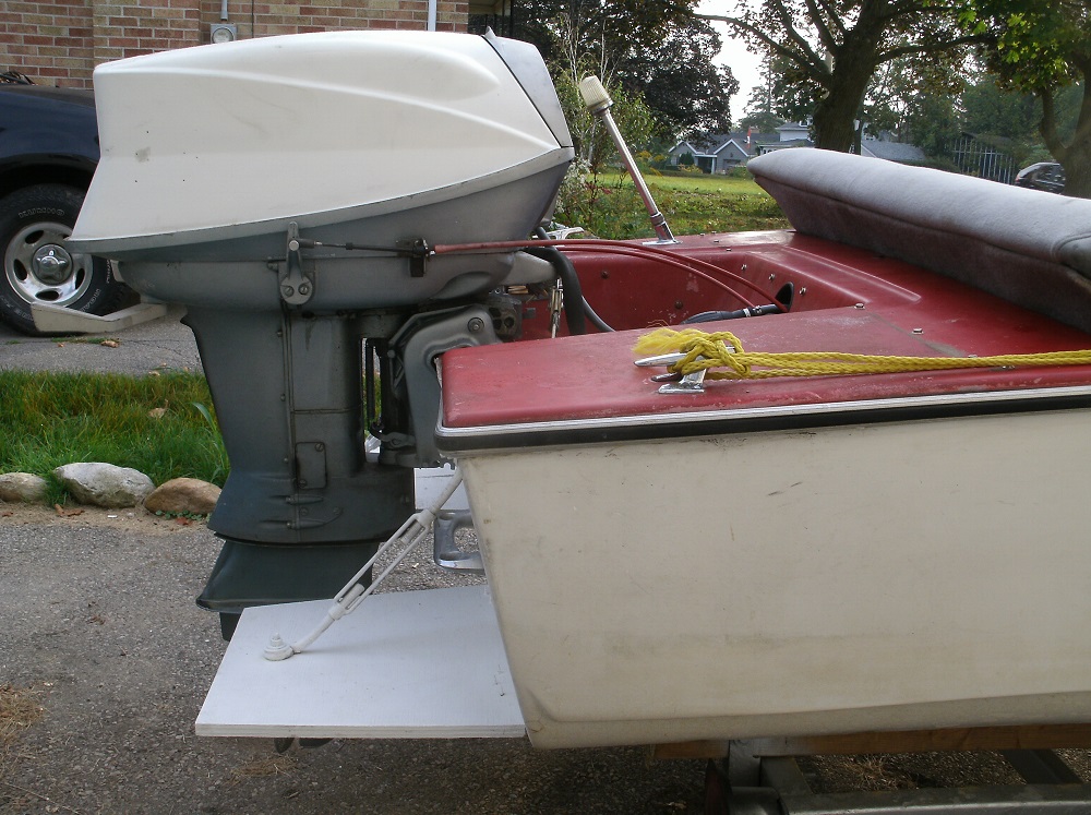

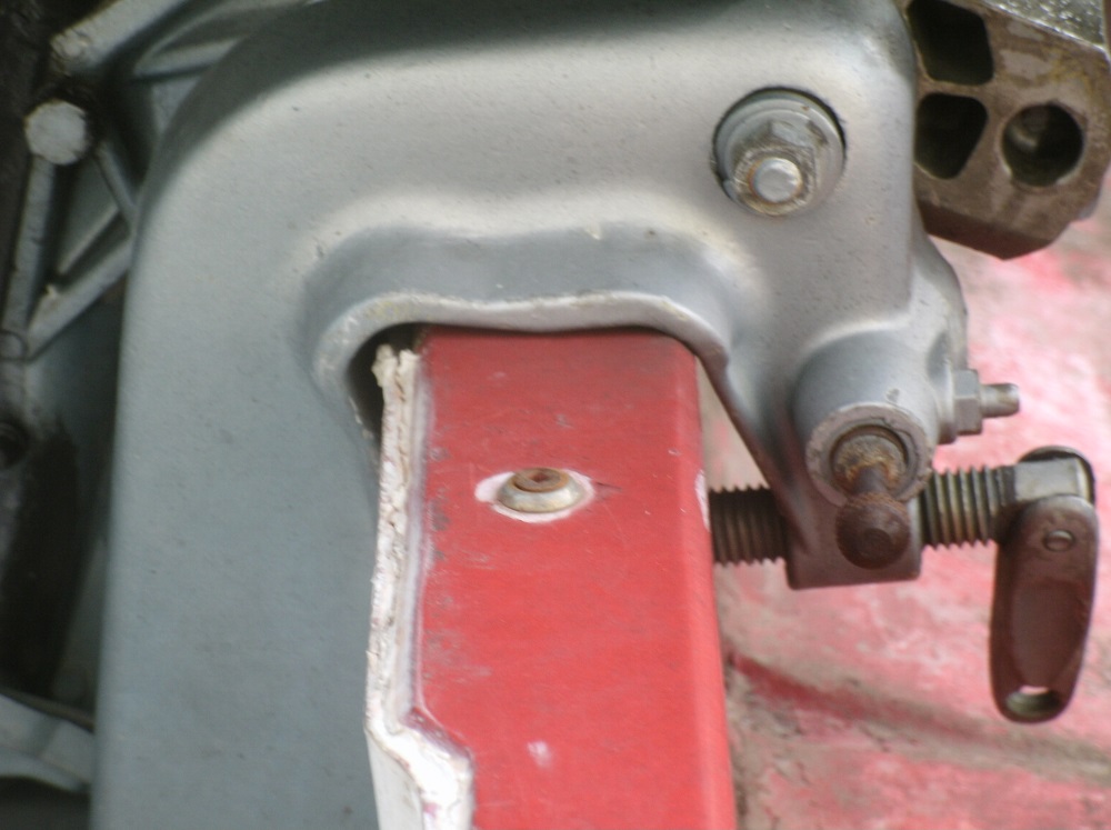

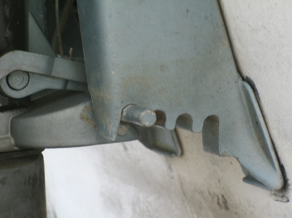

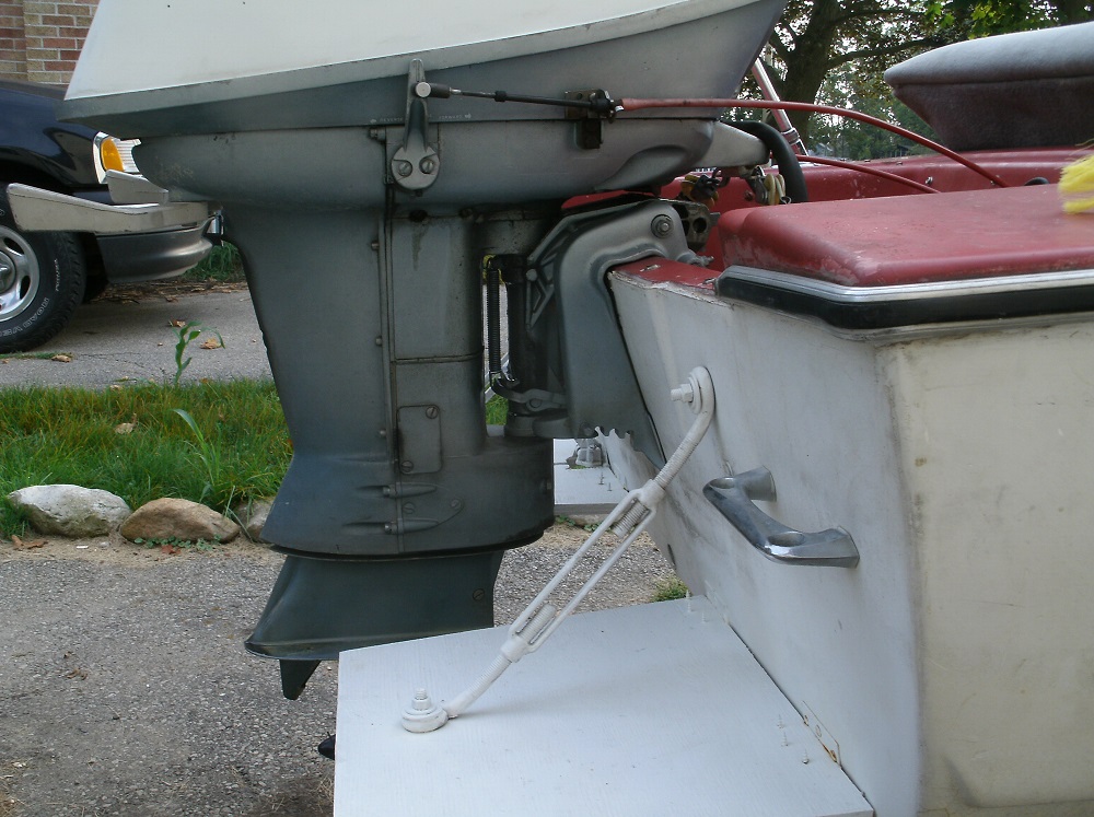

Now that I've got the oldNrude running better I've had a few hours to feel the Humber out on the water and I think that my engine needs to be angled outwards from the transom for better trim and running at speed. It seems to be at it's last adjustment point and to the eye it appears that that prop is too far forward and I'm loosing a faster plane because it's pushing up and forward. Does anyone agree and can I fix this (for now) with a chunk of wood ? Thanks in advance, Mark.

Since you're maxed-out on adjustment, there's a couple of ways to get some more. You'd either have to buy, or make and install some thin "transom wedges" between the motor bracket & transom, or you'd have to get one of those aftermarket jack plates that have an adjustable "trim" position (either manual or power). The power trim ones are quite expensive (CMC is one brand). You'll have to search for a manually-adjustable plate, it would be a cheaper option if available.

Note that whatever you do, make sure you're not relying on just the transom screws to hold the motor to the boat. The motor should be bolted thru the transom and the wedges should be bolted to the transom as well. I can't tell on yours if there are bolts or bolt holes at the bottom of the transom clamps but typically there's a flat area down that that can be drilled for a 3/8" transom thru-bolt. Especially important if you install wedges, there's a lot of force back there and you don't want an unbolted outboard jumping off the transom.

I'll believe you, I sank the Humber a few weeks ago but got her out after forgetting a plug ! I was talking woodshop with my neighbor and I'm going to fix something up. I don't think the motor is bolted on so that was probably screwed up about a decade ago when the last owner (R.I.P.) put a new bottom in her. Tomorrow is going to be the end of her season so I'm doing nothing today. The Wife says I have to make her pretty by next summer and I might have another engine for her too. I copied all the tips so THANKS again. You got the motor to give me enough to get on plane but bow heavy is a good description. Could just be an HP issue. I've got too much to do and winter ain't even here yet !

Looking at your pictures tells a story you probably don't want to hear. Your transom looks like it's bowing out. I can see separation where the outer skin meets the inner shell. I strongly suspect the transom is wet and rotted. The weight of the motor has pulled the transom down and out causing the angle to change. How about those trim tabs... raise them completely out of the water and see if that helps. You can shim the motor at the transom but I think you'll just be putting a band-aid on a broken leg.

I've seen what you are seeing and agree completely but the boat is nothing BUT band-aids so one more won't hurt. It's pretty much done back there but it's coming apart over the winter for paint and refurbishing. I just wanted to get it wet this year and enjoy what I've missed for so long. It's been worth EVERY dime and most of the tears and hair pulling (laughing). She's a tough old hull and I think I'm gonna keep her for the duration. I've got another coming but I don't even know what it is yet. My Buddy is gonna surprise me. Here we go again !

How's the bottom look? If you sight along the keel, is it straight? A hook or rocker can really make for sketchy performance.
Can't really tell about motor angle with those plates in the way. I suspect someone added them as a band aid to fix other issues.
Spacing an old outboard on an old transom. 9 years 2 weeks ago #134266
She's true on the bottom. The tabs were built by the original owner so I rebuilt them in his memory. I'll remove them next year and see what happens. The boat is all band-aids but she's done things people with twice the boat won't do. We were out in Lake Ontario yesterday and the smog was unreal. Three miles from shore and I needed my compass to find my way back at high noon ! We got lost but I found a cool hat floating near the entrance to the Burlington Canal. That's the Burlington Skyway Bridges in the distance, can you make it out ? Did any of you guys lose this hat ? If not, I'm keeping it. Thanks for the tips !
