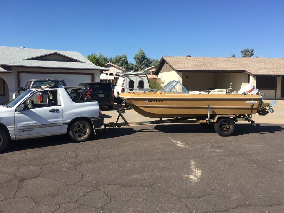

In Phoenix, not so much. Though I did end up dragging home a '69 Silverline Riviera today with an 85hp Johnson outboard. Motor seemed to run good in the guy's driveway, hull is solid, floor has had MANY pee-poor repairs done by a prior owner, and original fuel tank has been removed and replaced by a portable steel can (it is an actual OB style tank though, like what would be normally found in a jon boat, not just a random steel can or tank). Did come with a pretty new set of lay down seats though, and a decent bimini top, so that's a plus. Dad has been an upholstery guy for 30+ years, so I'll have him help me make up a cover for at some point.
It wasn't exactly what I wanted, but at $1100, I figure it's an inexpensive way to figure out whether I really want to get back into boating or not. I'm not wild about a tri-hull bow rider, but I figure on the inland lakes around here, the chop shouldn't get big enough that it will become a major issue on a regular basis and I suppose the open bow may become handy for fishing. But hey, a non ideal boat is better than no boat at all, right? :lol: I'll probably visit Walmart tonight to pick up the legal necessities - life jackets, fire extinguisher, etc and drop it in the local lake tomorrow to see how it works out.

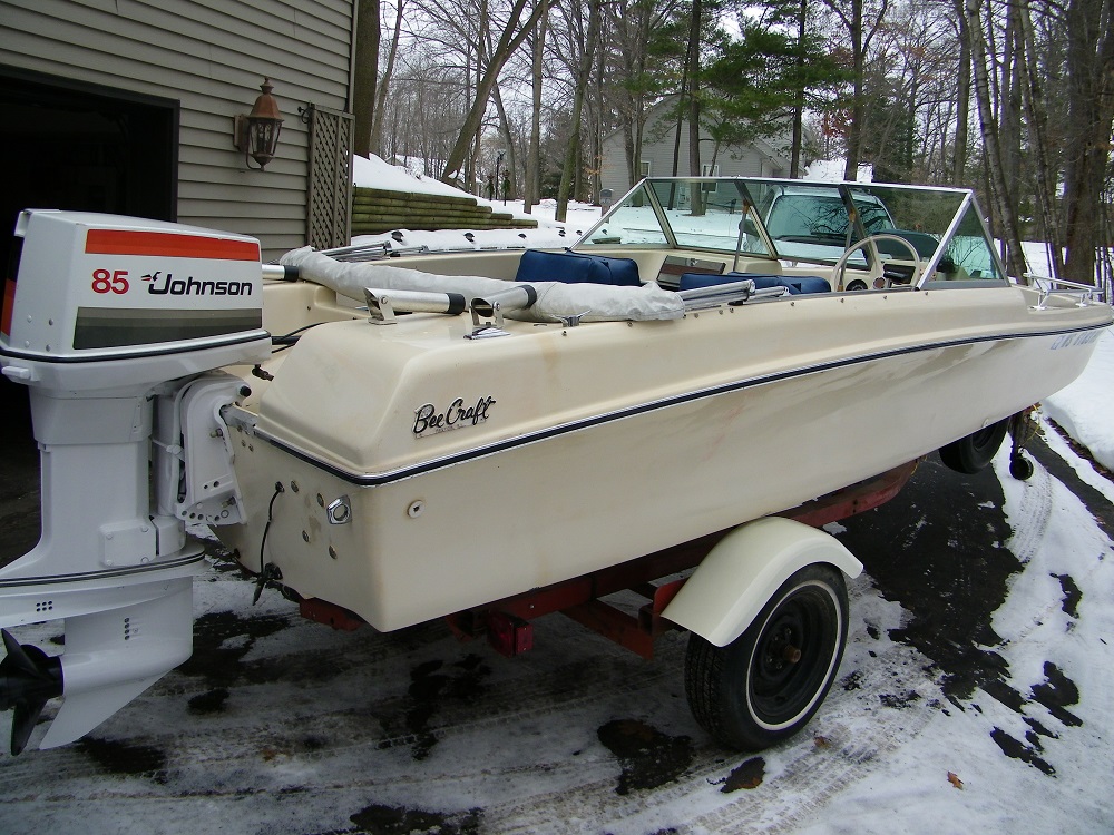

A trihull is a good solid stable platform for fishing and just enjoying the water. You can sit on the gunwales without tipping over. Mount a swivel seat in the bow area, convert the bow seating to live-wells etc. I've converted several to be exclusive fishing rigs. That 85 will also give you the "umph" to have some fun.
Here's a tri-hull Bee Craft that I had two years ago. You can see the rod holders mounted to the stern, it was set up for trolling and still fishing with a removable seat up front on a platform.

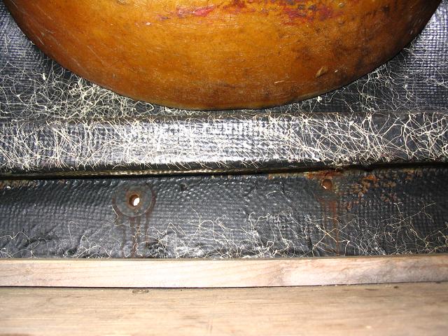

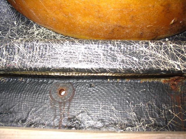

1 thing that is easy,,everybody pounds on transom says its solid wrong,, drill a small hole from inside at mid,towards bottom of transom,,if it is dry and light good if it is dark it is rotten cant spend time money with out replacing it,like restoring a car on rusty frame,,easy cheap check,just go in an inch,,then fill with silicon or resin if good good luck Bill
Boat inspection for Dummies? 9 years 3 weeks ago #134103
BILL, EVERY SPRING I HOP UP ON THE CAV PLATE WITH BOAT ON TRAILER AND POUNCE ON IT UP AND DOWN FOR ABOUT 30 SEC. I'M 190LBS. IT DOESN'T BUDGE AND TRANSOM DOESN'T GIVE AT ALL. WHEN I BOUGHT THE BOAT I RAN A PIECE OF 2"X2" ANGLE ACROSS ON THE INSIDE TO MATCH UP WITH ENGINE MOUNTING HOLES SO THE PRESSURE IS EVENLY ACROSS THE WHOLE BACK AND NOT ALL IN A 10" WIDE AREA. TIM C. HAD TALKED ABOUT IT AROUND 12YRS. AGO. NEVER TOOK A PIC BUT IT COVERS THE HOLES WHERE THE ENGINE BOLTS THRU UNDER THE SPLASH WELL. RON
