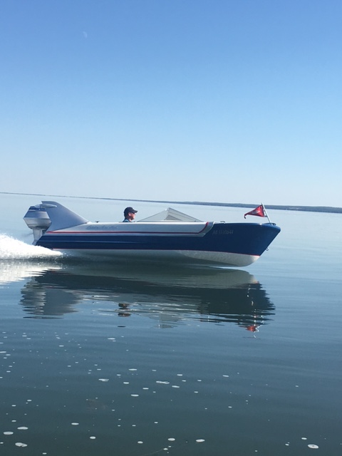

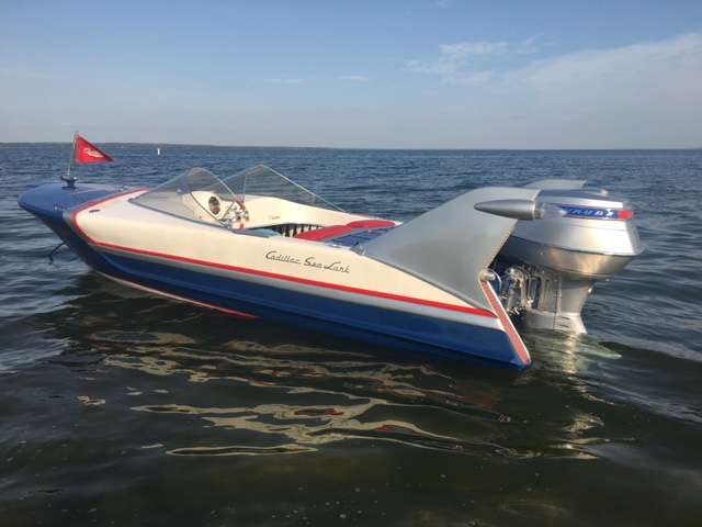

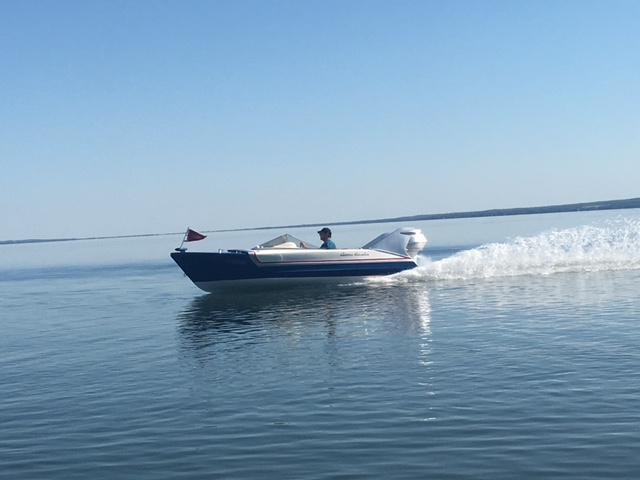

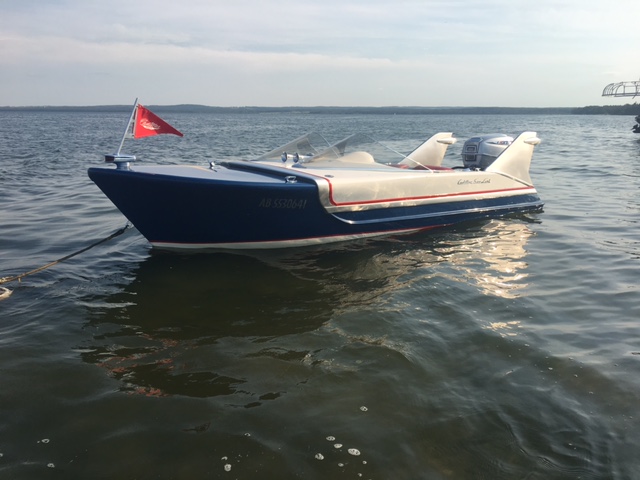

I had fun this summer with the Sea Lark on Pigeon Lake in Alberta Canada.We put the boat in the water for the first time in July. Still working on a few problems such as left hand torque steer from the Evinrude 100s with seemingly no adjustment for this. [/b] Cruising in 50's style ....Brad Lake

It looks great,,what did you get for speed that you were shooting for??Is it reg as a 2015? Glad to see all your work turn out so well enjoy Bill

Hello Bill, so far the motor speed wise is a big disappointment. Seemingly I made a mistake, I only went through the motor elastically as I was assured it was all tuned up and running strong. I am only getting about 35 Mph out of it. It runs well and idles well but just doesn't make the top end power or RPM needed. Right away I had to replace the fuel pump diaphragm ( this was my first clue) , it has good compression so I imagine it just needs the points done , timing set and go through the large single carb. I plan on going through it this winter and figuring it out. I have tried 3 different props but that is not the problem. Typical, I shouldn't have trusted others... The other thing I don't know about is how to get rid of the left torque steer from the motor. it doesn't have any adjustable fin like a Mercury has to off set the prop torque?? Thoughts ?? Brad

looks great on the lake

That rig is simply stunning and very WOW! I am going back now for another look. Good luck from the OMC people to work out your details. (I trusted a previous owner who said everything was good except reverse...turned out a scored piston as well...lesson learned to bring a compression gauge next time...I would have said maybe he didn't know, but my mechanic said the motor was taken apart and put back together knowing it was bad). Hope yours is simple details. Such a great boat to still see saved and running!!

Wow, that is one cool boat.

It is so nice to see your boat finished and on the water and I know you will use it to! Do you ever get tired of all the atta boys you get! Well I hope not ATTA BOY what a fabulous job.

That thing is gorgeous. Does it torque steer with 2 people in it, or just one?

It does it with two people also, maybe slightly less but still pulls pretty hard
