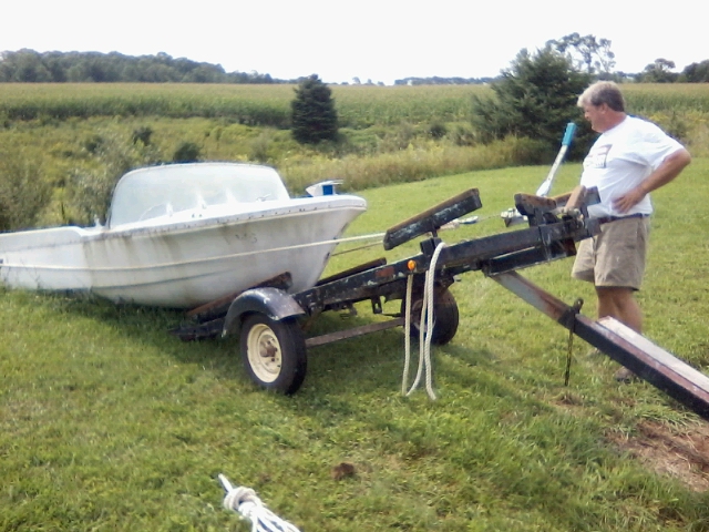

Exact same boat I restored last year. Year, Model, '60 Shell Lake Rocket.
Self explanatory so I'll just post pics of progress. Last registered in 1981 and sat on the edge of a cornfield for over 30 years. Covered with lichen, moss, weeds, grass, small trees.

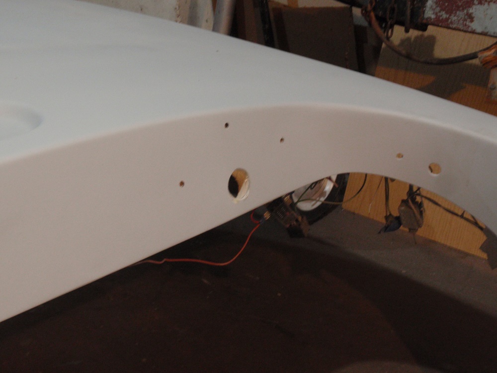

Rocket 2 rebuild Pictures only. 9 years 1 month ago #133880

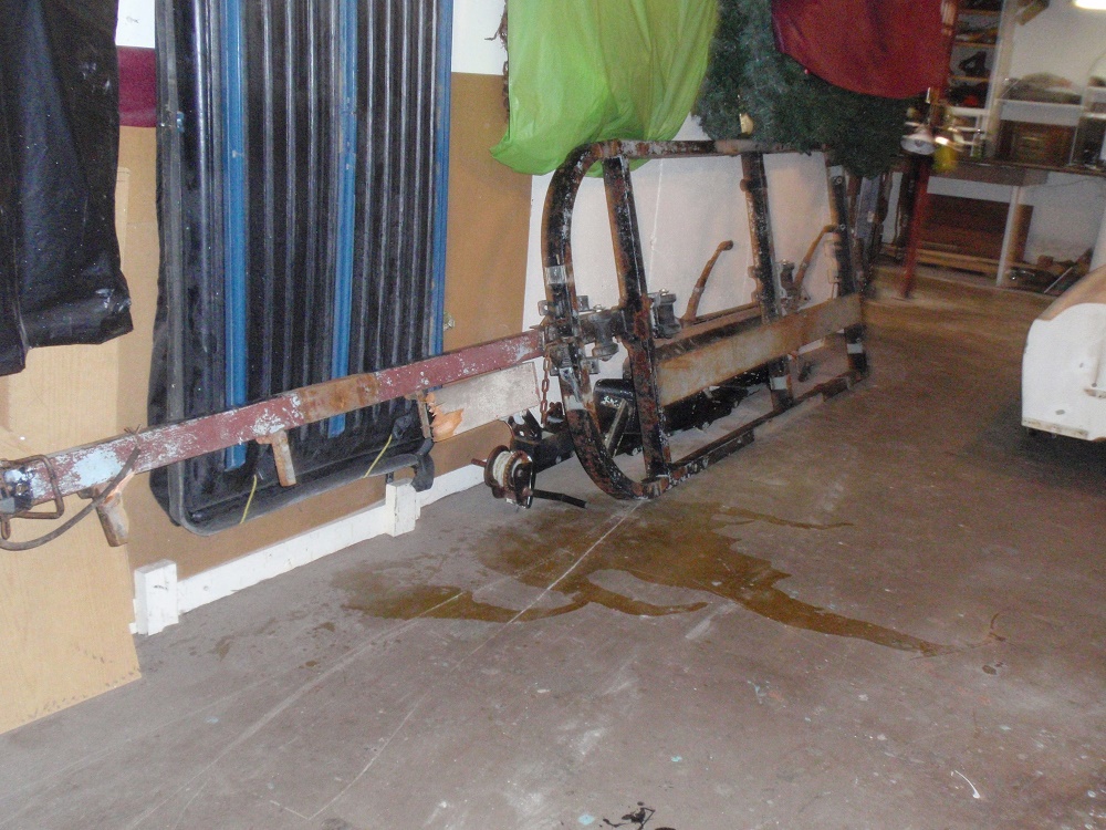

Trailer, helm holes for steering wheel, horn and lights. Complete new wiring, horn and switches installed.

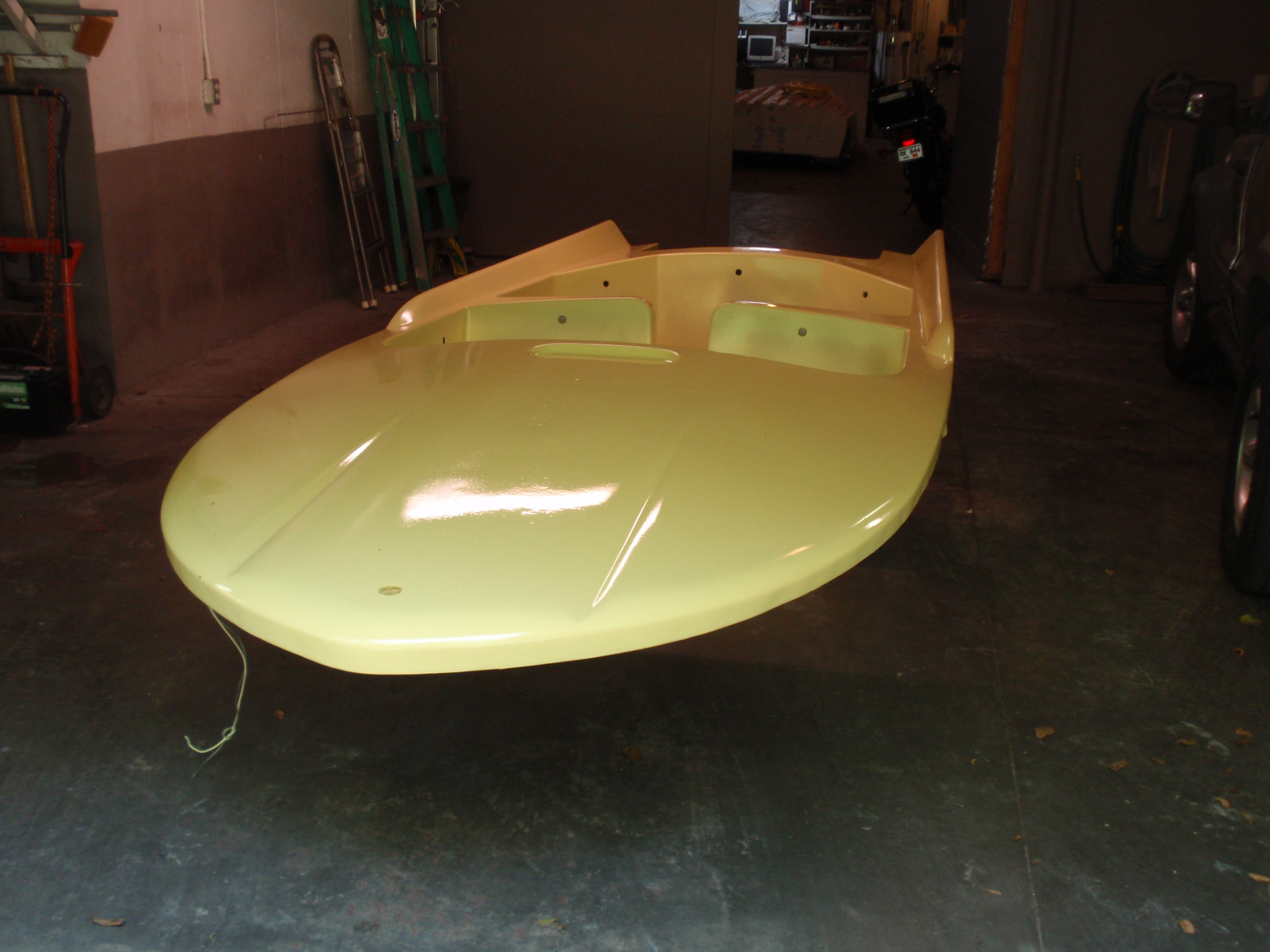

Rocket 2 rebuild Pictures only. 9 years 1 month ago #133983
Close as I can get to the original pale yellow.

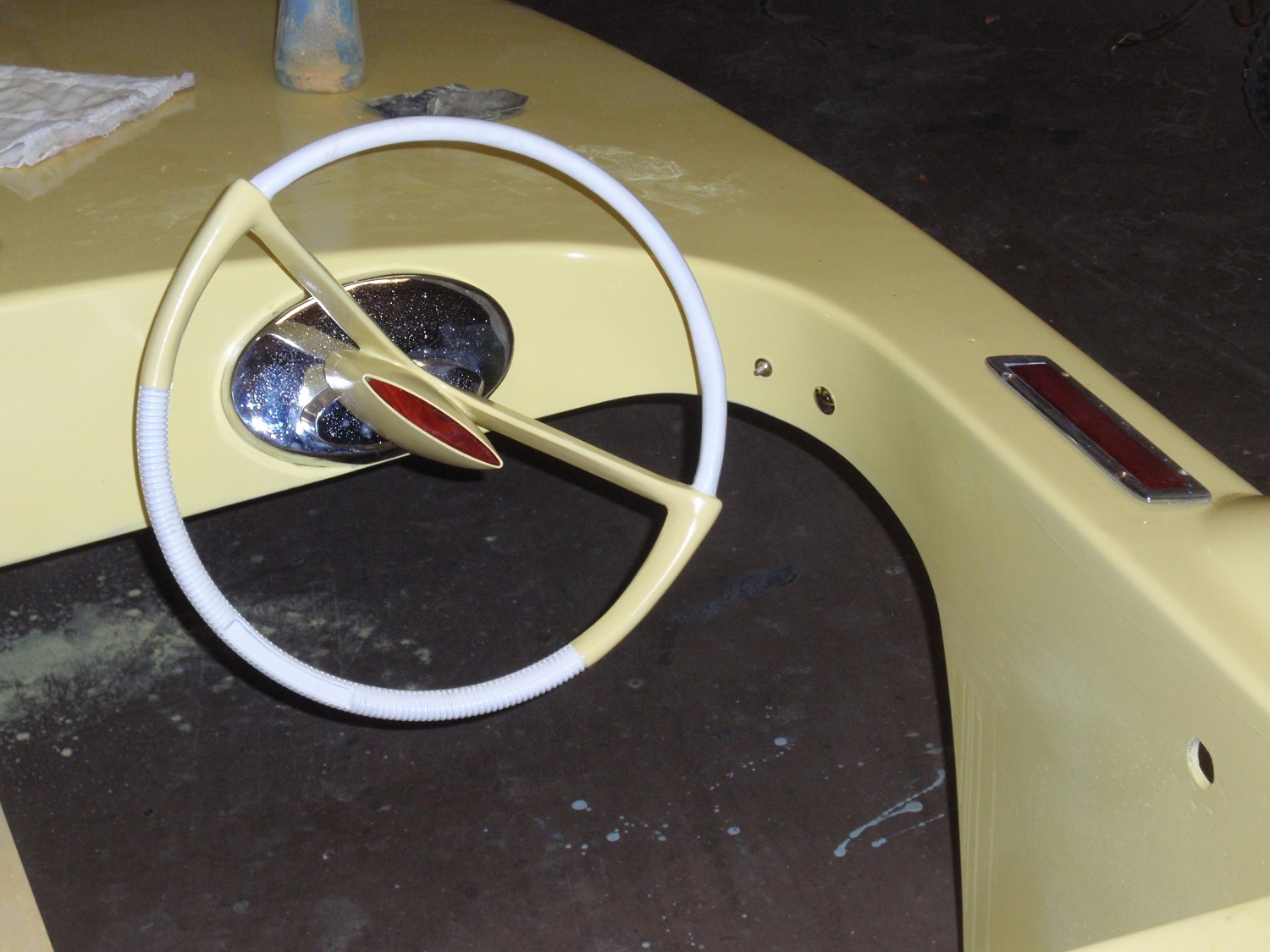

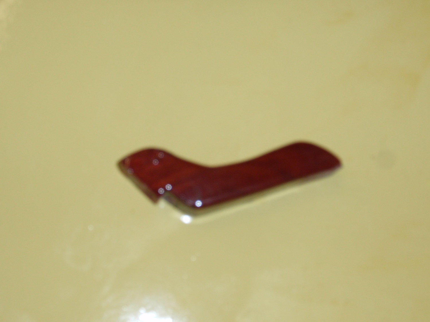

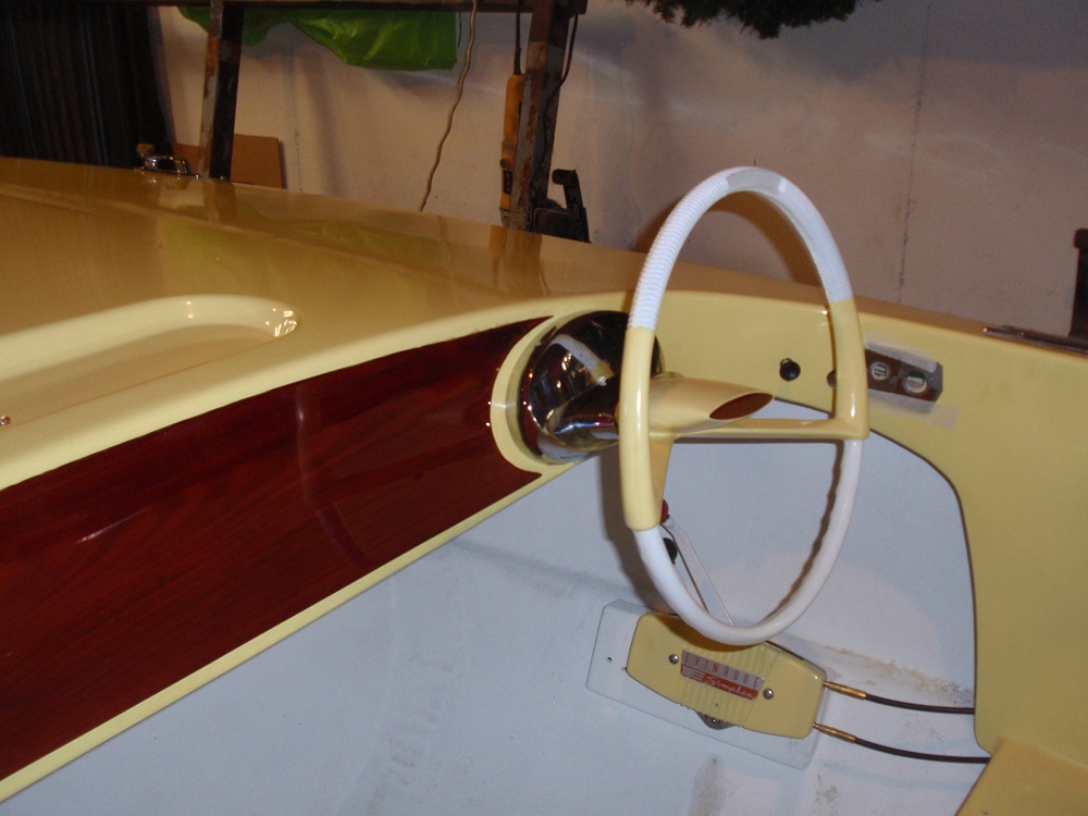

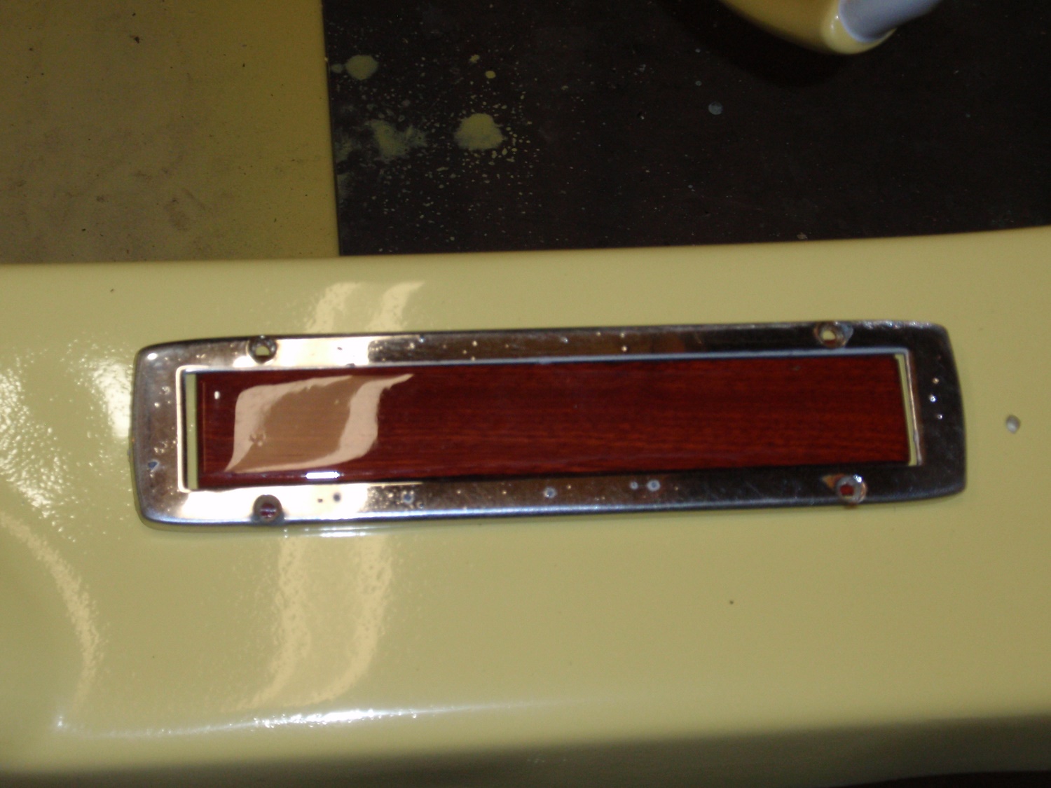

Made up some high gloss bloodwood inserts for the steering wheel and boarding steps. Also made 5 new windshield braces to match these inserts. High density exotic.

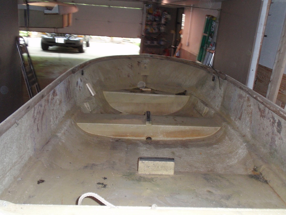

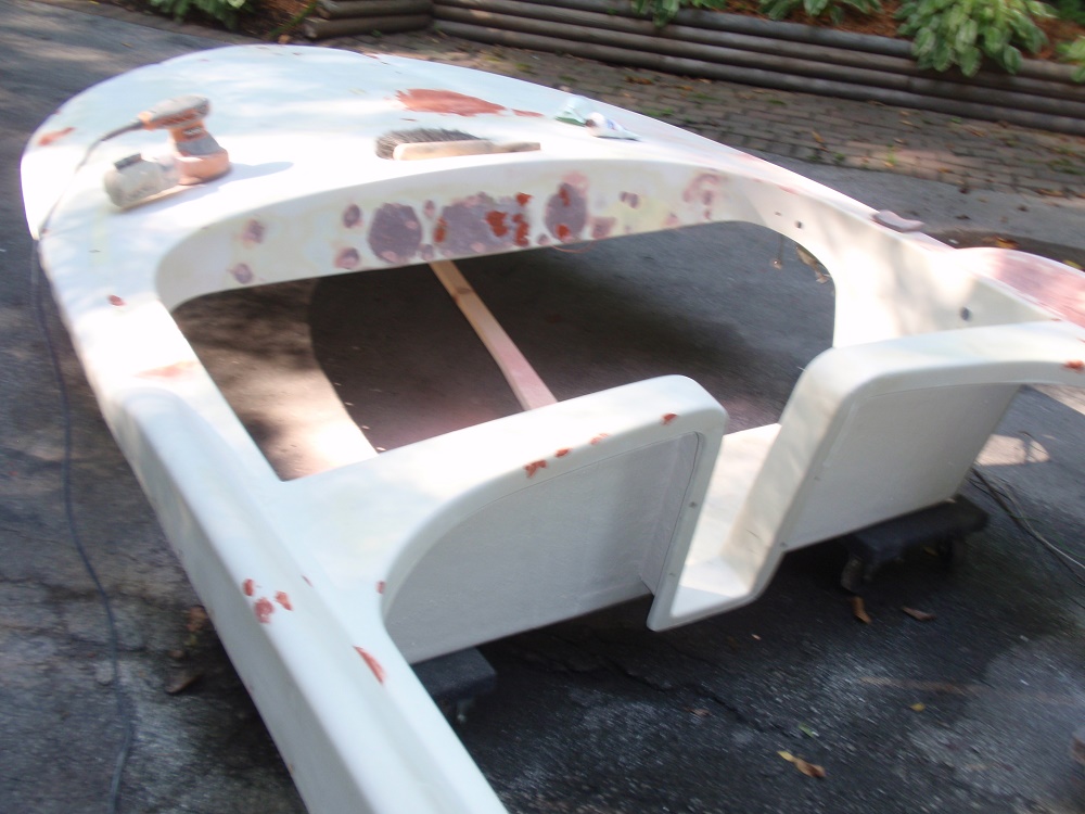

Painted inside of the hull and started color sanding. Also made up a high gloss bloodwood dash board panel.

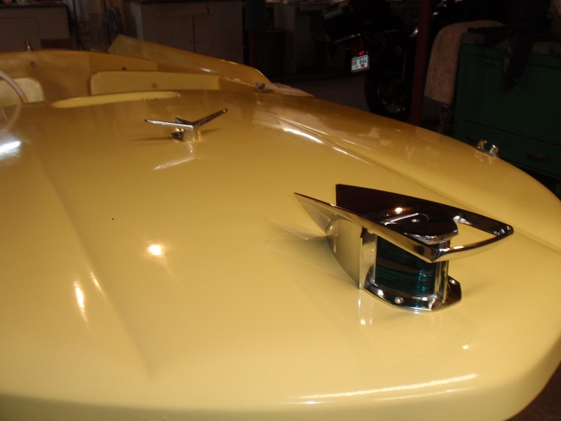

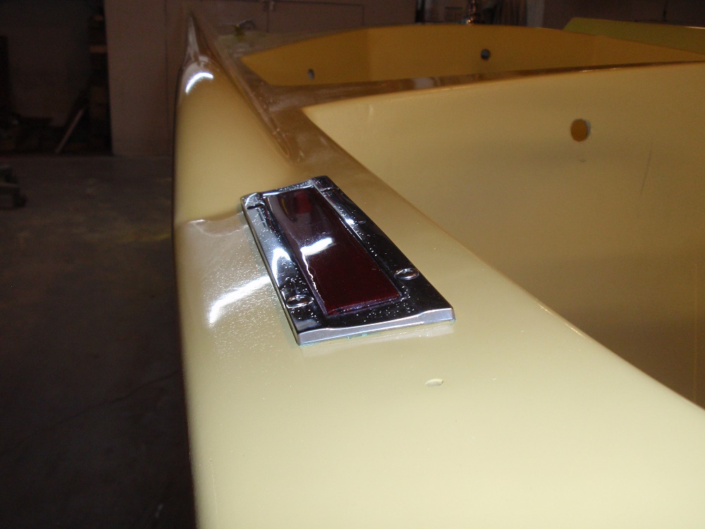

I trust that means the bow light arrived in good condition.. Brad
The following user(s) said Thank You: 63 Sabre
Rocket 2 rebuild Pictures only. 9 years 1 week ago #134314
Yupper. in the mail this afternoon and already mounted. Having problem posting a pic. I'll try again.
Thanks.
Looks mighty fine and shiny.

That looks awesome, glad it found an appropriate home instead of gathering dust at my house ...Brad

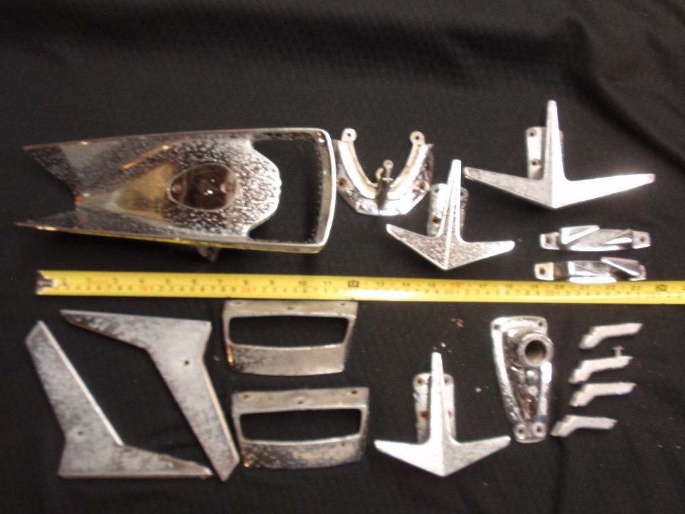

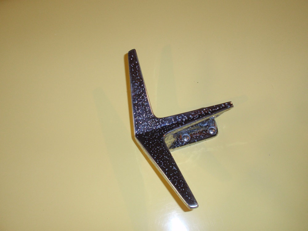

Rocket 2 rebuild Pictures only. 9 years 1 week ago #134344
Very nice work and a cool looking shape.
I am curious what you did to the chrome parts. did you bring it to someone special or did you do something yourself to restore them
Thanks

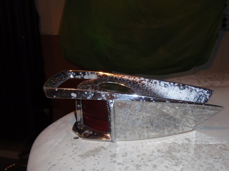

Rocket 2 rebuild Pictures only. 9 years 1 week ago #134345
The bow light I purchased from Brad (Meteor). He gave me a fair price that I couldn't refuse. It was a win for both of us. Less for me to pay and with the Canadian exchange he got a good market price.
The other pieces I just used SOS pads to smooth off the pits. I plan on going to some shows/swap meets next season and maybe pick up a piece or two. There are other resources available. The window braces I hand made out of a very high density exotic wood (Bloodwood) that I laminated. I also am using the wood as highlight trim pieces for the gunwale step pads and a dashboard panel. I'll post more pictures when the adhesive sets and I can remove clamps and tape.

I may have the 2 chrome pieces you have pictured in your last photos, I will check this weekend... Brad

The bloodwood inserts are stunning! Nice job, really adds that special touch!

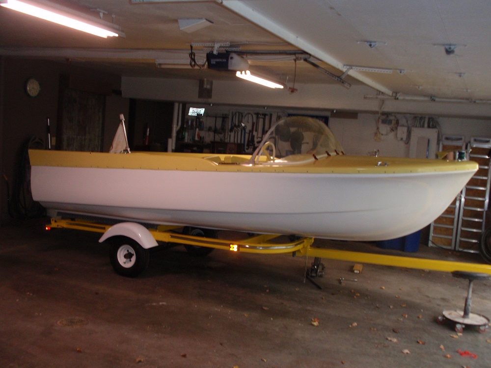

Another major step, Back on the rebuilt trailer.

Thanks Mark, I'm really getting burned out on the boat rebuilds, thinking this will finally finally finally be the last one. I've only said that a hundred times since the early '80's.
This next coming season I'm think of getting rid of all my old used parts. If Kosh next May is a go I'll be there with boxes of stuff to sell in bulk at give away prices. If the weather sucks again I'll plan on Tomahawk.
The rocket is almost finished, the punch list is down to one page, some color sanding on the hull, adding the chrome bumper and the interior etc.
The dreaded trailer is done, not my best work but done.

What adhesive did you use for the dash piece of wood ?
Rocket 2 rebuild Pictures only. 8 years 11 months ago #134517
Chuck, If I had 3m 5200 I would have used that but I was all out and wasn't going to fork over $18 for a tube.
I used PL (Pro Line) Premium construction adhesive. All weather, waterproof, exterior.
The coating on the wood is the pourable epoxy. Tricky stuff to work with and takes a few days to fully cure. When I mounted the wood I clamped a 1" x 1" wood strip on the bottom of the dash to keep things lined up straight and put a thin layer of the adhesive on both the dash and back of the wood. They were both roughed up with 60 grit sandpaper to give the glue lots of bite. I then used blue painters masking tape to hold it in place for a few days and double checked to make sure they were tight to each other.

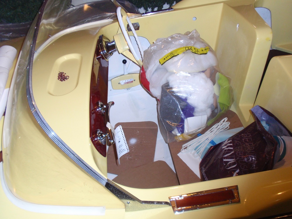

I see a lot of shine and sparkle under the shop lights...especially that awesome bow light someone sold you. What a great place for nice parts to find a home that brings them back to their glory. You are the task master... your Rocket 1 seats were really nice. Saving a pattern here and there seems quite helpful. This will be one nice Rocket!
Dr.Go!
Rocket 2 rebuild Pictures only. 8 years 11 months ago #134576
Thanks Mark. The bow light was provided by "Meteor" from Calgary, Alberta, CA. We messaged and mailed and worked out a deal that was good for both of us. Really glad he pulled through.
The Rustoleum yellow turned out good, if you look at the second picture you can see the reflection(s) of the material on the bow.

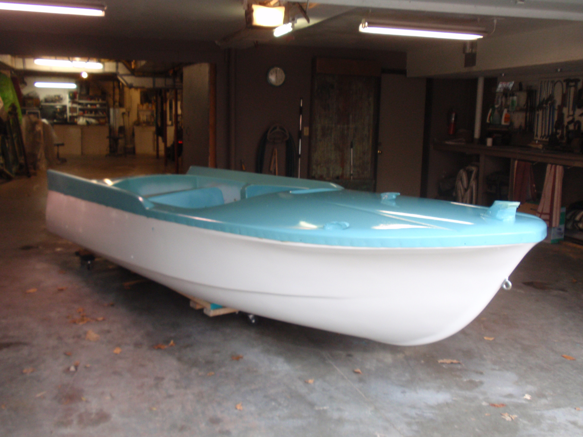

Top deck was sprayed with about 5 coats over 2 days. Three wet coats the first day. With the hardner added it sets up in about a half hour and can be sanded the next day. The hull was roll and tip with three coats. Used 800 W/D lightly on top and then went 2000. McQuires ultimate polish with the power machine for the final. The windshield needs some serious buffing yet.

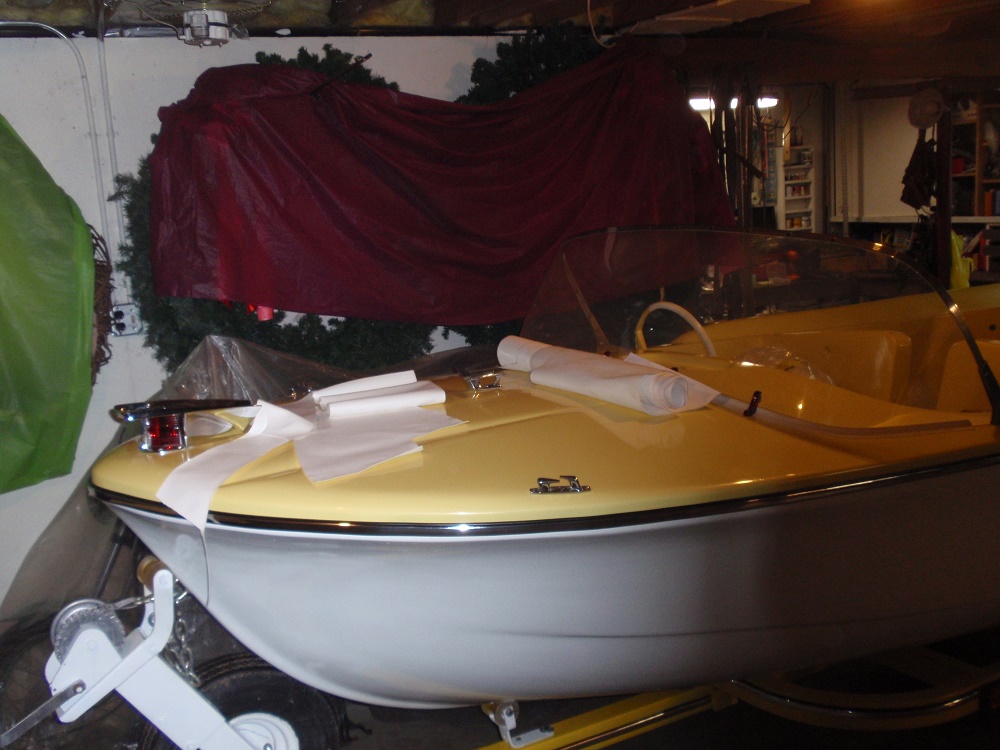

Rocket 2 rebuild Pictures only. 8 years 11 months ago #134720

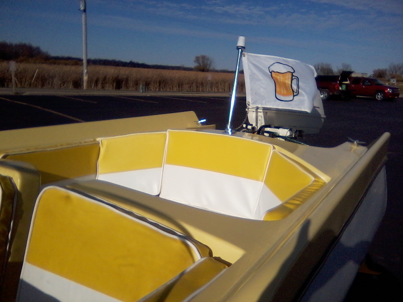

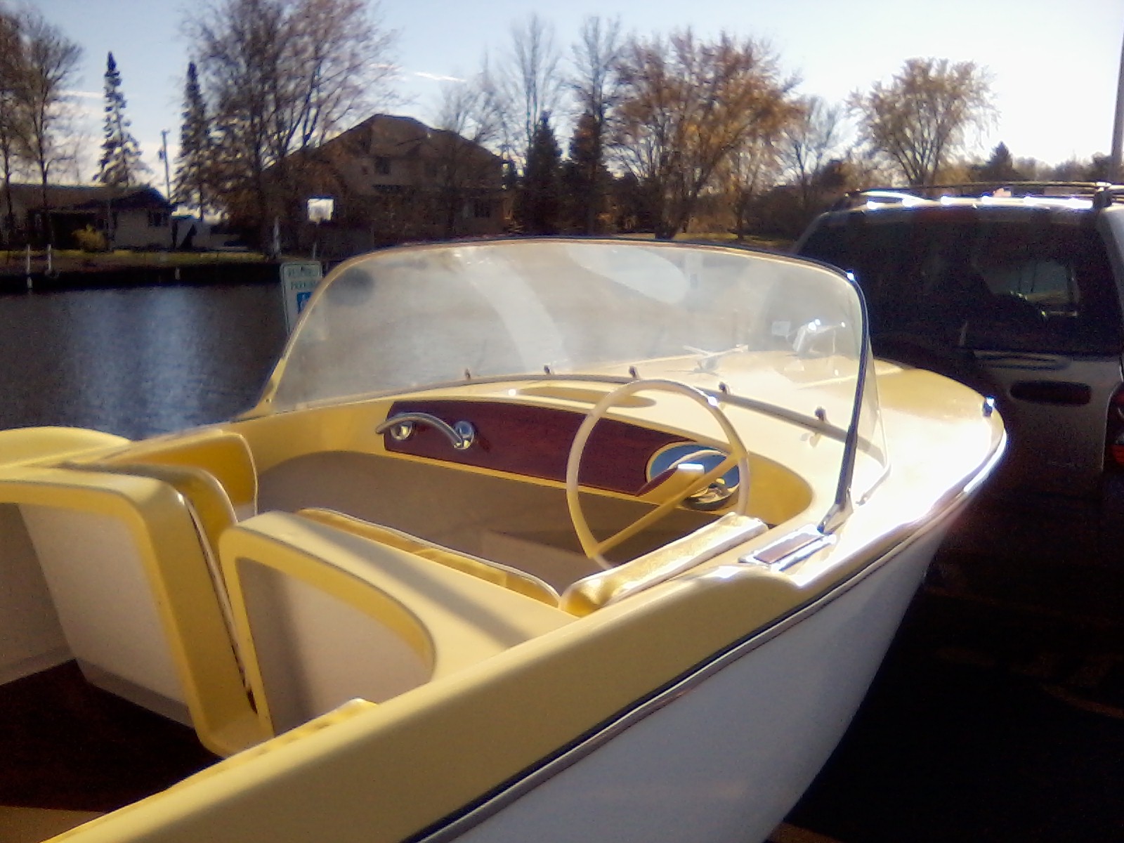

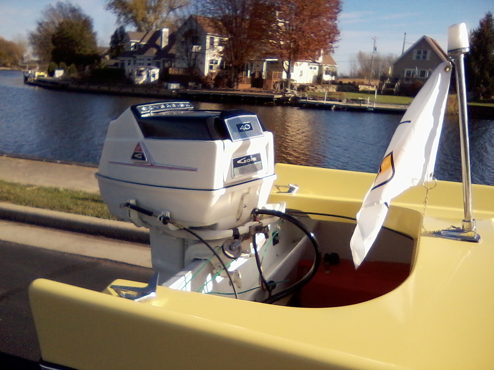

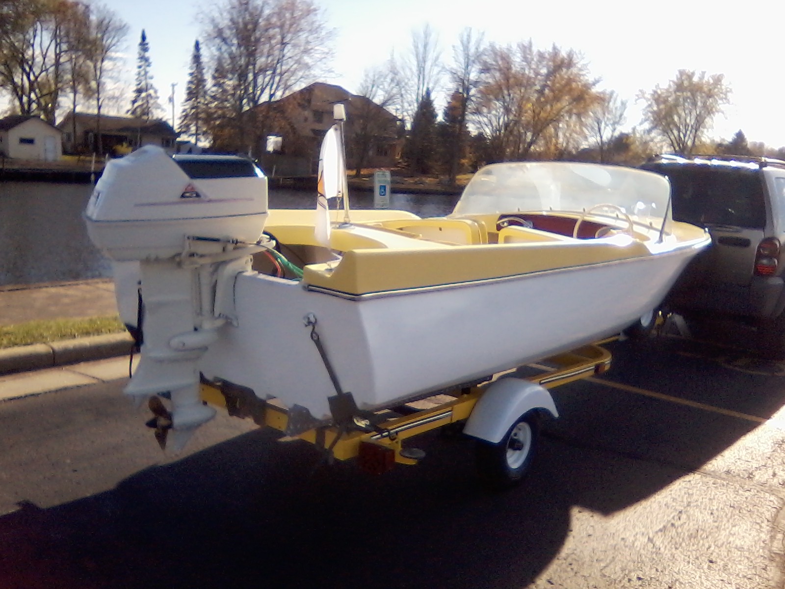

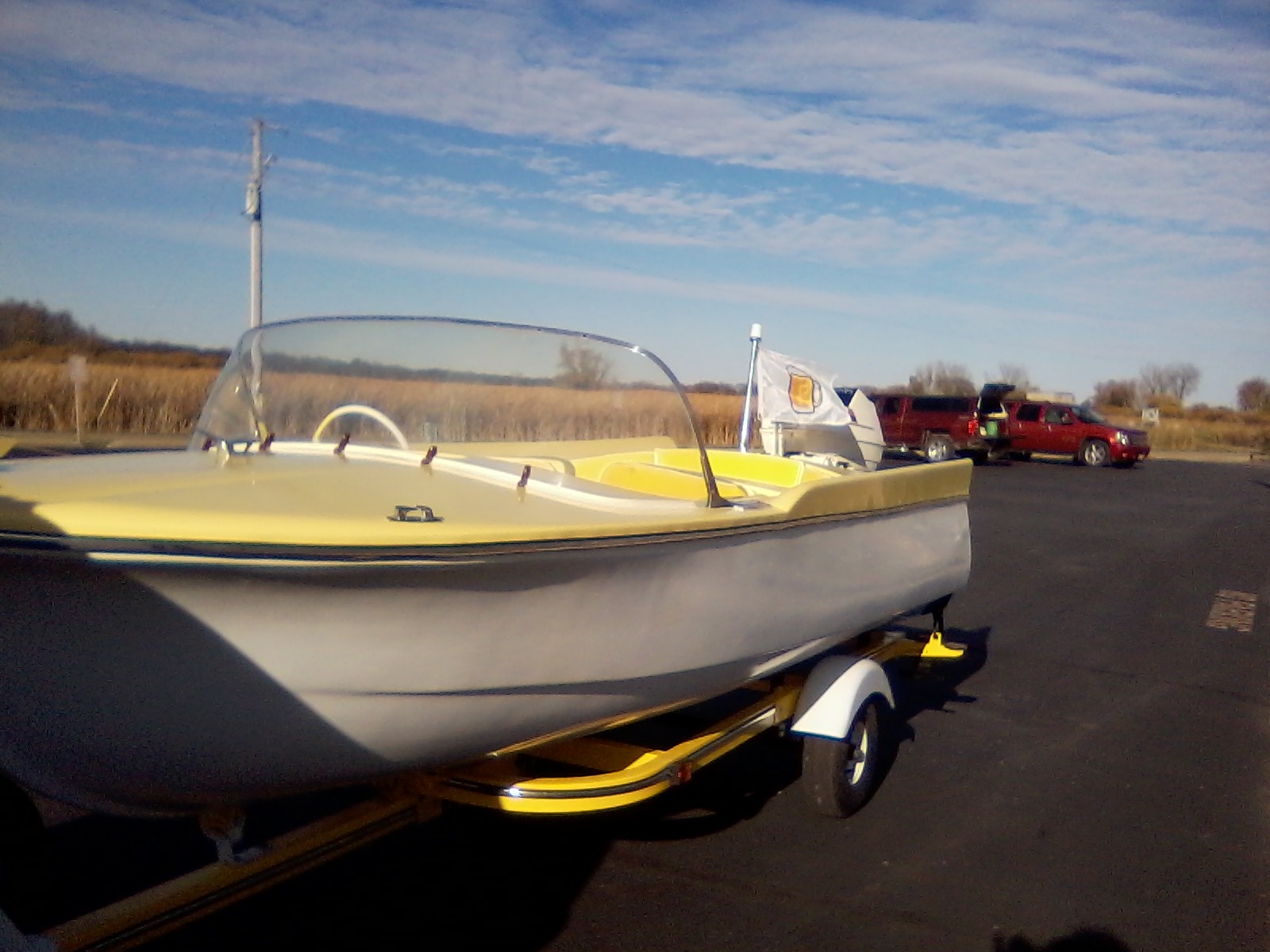

Just about wrapped up for the winter. Details to do, polish windshield, finish wet sanding hull, mount the interior cushions, blah blah.

Wow Cal...Wow! That really turned out nice. What a great combo and great colors to go with it all. That rig will look great behind any vehicle and especially on the lake! Lots of talent and determination right there!
