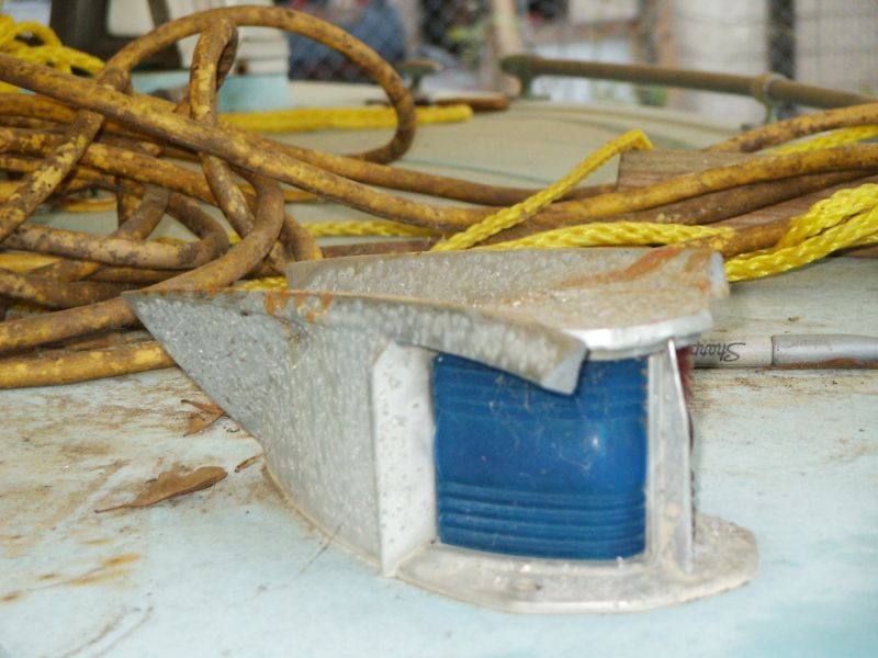

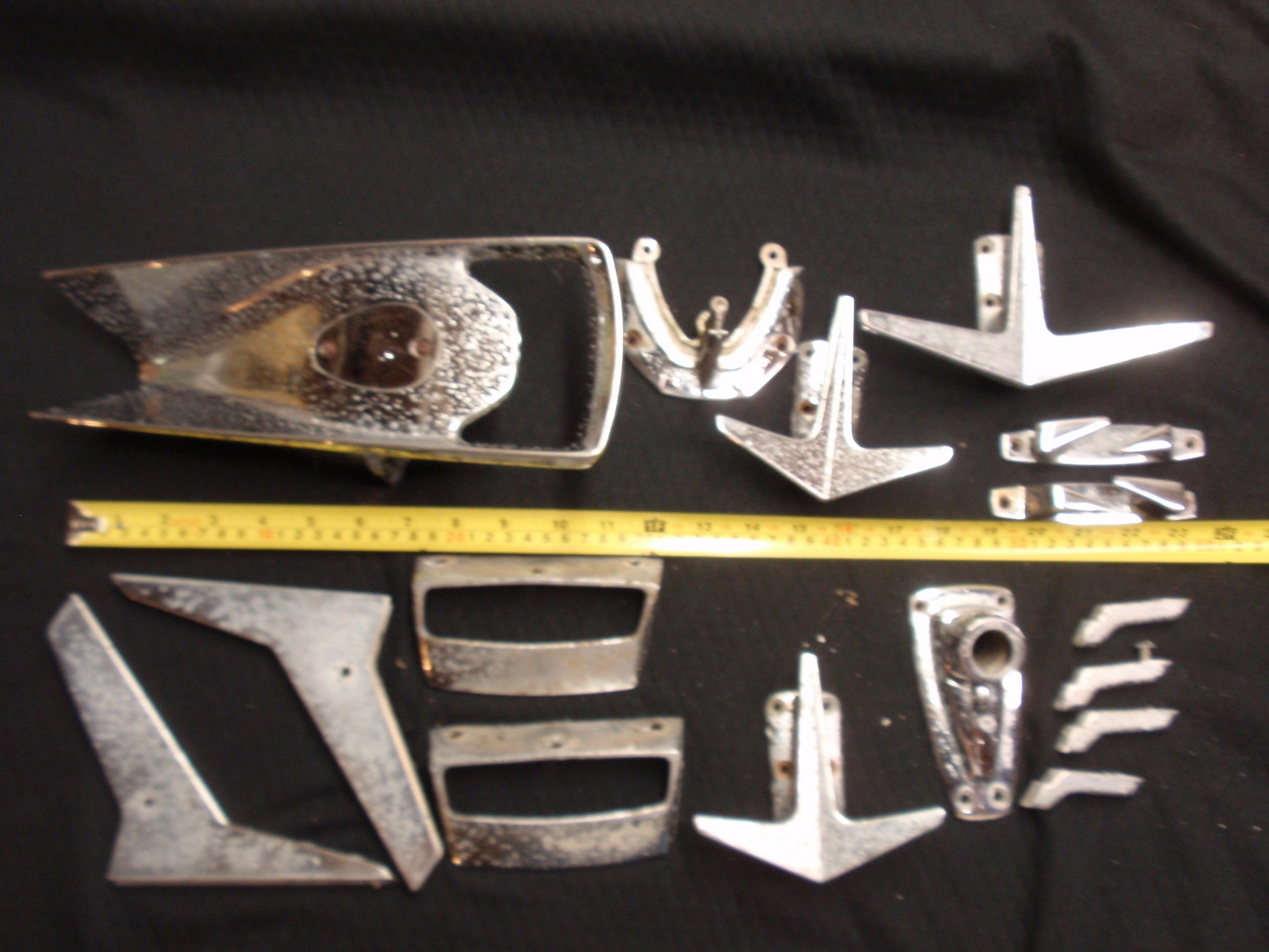

Anyone have experience with getting bright work re-chromed? I'm looking at some options and getting a quote from a shop in Texas. Got 16 small pieces total that are well pitted. Guy I spoke to on the phone says they take the parts down to bare metal and then do the process. Told him I was on a budget if that helped any:laugh:

Chrome Quote:
1 - Stern light - $200
2 - L pieces - $100 each
2 - D shape pieces - $100 each
1 - Stern light base - $100
2 - Small plane rope chocks - $100 each
1 - Large plane rope chock - $125
2 - Small rope chocks - $70 each
4 - Small piece - $45 each
1 - Misc. U shape piece - $100
Total for all 16 piece - $1445. (We are currently running a 4 – 6 week turnaround time.)

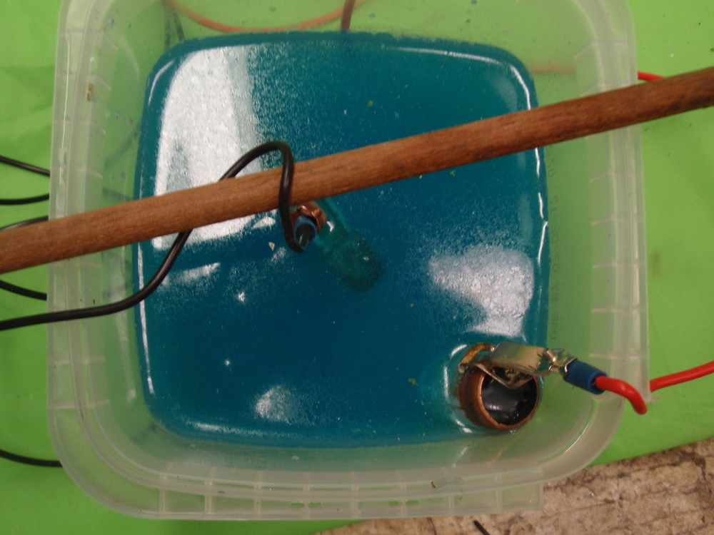

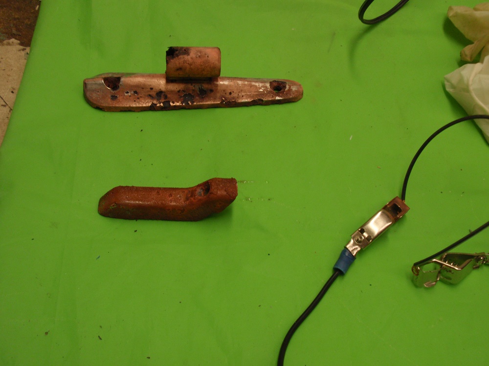

The pitting is bad so I'm "sperimentin" with some options. Going to try and do the plating myself. All the chemicals and nickel plates are on Amazon. I started this afternoon just for a fluke because I do have copper sulfate and the equip needed to get the base copper coating. Had an old chunk of pitted chrome mirror mount that I tried and it started coating right away so I used some 350 grit on one of the windshield braces to take down the pitting, washed with vinegar, rinsed and then set up a solution of copper sulfate, connected a 9 volt power supply and clipped one (+) to a short section of copper pipe, and the other (-) to the brace. Started plating within a minute. Left it in there for a few hours and built up enough copper to somewhat smooth the pitted surfaces. Now I'll let it sit over night to and see what it looks like tomorrow. If it's good to go I'll order the nickel sulfide(?) and nickel plate. So far it cost me nothing. The other chems and plate are around $30. Nothing to lose, if it doesn't work I'll just be at square one again.
Chrome 9 years 1 month ago #133898
Cool!!!!!!! Cal one of the Century guys owns Proctor's in Mi Adam Leigh with Lucky Debonair Sabre, in case it doesn't work out. Can't seem to find the one in Richmond VA.
Chrome 9 years 1 month ago #133901
Doing some online research and finding out that the old pot metal is about the most difficult stuff to re-plate because it starts out as junk and is full of adverse metals. Nothing ventured, nothing gained.

63 Sabre wrote: Doing some online research and finding out that the old pot metal is about the most difficult stuff to re-plate because it starts out as junk and is full of adverse metals. Nothing ventured, nothing gained.
Well......Nothing gained. A lesson in futility. Best to leave it to the professional. The power clip coated beautiful but the pot metal is just awful.:S
Still a good way to remove rust from old parts though

that bow light is a atwood. if you look thay can be found nos on ebay or on the web for around $200 to $250 hope that this helps Bob

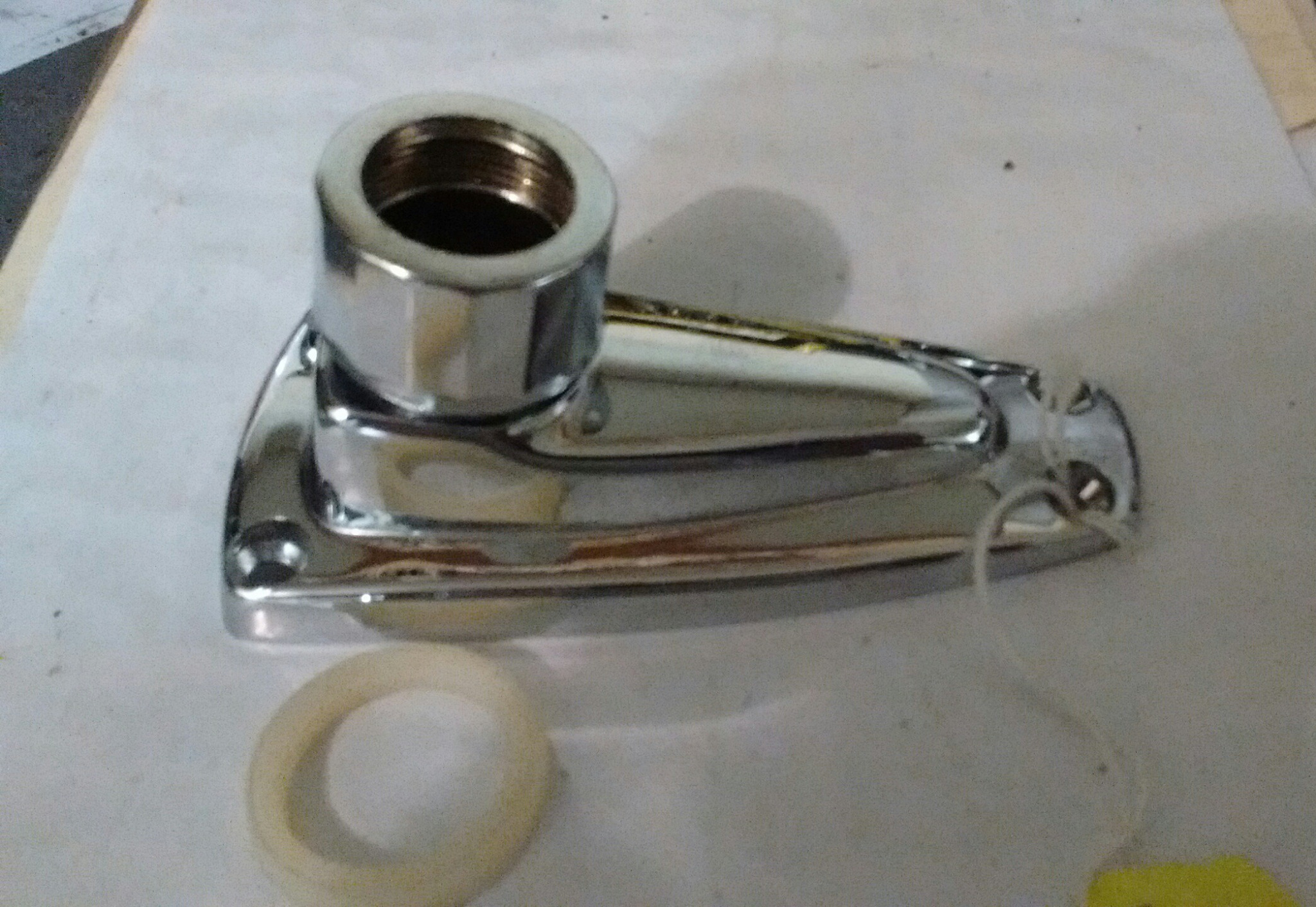

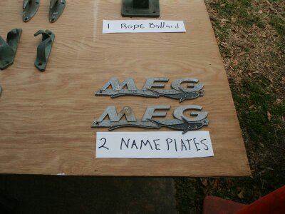

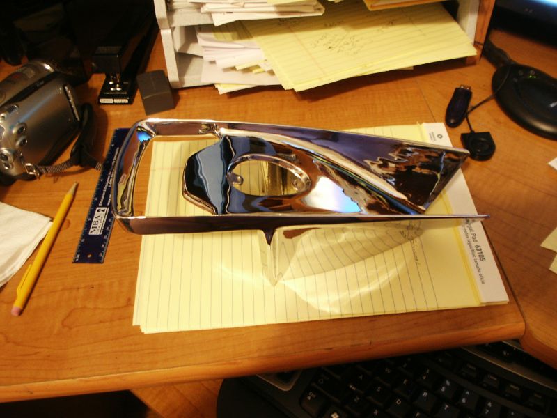

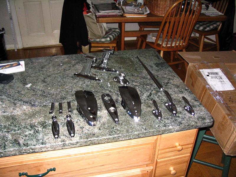

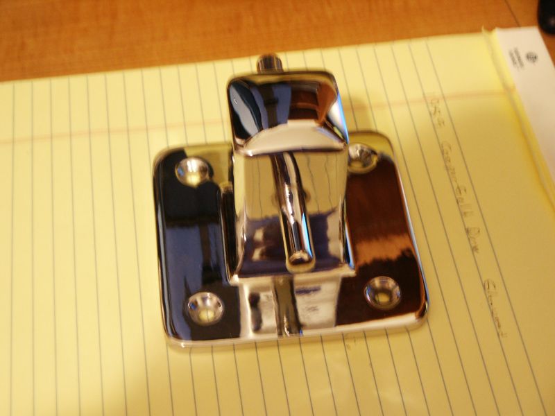

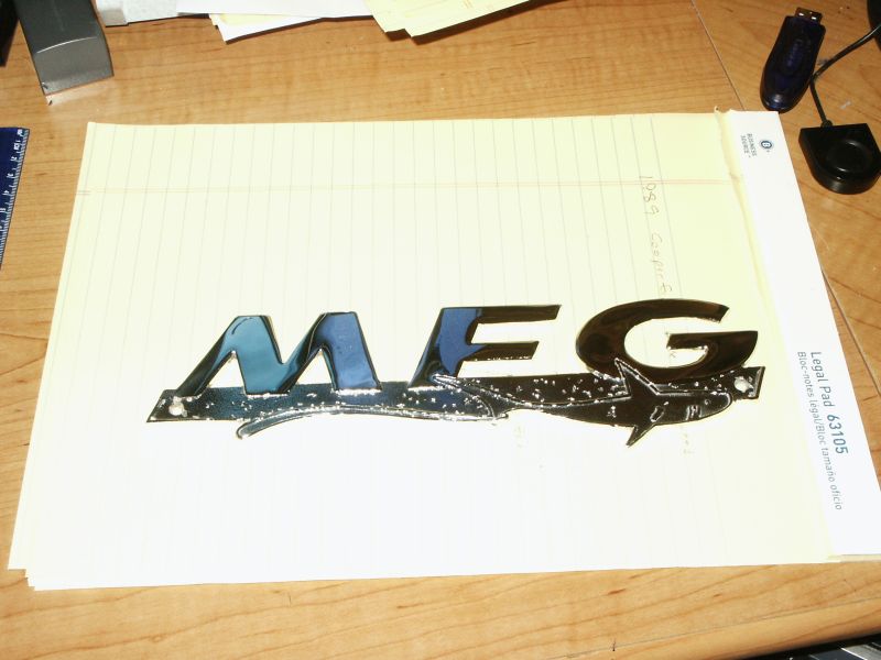

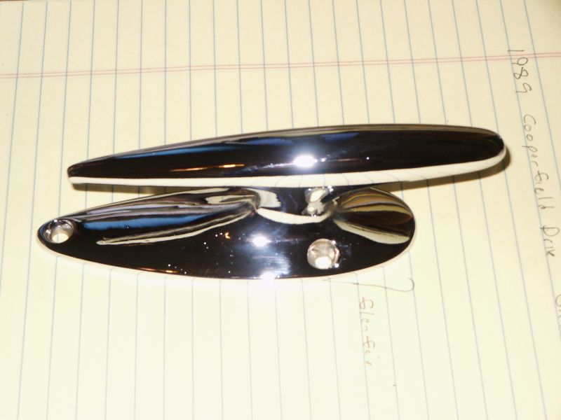

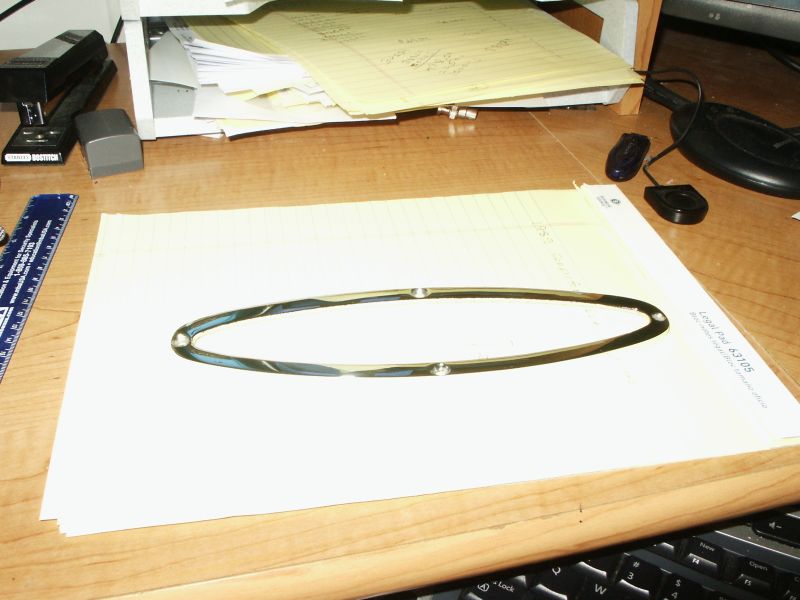

i hear ya on the plating i had a bow light like the one shown my handle was broke , i found one on ebay but i wasn't any better just not broken i checked alot of places and really didnt' want to send my stuff out of state , anything go wrong i am out pieces i might be able to find and lo and behold southern bumper exchange about 15 minutes from the house had a 6 week turn around, which was ok i was about 6 years on the turn around on the boat i had ten pieces , two large cleats a rope ballard 2 name badges, 2 step rings the bow light the bulb cover and the lense bracket 750.00 they were bad and he unwrapped them i was shocked looked brand new better than brand new no pits and a real good shine. if this time lasts fifty years it was worth it. a few pictures

NOS would be a good way to go. Old pits in zinc die cast, re-plated, can open up again exposed to moisture and age, any good finishing shop would tell you this. 30 years in the metal finishing industry here. I acquired a similar NOS just like that, well worth the asking price. I think someone mentioned replate would be $200.

Communicating with Brad. Making arrangements. Never thought that the old pit marks would make their way back through new plating.

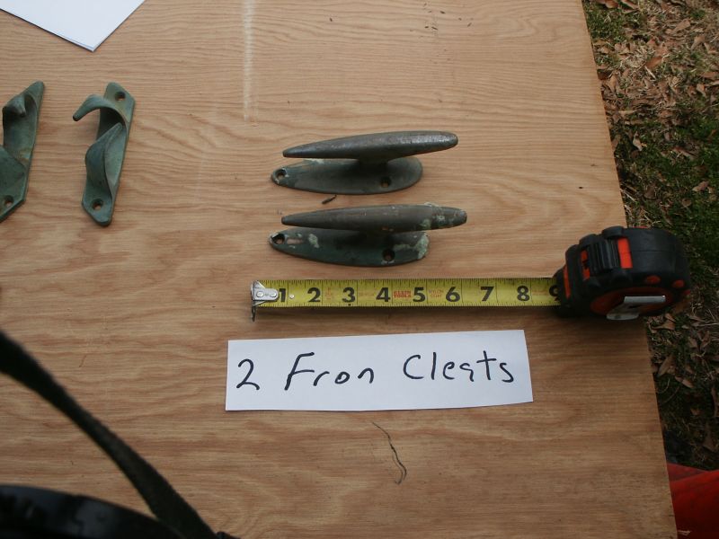

late to the party but I have those cleats NOS
60 bucks each shipped to lower US
