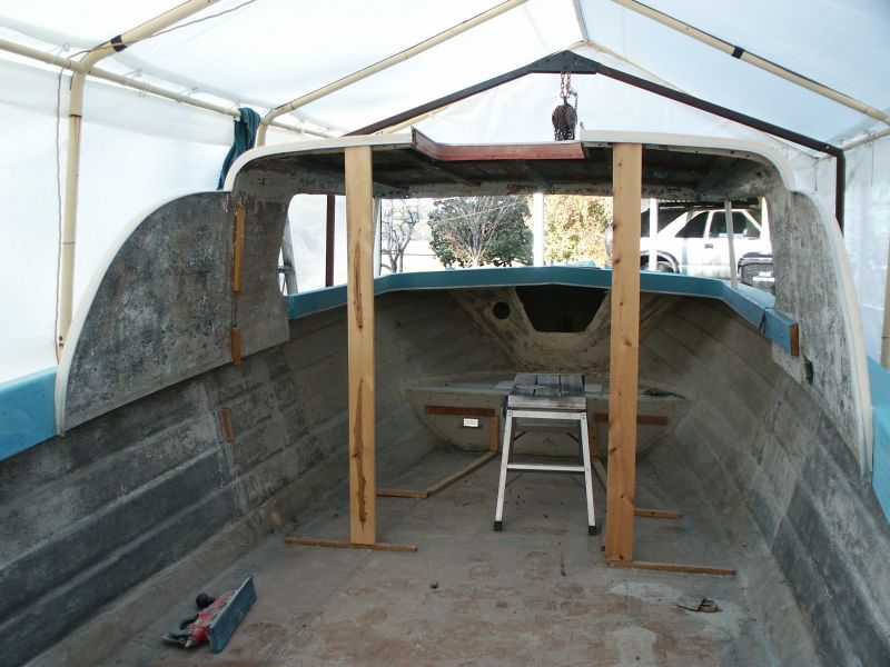

Newb. 9 years 1 month ago #133847

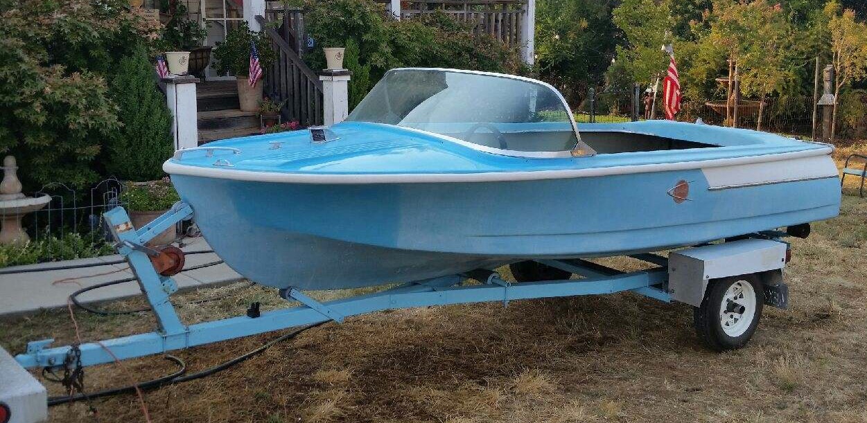

Sneak peak. Just a bit of the original gel coat shining through. Also - had a 60's Dorsett glass windshield installed.
I could really use some help from other owners who have restored a similar boat. My main focus at this point is getting the interior straightened out. I already completely rebuilt the original rear bench seat (except foam).

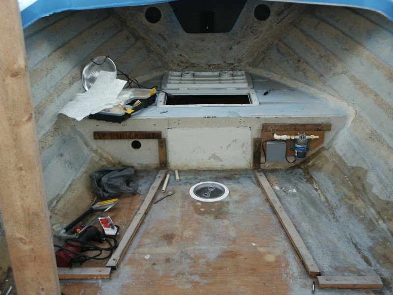

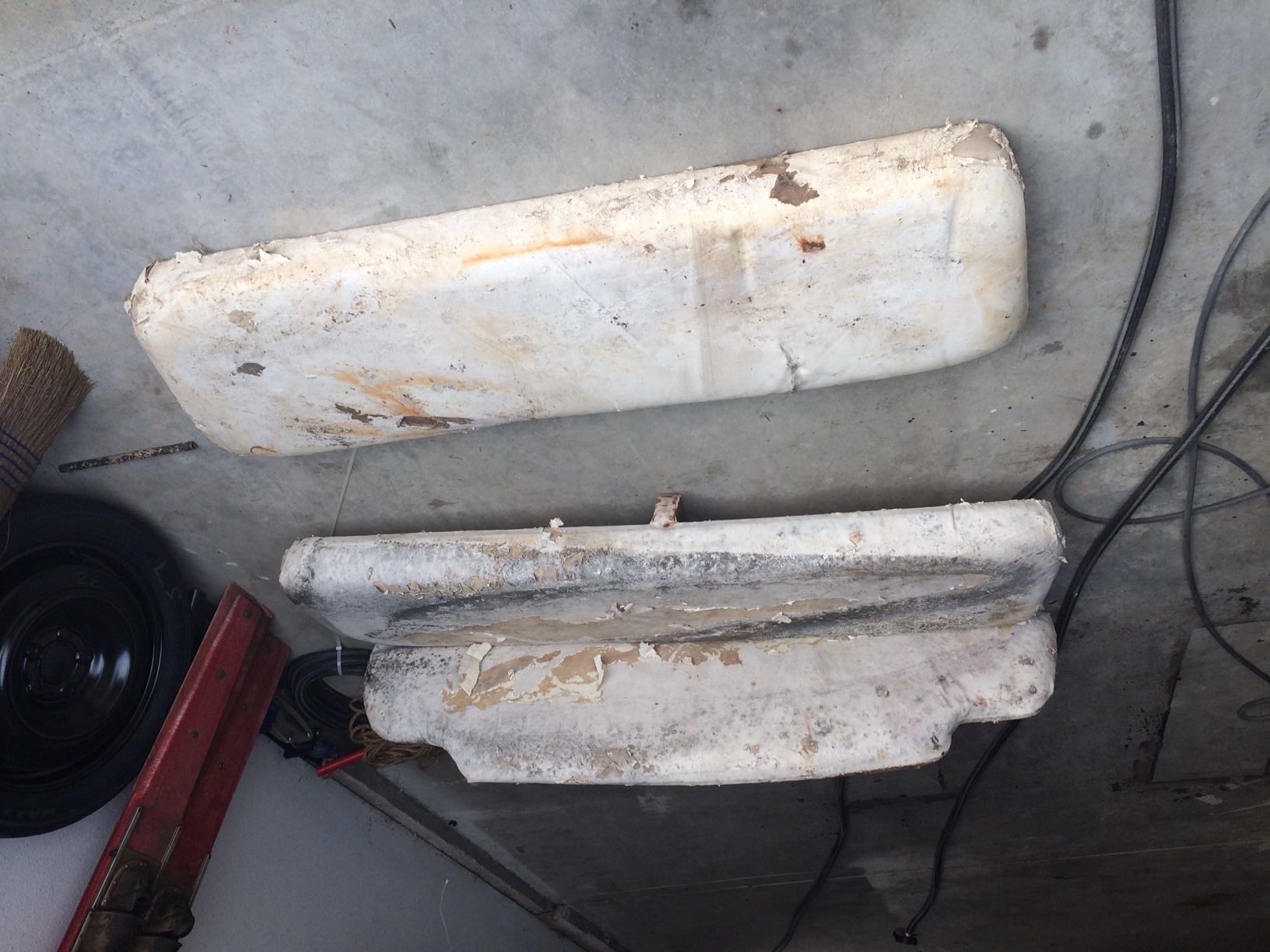

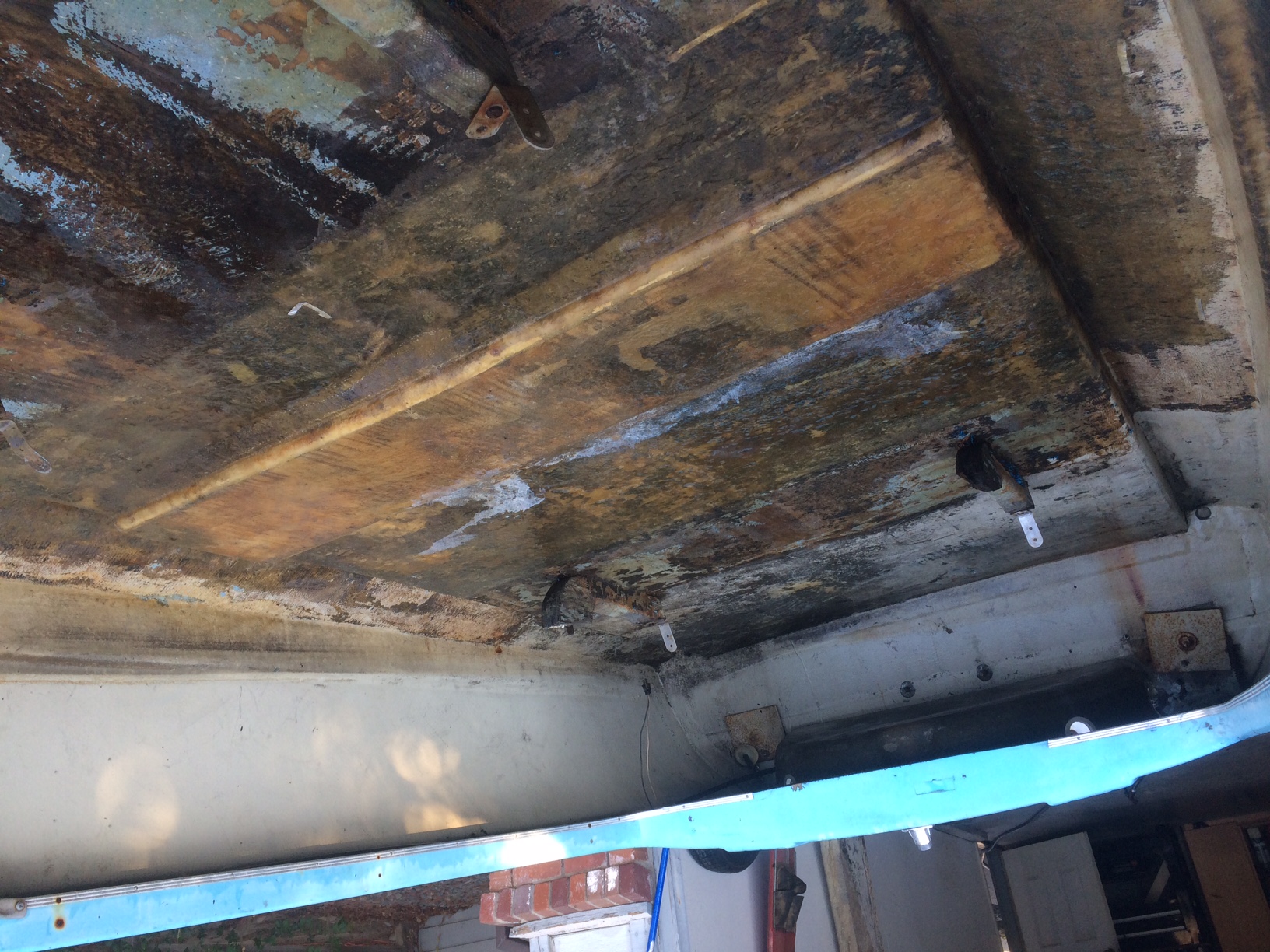

Newb. 9 years 1 month ago #133864
Here is the current condition of interior. I'm 99% sure I'm going with 1 gallon of Tuff Coat UT-100 (Med Grey), 1 quart of Primer CP-10, 1 special roller from Tuff Coat. I guess its a kit of sorts that they made me. $140 shipped to my door.
Hoping for more people to share there thoughts on my boat project with insights, criticism, etc.
I'm planning to be about $2k into the boat and trailer not including motor. My main goals at this point are making the boat as clean and sound as possible externally and internally before I add a motor and put her in the water.

Sorry about the upside down pics. I literally just tried 5-6 different ways of uploading them and they all show up upside down. SSSOOOO FRUSTRATINGG!!! :evil:
Newb. 9 years 1 month ago #133881
I think you'll be much better off with the tuff coat. It will still cause havoc if you ever have to do glass work, but I think it should hold up well enough over time that it may never be an issue.

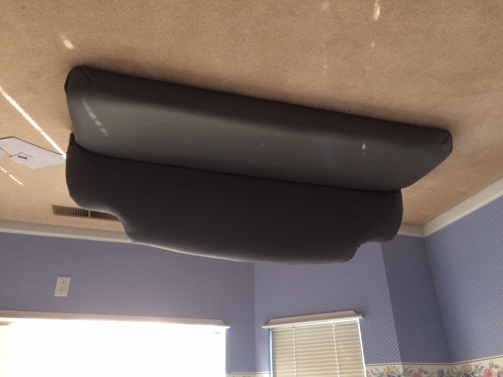

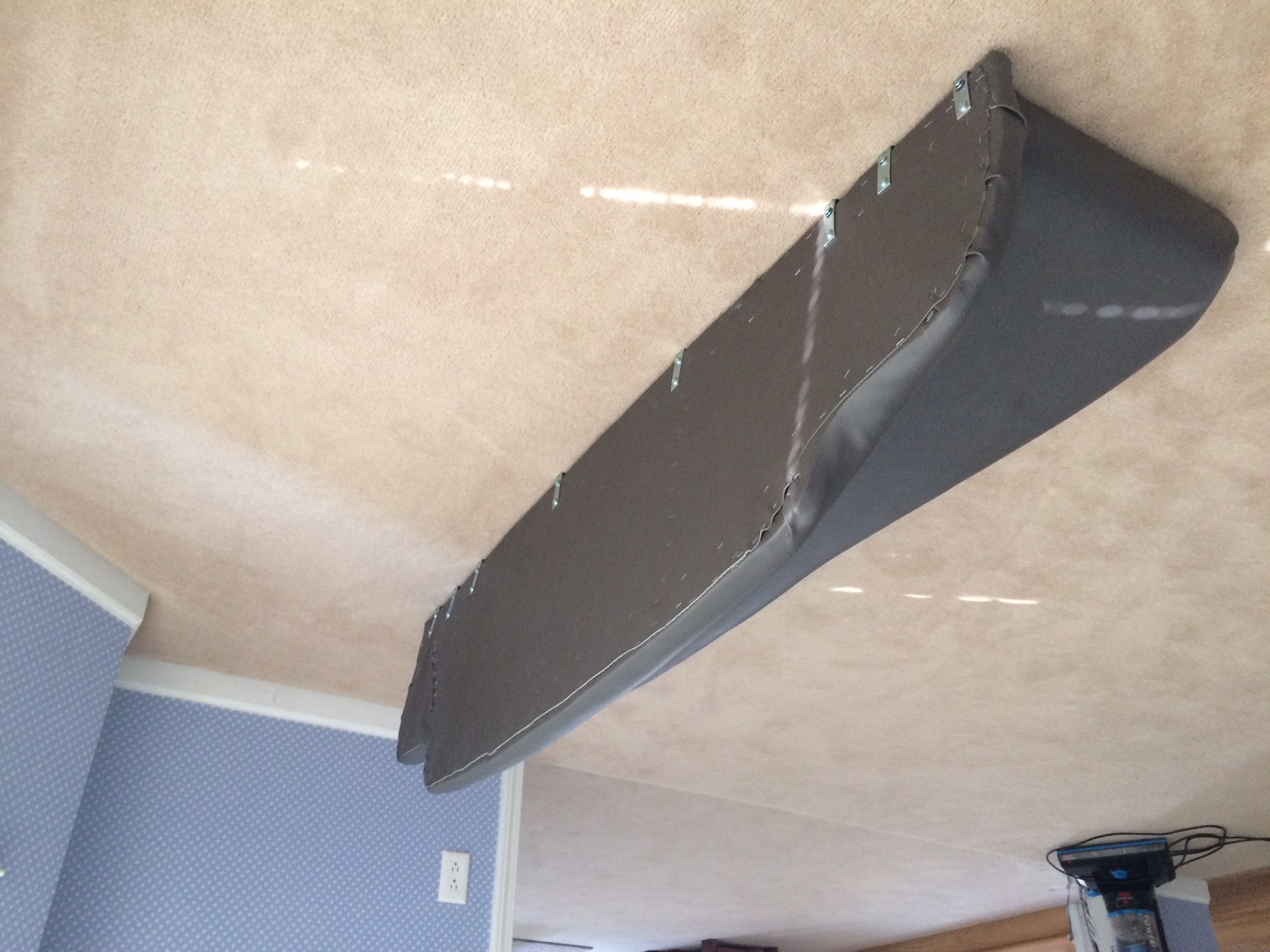

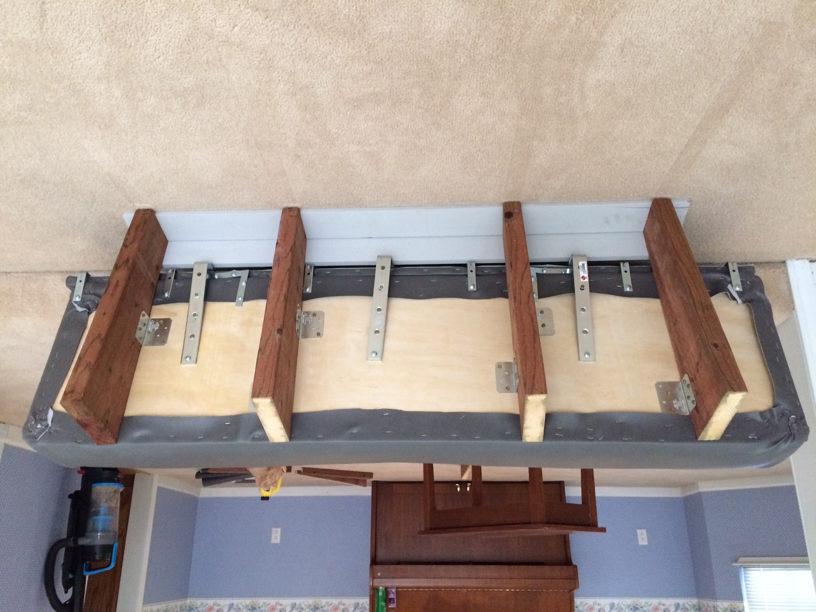

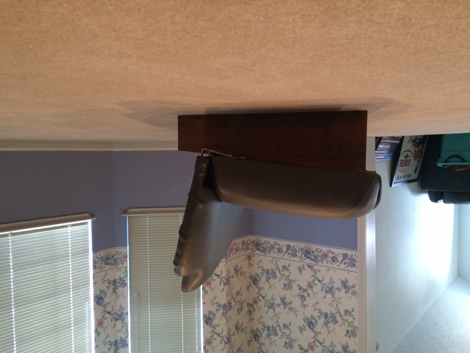

Newb. 9 years 1 month ago #133940
Rear bench re make.

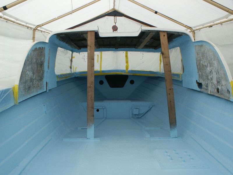

Newb. 9 years 4 weeks ago #134049
the tuff coat is the way to go , i used it instead of carpet, soft on the feet i got the flex option , light blue and i bought several gallons and primer, follow instructions and you will be happy. if you tear it up, grind it down a little primer it and recoat it. i bought the texture sprayer from harbor freight works real good. sputters it out. its a two man job to spray. it. if you roll it get you a wide brush to get into the corners. roll a little then brush a little two coats is what i used three in the high traffic areas..

sspade wrote: Sorry about the upside down pics. I literally just tried 5-6 different ways of uploading them and they all show up upside down. SSSOOOO FRUSTRATINGG!!! :evil:
Both you and Dr. Go need to bump heads together to get the pictures right side up, time to huddle up :whistle:
Looks really good from what the pictures show. Now you have a good base to start with. Keep us posted.
Newb. 9 years 4 weeks ago #134056
looks great! How's it feel under foot? I'll be interested to hear what your opinions are on it after you're on the water for a bit. Coincidentally, I just saw a pontoon boat advertised locally that said the deck was redone in Tuff Coat.
