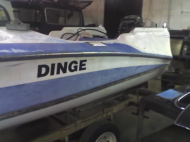

The photos need to be taken lightly.
I bought the boat in Iowa. I asked the fellow if the trailer could make it back to MN. "Sure we drove 85 miles on the freeway with it last week" So.....when I got here, I could wiggle one wheel almost and inch of wobble, the bearings were so bad. In haste, at 4:00 pm in De Moines, I'm running all over town trying to find a new hub. These situations always restore my faith in human life. People were helpful and I got what I needed.......on the far side of town.
The important thing to note is that the owner could not tell good bearing one from a wildly dangerous one.
Ysterday I removed the 3" black paste on letters proclaiming "HUMDINGER II" As a joke, until I get to the external restoration it now says "DINGE"
I sold the 1970's Johnson 40 to a buddy of mine who had a Chrysler that was on the fritz and needed some expensive parts to fix. He discovered they had been in the Carburetor and installed the wrong float which worked badly, but well enough to cause massive frustration.
I have a 1960 Evinrude Lark 40 with a 59 shroud that I just put on it last week. I still need to get it running. It has been lying around my shop for 15 to 20 years.
The boat is a mess. Full of pop cans, stale sun tan oil bottles, and leaves. The windshield was made from a piece of 1/8" Lexan rather than 1/4, but then someone used a chemical in it that made it translucent rather than transparent. The surface has stress cracks in the gelcoat and there are some scratches and a few other cracks in the structure here and there, but still much better than where I started with my 57 Falls Flyer! The Flyer had trees growing in it. I'm missing the plexi tail fin stern lights but I think some one makes them...(Lee, hint hint).The hardware is all there, and if I can get the motor to run I'm going to test it out yet this year. In spite of the nasty appearance, I think it is sea worthy.
I put forth this disclaimer..." This is not the world's crappiest boat....It is a restoration project."
[img] [img]http://www.fiberglassics.com/media/kunena/attachments/legacy/images/Dinge.jpg

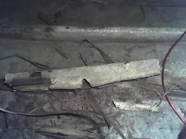

The transom may be sound, but I think this reinforcement rib needs replacing. Maybe I can get another year out of it. What do you all think. LOL

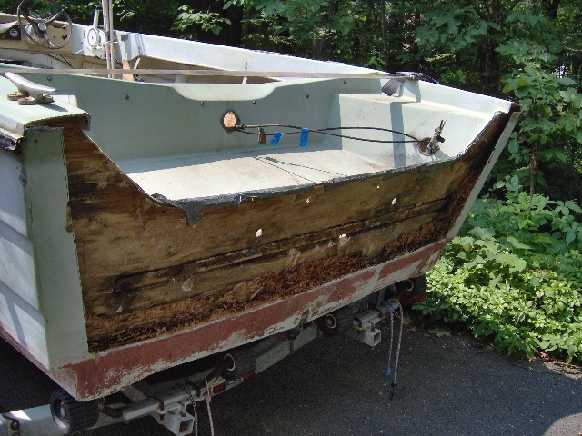

Re:Tramsom inspection for internal rot. 16 years 2 months ago #13289
You may end up going to the extreme like I did, but it worked.
