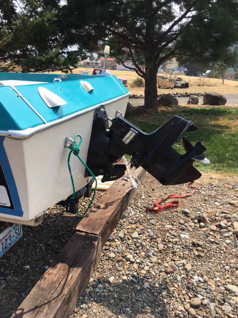

I have to agree. My 72 has a kicker. I bought a mount that goes up and down and mounted it on the transom. Some previous owner had done the same and had not plugged the holes. I put a 1/2 inch plywood backup on the inside, to keep it from deforming or tearing through the fiberglass, because my transom is not cored. No wood in there, it's solid glass. Doesn't look attractive at all but works. Oh yeah, I had to get a tiller extension for the outboard.
