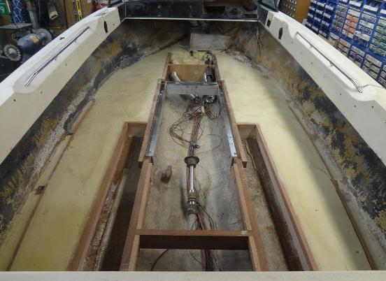

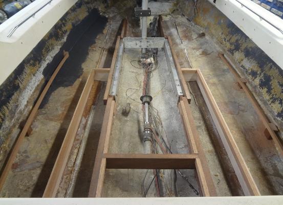

I cut everything away but leave about an inch of the fiberglass channels that held the stringers. Then I make new stringers out of either white oak or African mahogany, coated with CPES, and bed them in the channels with 3M 5200, making sure that they are plumb, level and match the original floor height. Then I add foam and cut it level with the other framework which has also been coated with CPES. After that, all is carefully fiber-glassed and I run the fiberglass about 4" up on the bulkheads so that it's impossible for water to enter. I have no idea how long the new stringers will last but it's for sure that this method is better than what the factory used when new. However, I AM sure that it will outlast ME!

Get lots of 1 quart plastic containers and then make 1 quart foam batches and spread it out as you pour. After it is finished expanding, pour in more where needed but be sure that the finished foam is a little higher than the framework.
Ah-Ha! So you want to know the secret of cutting foam level with the framework, eh? I use a highly technical tool: A 2' length of an old re-sawing band saw blade with Gorilla duct tape wrapped around one end several times. The saw is pulled to cut the foam, not pushed. Cut straight down about every foot or so and then cut out the 1' pieces one at a time. After all the cutting is done, a palm sander with 40 or 60 grit will easily smooth out any high or bumpy spots.
