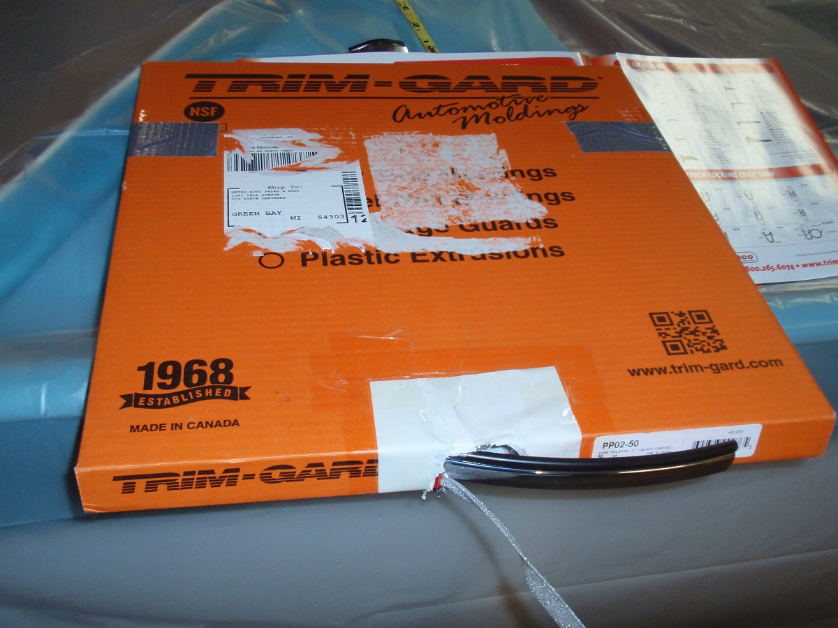

If you have a local auto store or supplier you can get press on replacement chrome that comes in 35=50 ft. rolls. Super strong press on adhesive backing that is used on cars. Come in any type of configuration. Here's what I used on my Shell Lake.

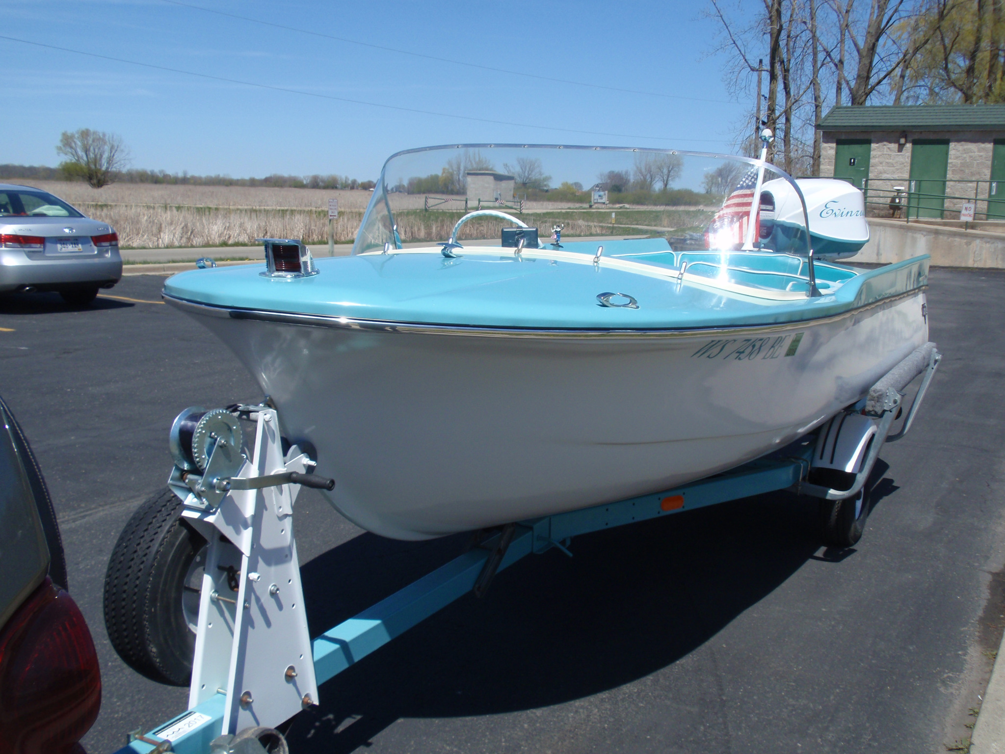

The Larson boats of that era were built to last and quality was good. That being said if it was stored outside or has any holes in the transom or floor you can almost bet that the floor needs replacing and the transom could use some help. When you stand in it does the floor flex?
That boat in the picture had more cosmetic repairs than anything else, the hull was good but there were large holes in the bow top and dash panel that were filled. Over the years I have hundreds if not thousands of pictures during rebuilds and there are plenty of folks on the site that are more than willing to help out with any situation that would arise. EVERYTHING has been covered at one time or another. Just ask away.
