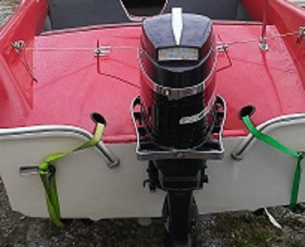

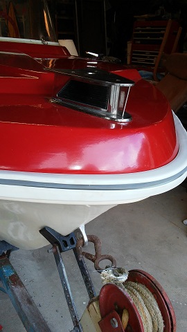

Found another Wefco Rubber profile that seemed pretty close to the original based on my memory. It is number 1515.0 in white with a gray insert. It is a little thicker but looks great installed. Had to shave about 1/4" off the back at the ends so the cast aluminum end cap would fit flush to the transom. I'll try to figure out how to post pictures.
'59 Cutter Jet DeVille Rub Rail 9 years 3 weeks ago #134160
First attempt to attach photos.
