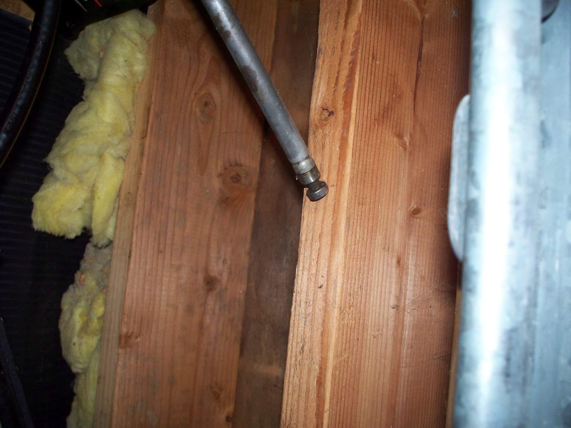

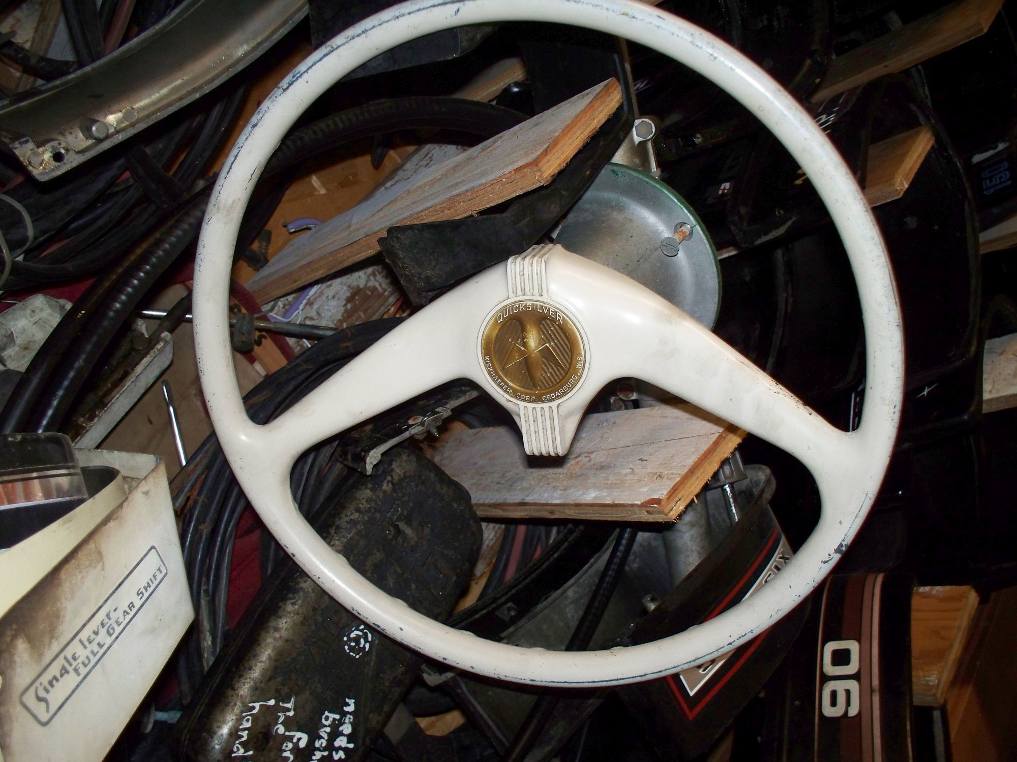

Is your set up like these attached pictures?
I have a couple extra long ones, if they are like what I have in the pictures.
