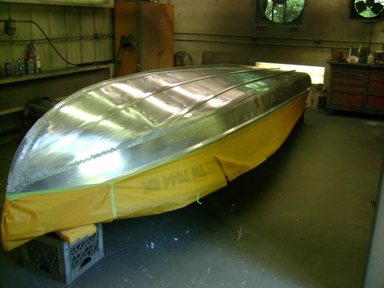

Here are a few more.

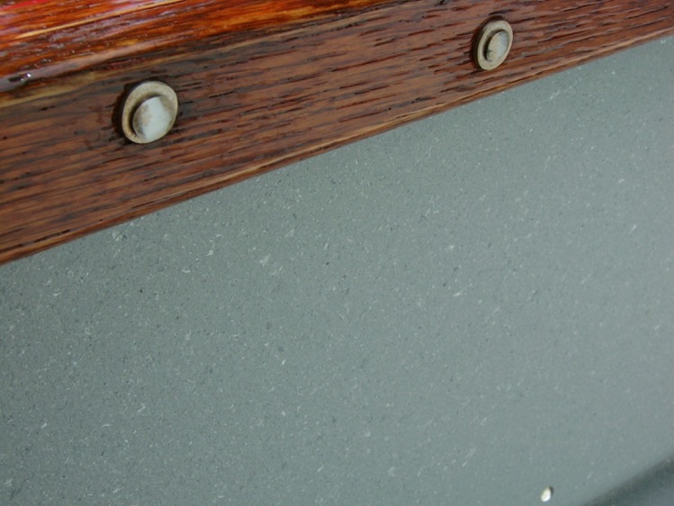

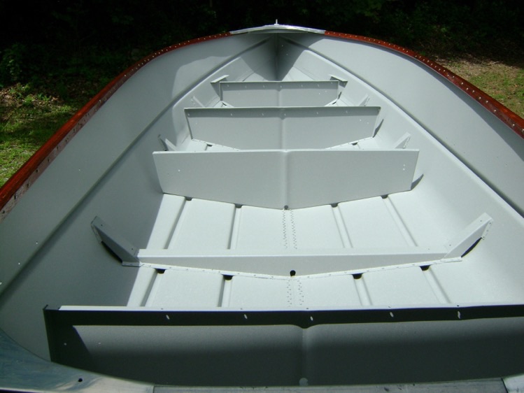

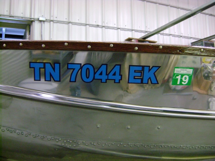

The paint inside is Zolatone with a self etching primer applied first. It has a non slip surface to it.

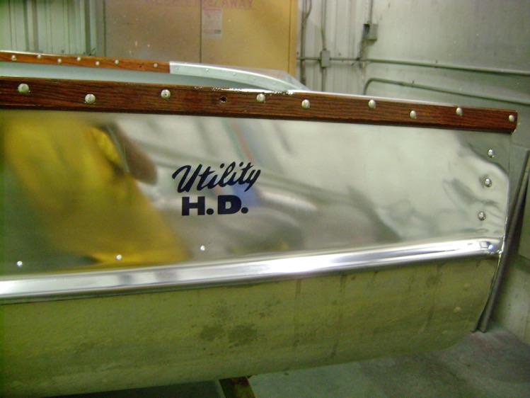

The wood is oak on the gunwales. That is a red pinstripe on the raw aluminum edge between the wood. It's going to match a later paint scheme. This boat has air bladder tanks. We had planned to add flotation until we found these.

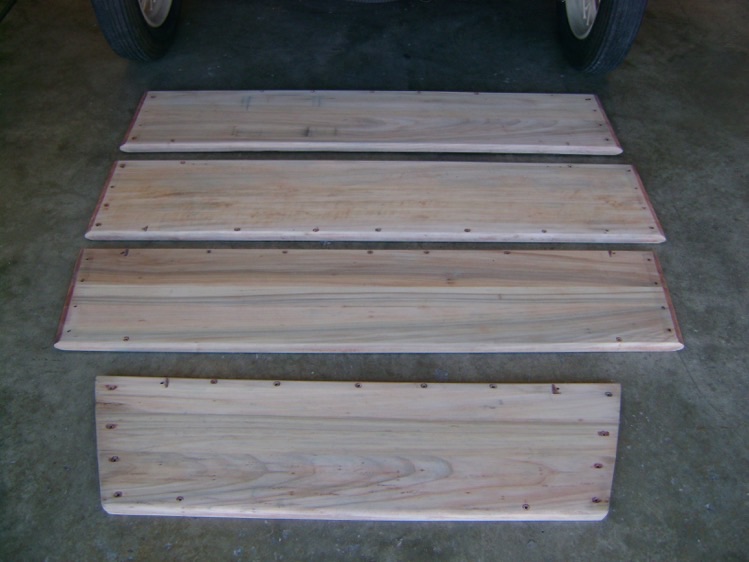

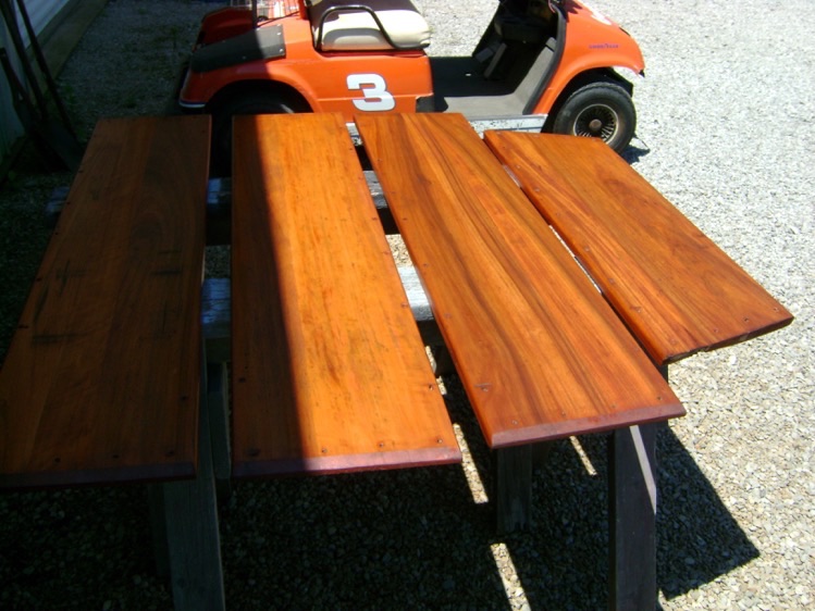

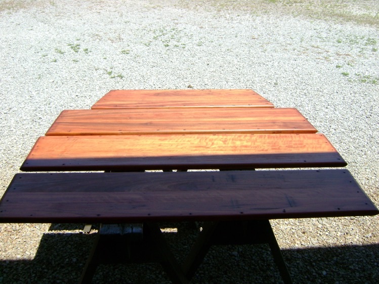

The seat bottoms had some splits in the ends. Those were repaired. Then the wood was stripped, bleached, re stained, and coated in varnish for protection. We discovered what we thought was mahogany was in fact tulip poplar. Surprise!
The aluminum in this boat is in very good condition.
