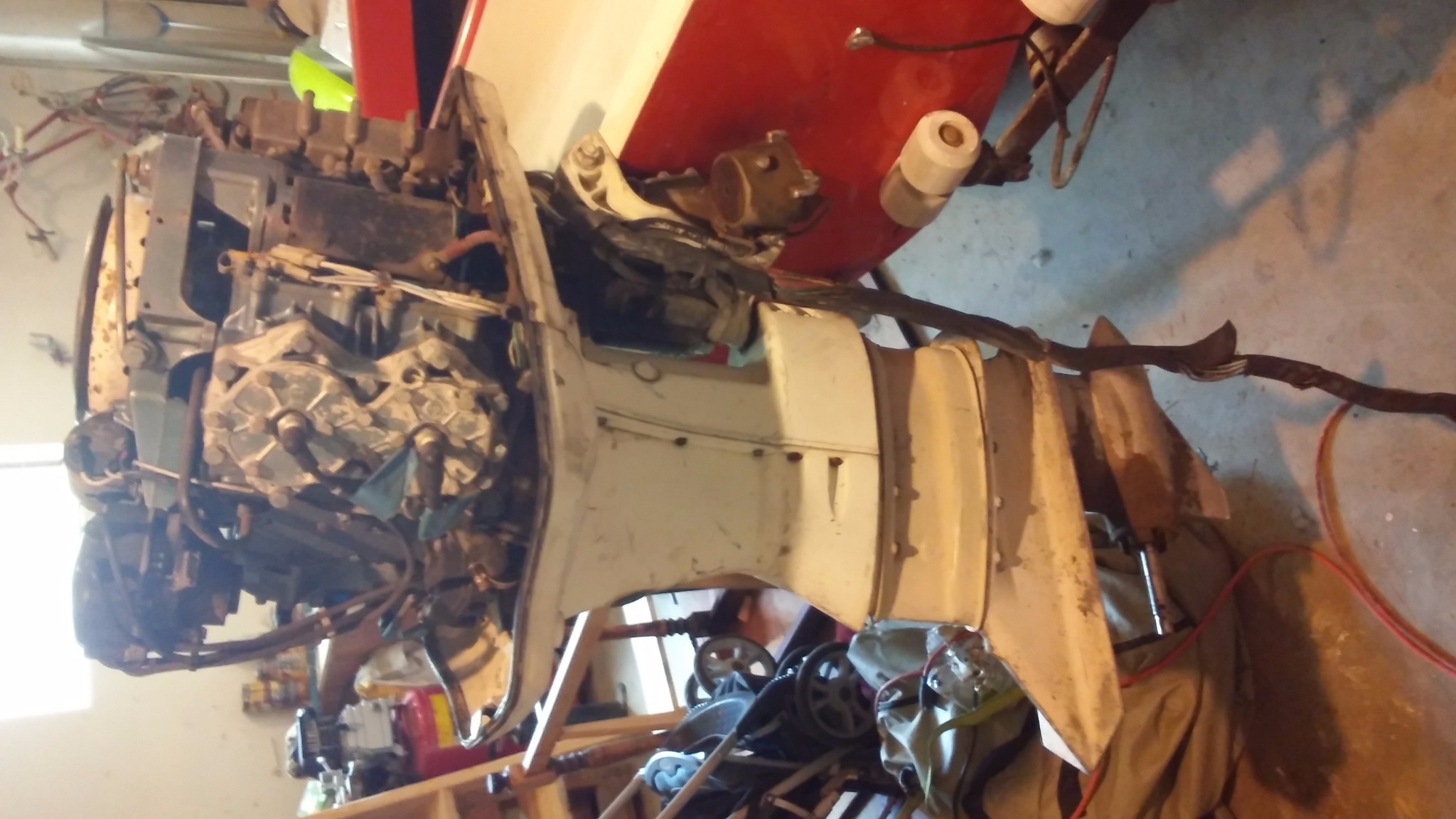

I have a new project!! Picked up a 1968 Jolly Rodger. It did not come with the 125 Merc that was originally on it. I have a 1964 Johnson 90 h.p i plan on putting on it however the motor needs some work. I hope to have it on the water next year. I will be in need help finding the missing pieces for the motor. Currently I am in need of an engine cover so if anyone has one please let me know if you would like to part with it.

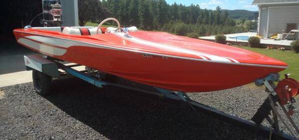

Getting some parts together thanks to some members of this amazing site!! With gitting the running Bayliner the work on the Jolly Roger has slowed but still making progress. What do you think i could expect top speed wise with a 90 h.p behind this boat? It's a 16 footer and will only have a max of 4 people in it. Most of the time it will only have 2 in it. I was hoping to get it up to about 35-40.
1968 Jolly Rodger 9 years 2 months ago #133174

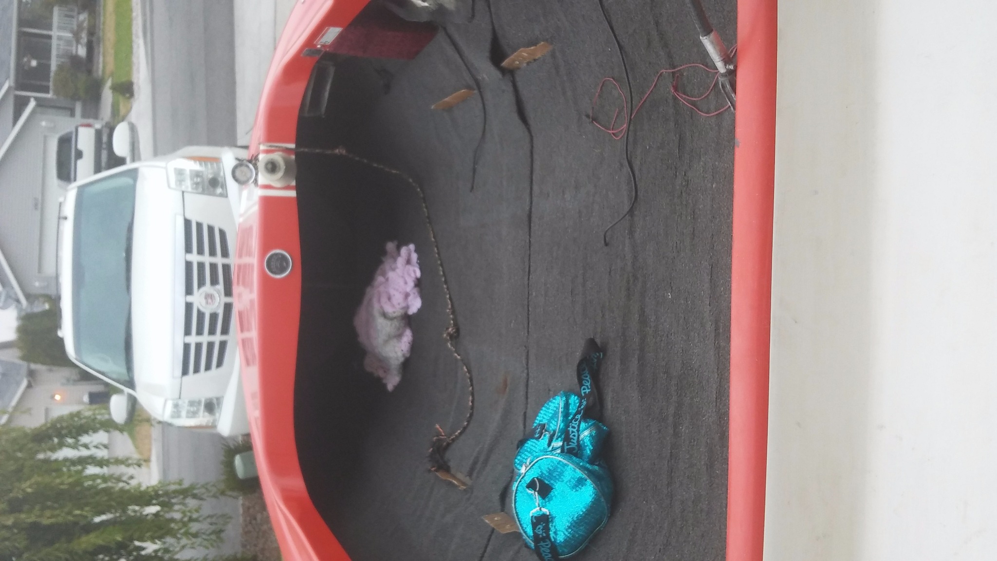

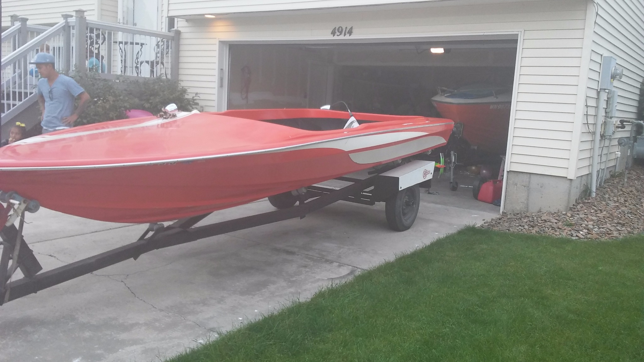

This was the boat when i got it. I paid 300.00 for the hull and trailer and 50.00 for the 1964 Johnson 90 h.p. I got some transom mounts coming from New York and have info on a cover from California.

Though I am not an OMC guy, that boat and 90hp with that lower drag pointy gear case would hopefully add up to climbing over 40 with the right prop if the tilt pin setting allows for a little less hull to be in the water. The plus side is you already get 30-35mph credit for just sitting on the trailer the way that thing looks. One of those all silver 135hp Strangler Evinrudes from back in the 70' would be cool too. Likely if you picked a good all around prop that plains off 4 people and full gas and one skier, you may over rev with only 2 on board. The old struggle of what do I want more...power to pull skiers with a boat load or go faster with 2 people. I like a prop for going fast at correct rpms. I let my friends with the inboard boats pull the skiers if the job gets too big or if I don't want to change props. Their are experts on here with better answers than mine. Good luck and really nice rig!!

I'm not sure that the 90HP v4 will provide the performance you want, but maybe??
You'll definitely need part ownership in Shell, or Exxon, or Chevron, etc to run the beast.
If you are an OMC guy, you would probably be better off with a 115v4, or 140v4. (sharers of stock in the oil companies still required)
BUT
If there is even a trace of Phantom Black in your blood,...A 1973 through 1980 1150 or 115 Merc Tower of Power would make a nice choice for the Jolly Roger.
It would probably make it a 45+/- MPH combination.
If you jumped up to a 1973-1977 1500, or 1978-early 1979 1400, or late 1979 thru 1980 140, or an '81-'88 115 (all inline-6 Tower of Power beasts) you would be able to claim mid 50MPH speeds, but with a high risk of dangerous chine-walking at 55MPH +/-.
