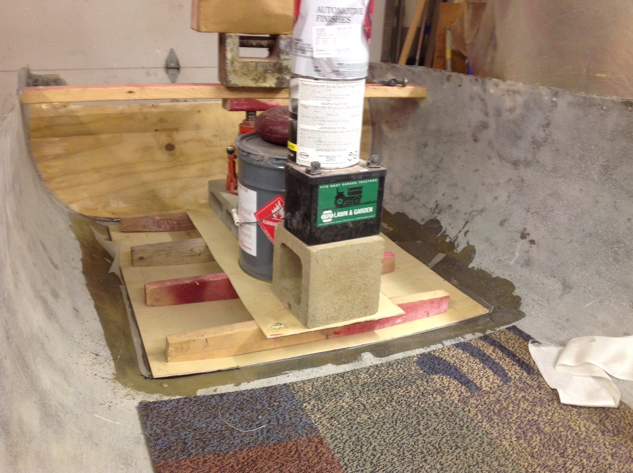

I will give it a shot here. I repaired a Herters Flying Fish once that had a very bad hook also.
So I ground and cleaned up the inside. Then traced the arch or bottom of the transom on two by fours I made four of these then screwed some quarter inch plywood to that to get the right shape. Now get every thing ready. To lay glass. On the inside I cut glass about the size of the plywood. First layer cloth then heavy roving then heavy mat then another layer of heavy roving Heavy mat then over lapped the whole works with cloth. Lay this all one layer at a time then set your wood template on the wet glass and start stacking as much weight on it as it takes to get the hook out (you might do a test before you lay the glass to see how much weight it will take. It took a lot of weight for me but I just layer her on. ) yes that is a hydraulic jack I cut a two by and screwed to the sides and put as much pressure on this as it would take.
Forgot one step before you set the wood on cover the glass with wax paper or some plastic or the wood may be very hard to remove.
D

Terriffic Mr Herter! I had thoughts of glassing in a couple U shaped wood arches with a ton of weight to hold them in position. I like your idea better. Big question; did it work?!

The dreaded HOOK is bumming me out 9 years 3 months ago #132370
Yes it did work.

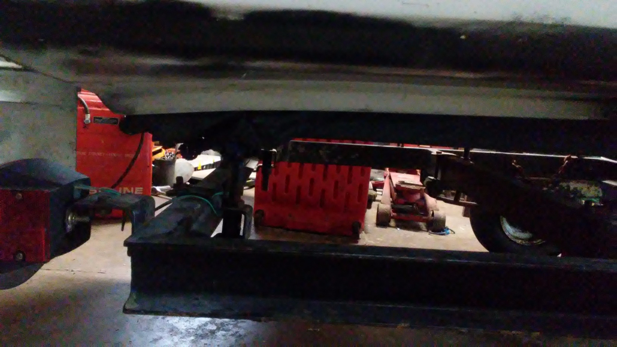

I had an 58 MFG that had a terrible one because of a warped internal wooden keel. I took all out of the boat and supported it at the back with a new transom support on the trailer. I backed the rollers down enough to make a straight line front to back. I soaked it in water over a period of time and let the weight of the water straighten it. After the weight of an outboard was supported and it dried out it went away.
