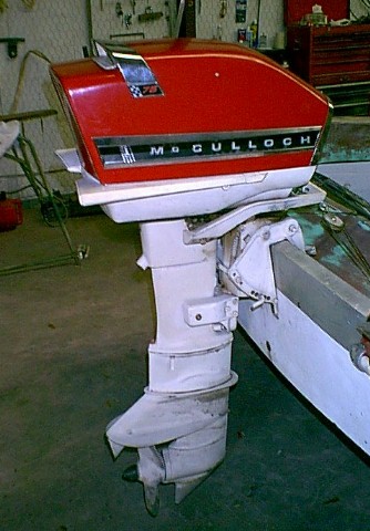

Top speed 9 years 4 months ago #132315
Flying Scott triple. 60/75hp. Going to land complete around 165lbs. Although I think the 75hp is rated a tad north of what it really is.
They look super cool too (I think). Easy and many 'correct' color options for the cowl.
On the downside MUCH harder to find a complete motor, parts though available harder to come by as well. Not as easy to work on as an OMC but a tad easier (again my opinion) than a Merc.
my .02 cents.

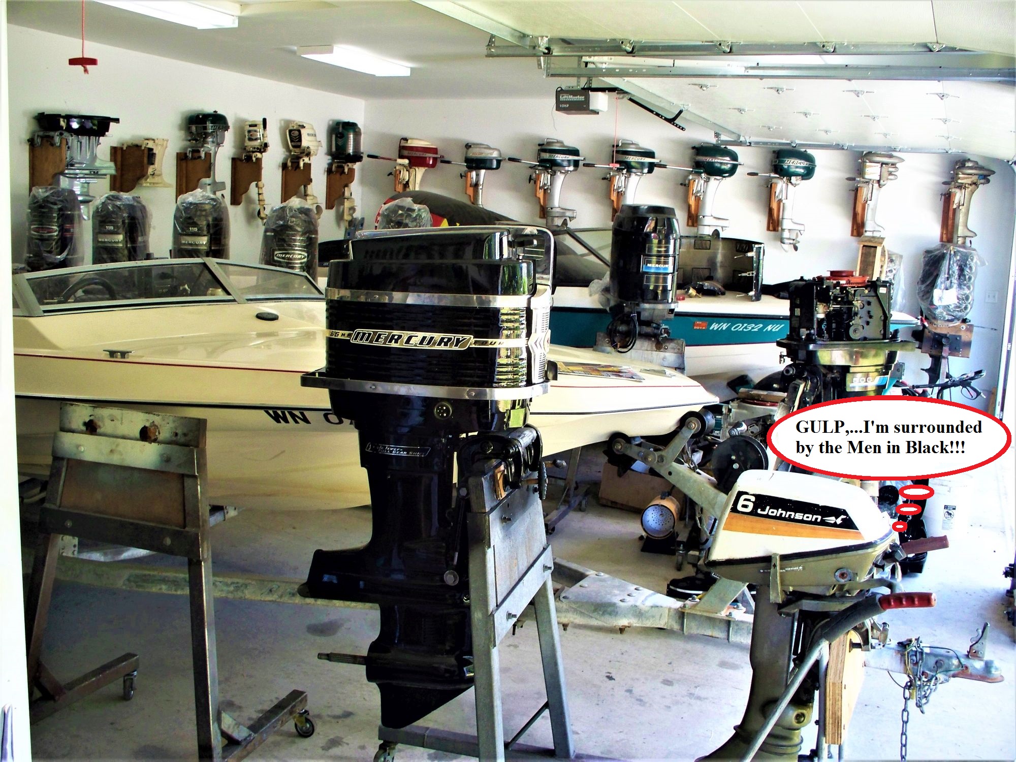

Here is a nice 65 HP Merc I've just finished updating the maintenance on and gave it a cosmetic restore.
doc
