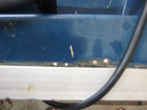

I was just cleaning the aluminum on my boat and noticed that the right side of the transom looks like it is seperating from the back! How do i fix this?

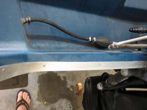

heres another pic of the right side, closer to the engine.

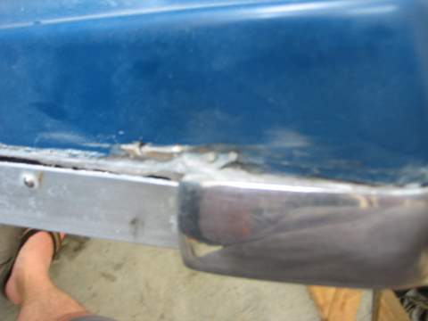

And here is the normal left side

Hopefully one of the guys/gals with more experience will correct me if I'm wrong here, but I believe that is a sign water has infiltrated the transom. The wood is probably absorbing it and expanding, probably rotting. Think I'd be for checking this out by pulling any hardward mounted back there to see what the wood is like inside the mounting holes, and poke around with a screwdriver down in the crack and on the inside to see of it's soft and mushy. The wood also usually turns black if it's been exposed to water and starting to rot. You can also do the "knock test" where you rap the transom, solid wood will ring back where rotten wood will be more of a dull thud. I hate to be the bearer of bad news, you may want to get some more opinions, but I'd sure check it out pretty soon!
Re:IS MY TRANSOM SEPERATING? 16 years 2 months ago #13128
Pull that aluminum trim off and see what it looks like underneath. Chances are, you got some water in there but doesnt necessarily mean your transom is toast. Pull the trim off and start poking with something pointy...an awl works good. If you find rotted wood, dig it out and see how far down it goes. If its just a small amount of rot, you can dig it out and fill it in with something like SeaCast or a mixture of resin and glass. If the woods really soft all over and just coming out in chunks and it covers a large area, its time for a transom replacement.
