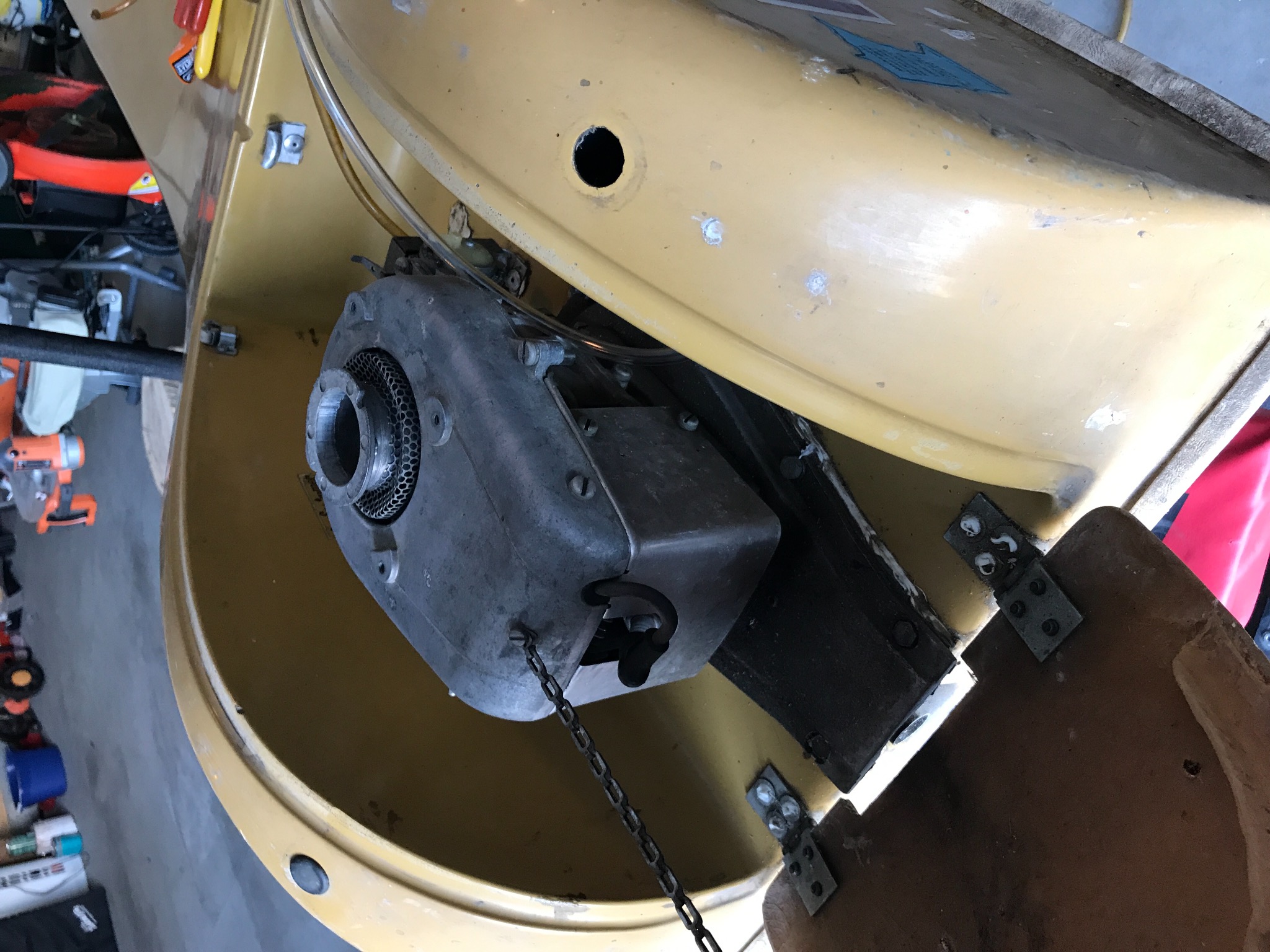

So, not a boat...but a classic powered surfboard from the late '50's early 60's. I just picked this up and it does run and appears to work! I have some repairs to do before it goes in the water, but...its mostly all there. It is missing the starter recoil...which I'd lover to replace. (Looks like I need a better engine picture.)
Does anyone have any info on the motor? From what I've been able to find its a West Bend 1 Cyl, 2 Stroke Go-Kart engine adapted for the Surf Skimmer. Photos attached. There are only a couple videos on Youtube...we plan to use it as intended and we'll see if its any fun!

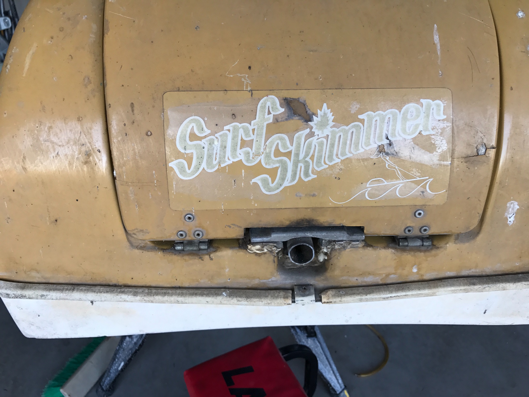

It's a little jet drive. There's a grate/intake under the board and it's pushed out the rear. It's supposed to have a bulb of air that you stand on, that expands a diaphragm that opens the throttle.
Pictures atteched!

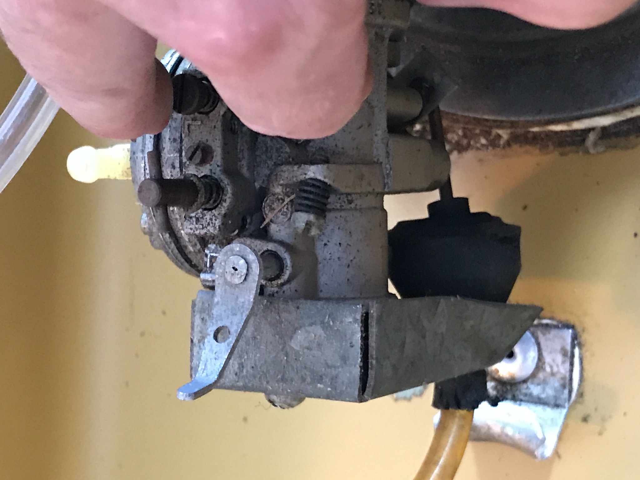

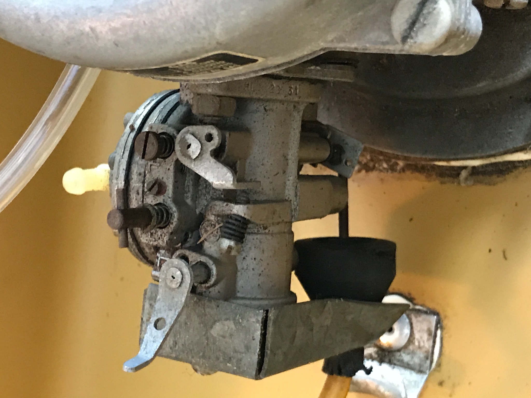

So...an update. The engine is free, carb is good to go, have a nice mix of oil/gas into the clyinder. Coil is dead.
Any ideas where I can get a Wico x13313D replacement coil?

Well, it took a bit of digging to find the right coil to replace the fried original one...but after some research, I got everything put back together and we're all set for the 4th of July!

I do feel it should wind up higher...more RPMs. But for this week, I'm happy with it.
1959 Surf Skimmer 9 years 3 months ago #132641
If the carburetor has an adjustable main jet, it will need to be adjusted with the engine under load in order to reach the max RPM.. You may have to improvise a way to tie it off in shallow water so you can stand beside it while setting the main jet.. With the throttle wide open, back out the jet to richen the mixture until the engine starts to misfire, then lean it out just enough to eliminate the misfire.. On older two-strokes, it's always best to have the main jet set a touch on the rich side to keep cylinder temps in check.. A lean mixture will burn hotter and you will run the risk of melting a piston when running wide open..
