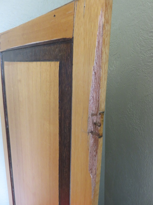

Hi Bob here our those pics of the damage. my thought was rip the bad section off from top to bottom. Then dowel pin and glue new piece on. That's where matching the wood comes in.

We also have a "Glasspar Seafair Sedan" and ours is a 1960. Glasspar used Honduran Mahogany on all their cabin doors as well as much of the trim boards. Our cabin door is just like yours, hinged in the middle so it can fold down. Our original cabin door was in real good shape when we got the boat, but we had to replace some of the other mahogany boards and were able to find a company where we live that had the mahogany needed.
I hope that helps you some.
It's all about the wood, door that is. 9 years 4 months ago #131948
Roy,
Yep it's Mahogany and your idea may be easier said than done. Those are raised panel doors that were made with a rail and stile bit and the inner panel "floats" inside the door basically. You could still rip just to the edge of where the wood splintered off and glue a new piece on, provided you can match up the grain as close as possible. Forgive me if that's what you meant in the first place. lol This may be the easiest way to go as you probably won't get that rail off the side easily and unless you have the right router bit for the profile on the rails and styles you won't be able to match.
So cut it off up to the splinter and glue on the new thin piece that replace it. You won't be able to dowel it since that piece won't be very thick. Heck you won't even be able to biscuit it either. You'll just have to clamp it lined up just right. Hopefully you have some bar clamps or even some pipe clamps so you can lay the panel on the pipes to keep it flat and clamp the piece to the panel. Not sure how much wood working background you have and what you have for tools.
From the color of the outer wood surface it almost looks like it was bleached as the wood should look like what's exposed from the splinter. Of course that could just be from the sun bleaching it over time since it may not have had a good UV protective varnish on it.

Thanks Bob, yes, right to the edge of the splinter, and you're right the door is thin but maybe two or three small diameter stainless or aluminum pins instead of dowels. Something to help hold the 58 year old door together. LOL Thank you for your help on this. I'll let you know how it comes out. Roy.

Might as well jump in here...the paneling is sapele. The frame looks to be Philippine mahogany, which is basically unavailable these days and why I use African mahogany for everything. Of course, you could use Honduran (genuine) mahogany...if you can find it and choose to afford it.
I wouldn't even attempt to match the type/color/grain. I'd remake both top and bottom frames using the old pieces for patterns. That bulkhead and door is the showpiece of the interior. Replacing both frames is more work and more wood but you'll be happier accepting complements for the finished job than apologizing for it.
P.S. Make all 8 pieces from the same plank.
