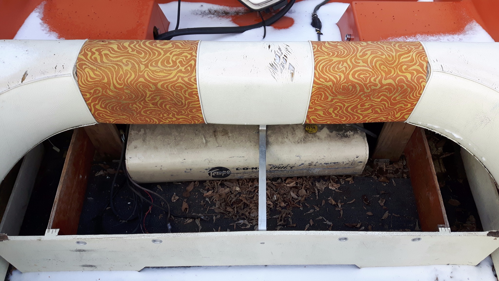

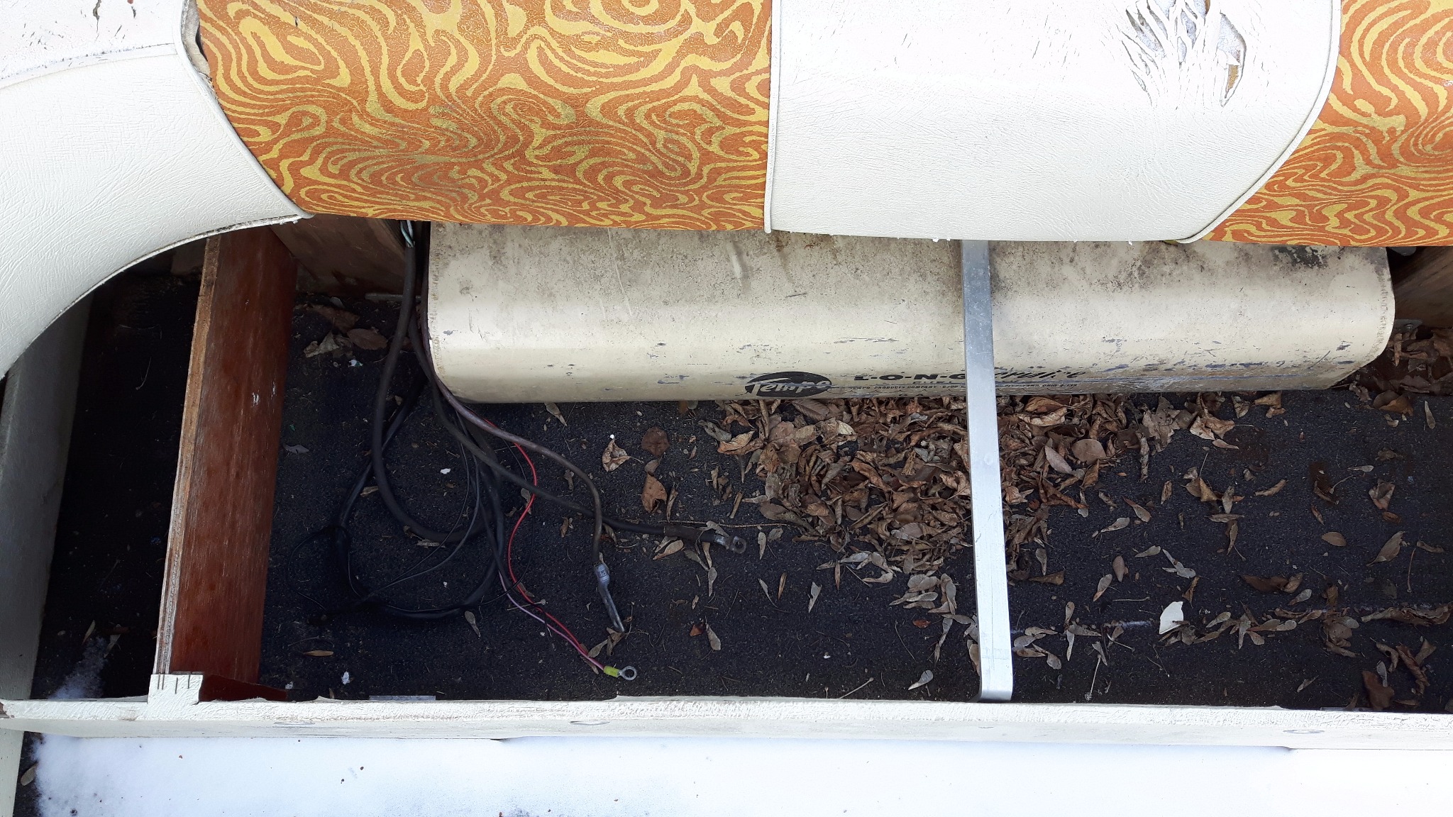

Hi, I am working on our 1971 Larson 165 Shark. I have to buy a battery for it. The cables run under the stern seat, but that's where the onboard fuel tank is located, so I'm thinking that's a bad spot to put the battery. Does anyone know where it is supposed to go?

Thank-you, mate! Good point! Here are some pictures...

I think the battery would be just fine in that area if you get the proper plastic case and anchored it down with the supplied straps and cover.
A word of caution though. Check that gas tank especially look inside with a flashlight or something. Those steel tanks have a real tenancy to rust and plug up your fuel lines and filters....don't ask how I know.
1971 Larson 165 Shark battery location 9 years 5 months ago #131530
Ditto. I have a 12 gallon steel long cruise tank in the same location. Mine came from a friend who took real good care of the tank so no problems. My original Larson tank located in the bow ,looks great but the inside has over an inch of crap in it and a small amount of visible rust. it will cost more to clean and treat it than to replace it with a new plastic one.
