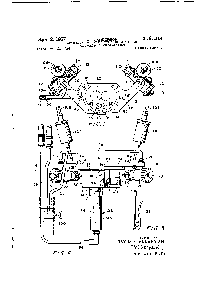

Larson Boat Works of Little Falls, Minnesota first used the “Rand Gun” chopper in 1957. They were working with Ingersoll-Rand Company in the development of this first mix/chopper. What it did was cut a continuous strand of fiberglass to whatever length you required, mix the resin and catalyst, and blow this mixture into the mold at a set air pressure. At first they had exclusive rights to use this apparatus, but soon other manufacturers got in on the deal. The patent was applied for in 1954 and was published in 1957 and was awarded to David F. Anderson, assignor to Canadian Ingersoll-Rand Company Ltd. Larson used to put a small decal on their dashboards declaring that the boat was built under U.S. Patent No. US2787314. The use of the gun greatly reduced the time spent laying the fiberglass up in the mold, increasing production. By the early sixties most all of the manufacturers were using the guns, in one form or the other. The smaller manufacturers continued to use the hand layup process, as the equipment was quite an investment. Binks Manufacturing Company were quick to follow on the Rand Gun concept with a similar product. Quality issues? That depended greatly on who was manning the gun. I worked for a fiberglass manufacturing company in the late sixties and the operator made all the difference in the world. A lot of people thought that they knew what they were doing, but were nothing more than “gun pointers.” You had to get the mix correct, lay the mixture evenly, and have skilled rollers in place to lay the mat down. People today seem to believe that hand layup produces a superior product due to the horror stories out there concerning chopper guns, but it was all dependent on the operator and the specifications used by the manufacturer. MFG, of course was the exception with their die formed hulls. With the investment required in tooling, as well as a 750 ton hydraulic press, this process was way beyond the capabilities for most manufacturers. The Aircraft Division of GoodYear also produced a die formed hull that was used by Bowman, out of Little Rock. I believe that they also used this hull in their early Geneva boat line. Very similar to the VEC technology used today by Larson boats. Nothing new, just a replay from the past.

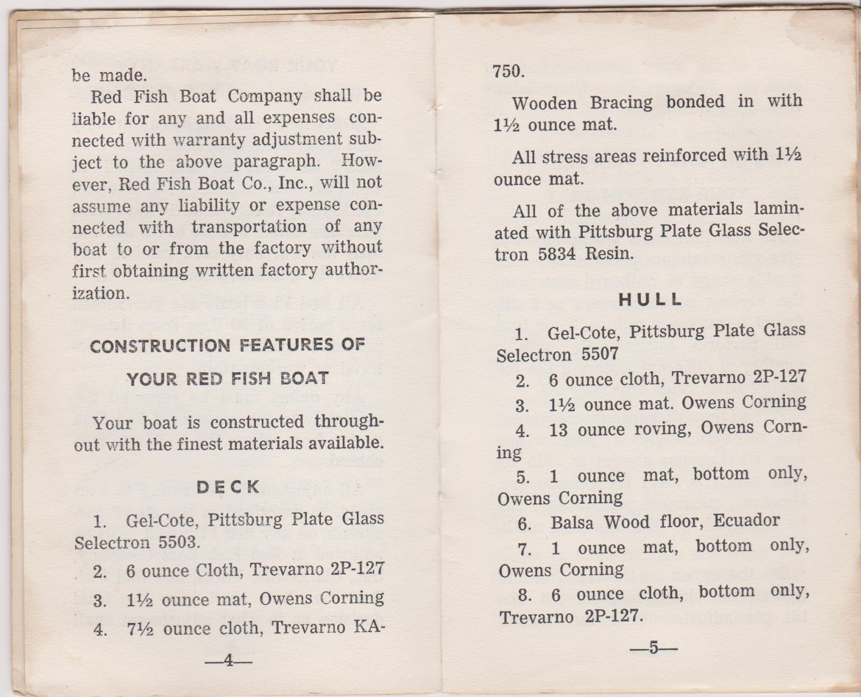

from a 1959 red fish owners manual

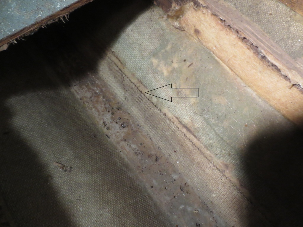

I saw a 57 Glasspar Avalon recently that had gash in the hull below the floor. Upon closer inspection it was evident that the matting was not properly overlapped at that location.
