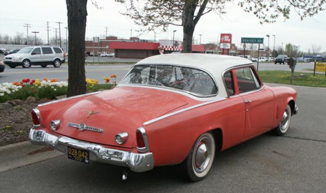

I find mention that it is a Studebaker rear window... it certainly looks similar to them.
Re:Windshield for Glasspar Club Mariner 9 years 6 months ago #130322

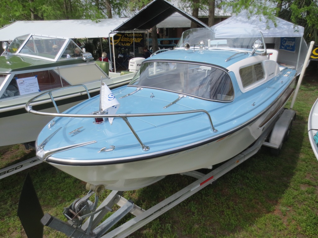

Studebaker it is, as well the windshield in the Glasspar Delmar is the studabaker window

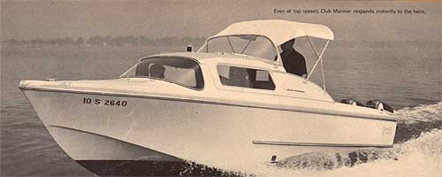

Our friend Eddie Grijalva wrote the book “Glasspar Boat Builder: Circa 1952-1962". According to Eddie, in his book he mentions, Glasspar used a Studebaker Champion rear window to form the mold for the new 1956 16’ Delmar windshield.
I believe it was a 55 Champion and recall reading they bought a truckload of the glass. It appears to be similar to what was used on the Mariner which was introduced in 57.
1960 Club Mariner which was the last year for the Mariner.

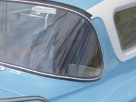

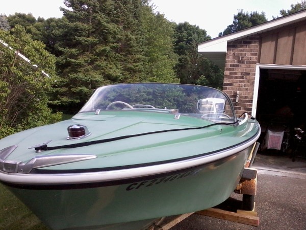

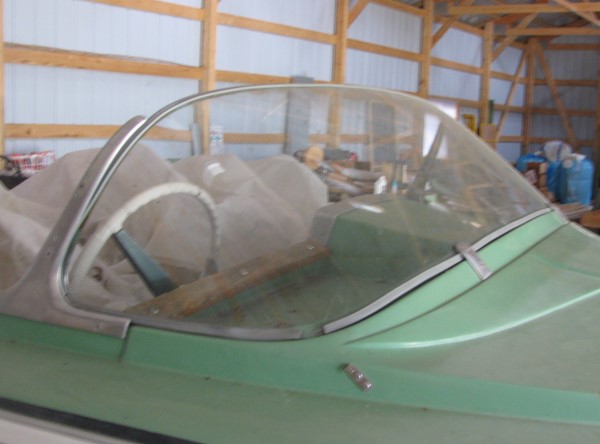

Here is a picture of the busted window, with my not-so-heavy friend who's weight shattered it! Memo: don't allow anyone to walk above new window, once installed...
It's a 1958 Club Marathon. Solid hull but needing a good paint job and interior work. I don't have the upper windshield, but I also have a 1960 Marathon that I am considering swiping the windshield from. We'll see, not sure it will fit well up there.

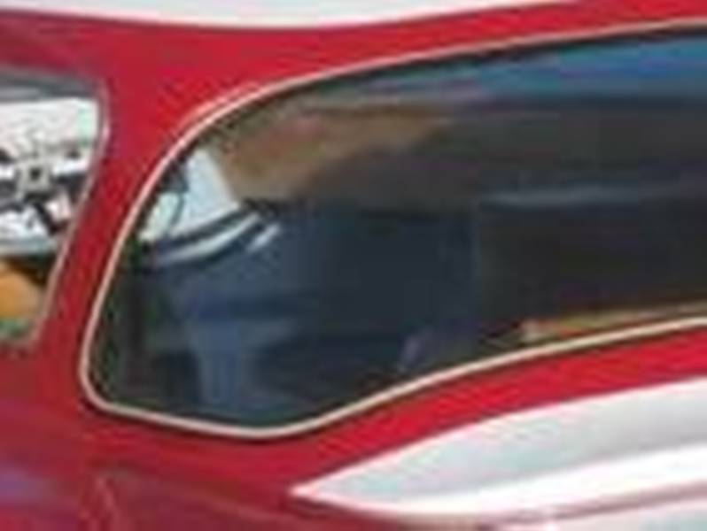

I am concerned that the rear windows from the Studebaker Champion are slightly different than my windshield. It appears in the Studebaker photo and the DelMar photo, that the bottom corners of the window have a flat spot along the bottom edge. I don't see that same flat spot in the Club Marathon window.

Beam on the Mariner is 10" wider than the DelMar; gunnel looks similar on both, don't think they could be the same windshield.

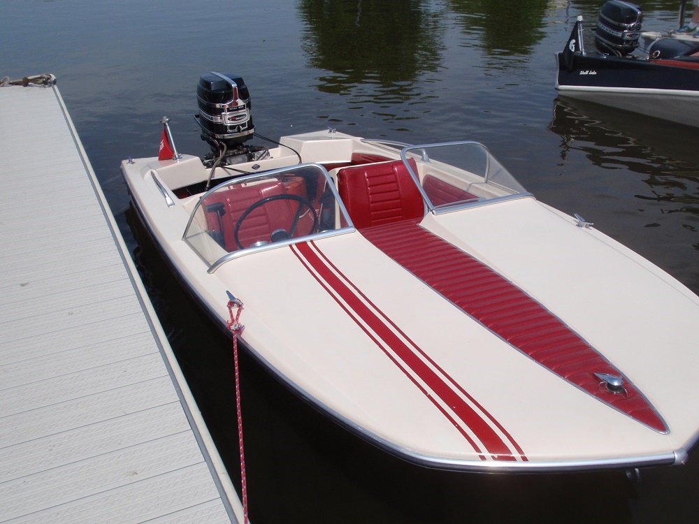

Jet, Some different pics you might want to use for your avatar.
Never realized how close you come to sinking from a fast stop backwash :laugh:
Re:Windshield for Glasspar Club Mariner 9 years 6 months ago #130433
Those are some great pictures, thanks for sharing!

Looking closely at the bottom line on the ends they do appear to be different.

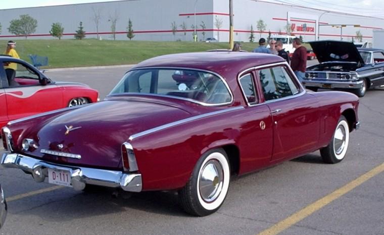

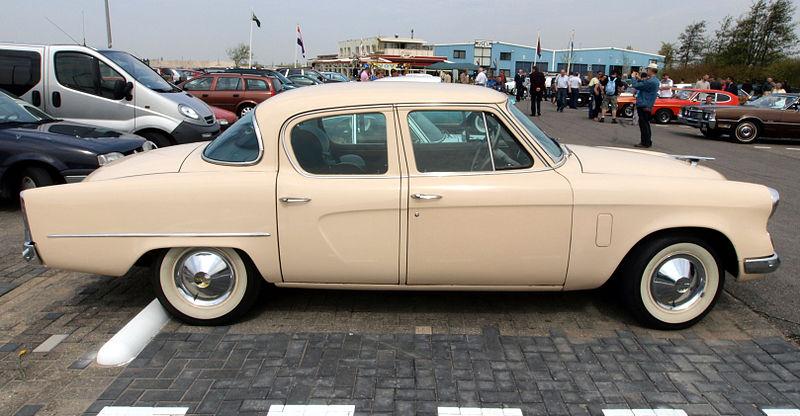

I used to own a '55 Studebaker Commander and that Del Mar / Mariner windshield looks very familiar. Yet it has been bugging me for years because I too noticed that they were slightly different. Maybe I have an answer now. I am sure that Eddie G. is right, the Del Mar windshield came from a '53-'55 Studebaker (champion or commander) rear window. These were the bodies designed by Raymond Lowey and they were the slickest looking cars around back then. No wonder Bill Tritt used them on the super slick Del Mar ('55) and later on the Mariner ('57).
But the Mariner windshield is different so where did it come from? Checking some old photos of different Studie models, I noticed the aft body shape of the 4 door sedan bulges slightly to accommodate the extra doors. The rear windshield on the sedan looks to me like it does not have the "corner" like the 2 door version.
My take then, is that the Del Mar got the 2 door rear windshield from a '53-'55 and the Mariner got the 4 door version. Maybe the same glass was used in later Studie models too which could be why they all look so similar.

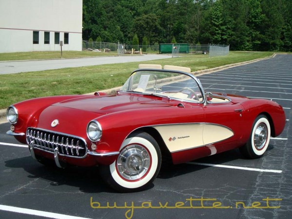

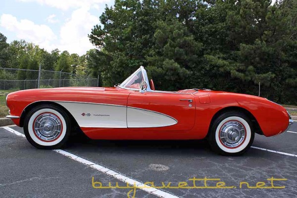

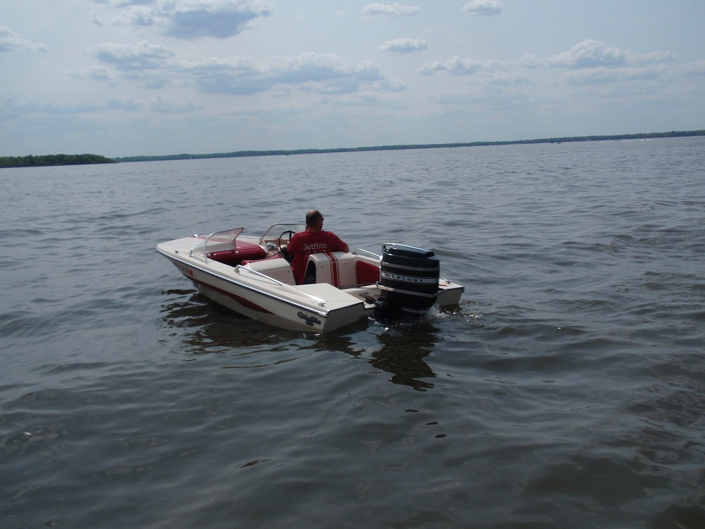

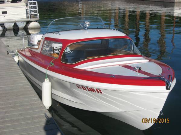

Just to add to this thread I was told and believe that the Glasspar Trident windshield was also from a model of the Studebaker. The photo attached is an old photo of my current 1958. Some stories say that it is from the Earlier Corvette which make a better story but probably not true. It is very nice to have an actual original glass windshield on a boat of this vintage.
Re:Windshield for Glasspar Club Mariner 9 years 5 months ago #130660
well my story is true my boat was made by the company that did make the early corvette bodies .. i wanted to rub it in.
