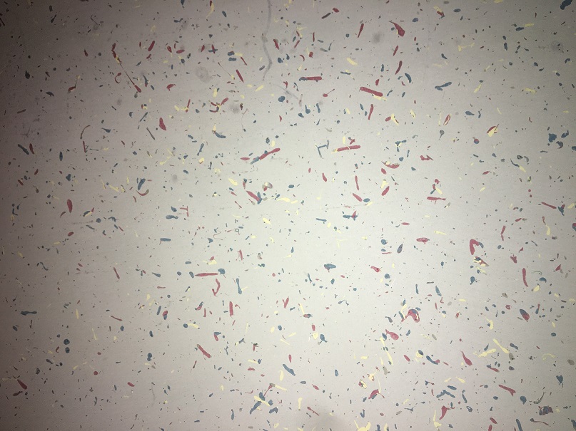

The interior of my 1960 Texas Maid Tahiti has a nice original spec paint that is 80% good throughout the boat. I doubt I can paint match it but not sure. I would willing to paint the whole interior but need some input. Here is a pic of the paint, is this stuff available? Does it roll on or need to be sprayed? Thanks for the input

That picture you posted of that interior paint looks like "Zolatone" and YES, you can still get it! I will get a link up here for it so you can order it if you want to.

I agree with all that has been said about tcp and Zolatone. You should be cautioned with regard to using Zolatone. It takes a really big tip and low pressure to work correctly. Personally I like a gun with a 2.0 mm or bigger tip gravity feed HVLP gun. Since Zolatone has gotten so expensive I would suggest that you set up a pattern panel so that you can quickly adjust your gun for maximum performance with little wasted material. Good luck.
