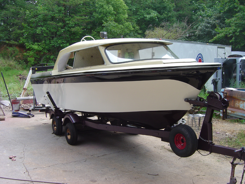

Cool - that must have been a very well designed hull to do that.
Do you have any more picts? I really like the lines of the cabin, but the pic is very small.
Bruce

I'm in the process of making up a photo-gallery of the resto/rebuild.
It'll probably be up in a few days.
