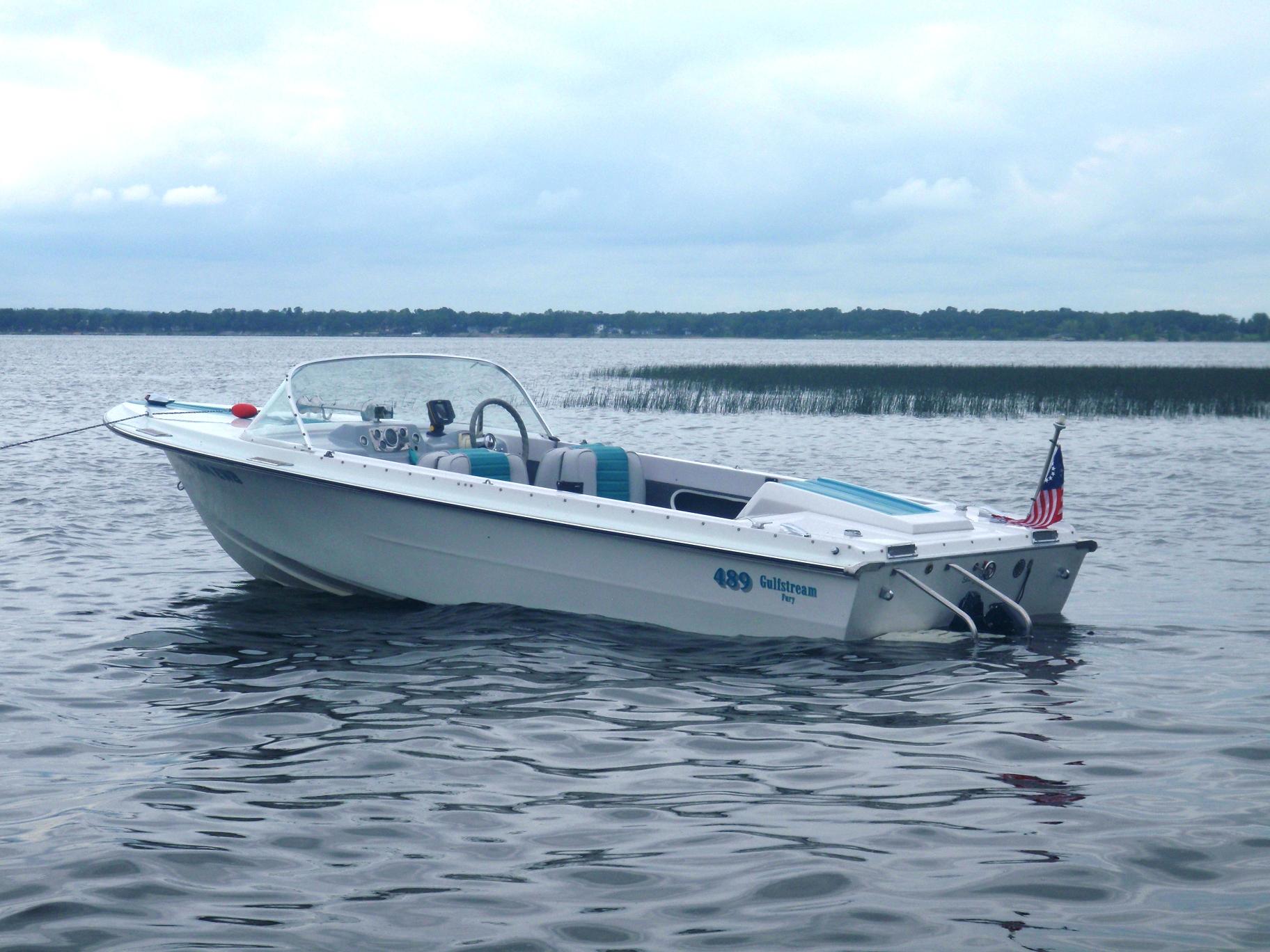

Howdy all, I used to be a member of this site back in 2000 and I am back! Back then I had just purchased a 1967 Gulfstram Fury. Members on this site were helpful in identifying the boat and helping me get it going. I lived in Denver Colorado then. I now live just south of Plattsmouth Nebraska on Beaver Lake. I have lived here since 2002. I still have the boat and enjoy it very much. I replaced the floor last year. That project involved replacing wood, floatation foam, motor mounts, new 3/4" marine grade plywood deck, fiberglass and carpet. I re-gelcoated the transom and a spot on the bottom of the hull. She turned out great and is about 250 lbs lighter due to the removal of the wet foam. This boat has a Mercruiser 160 HP stern drive with power trim. I have been told that 1967 was the first year Mercruiser offered the power trim. If anyone has any info or stories about this model of boat I would love to hear about it.

She looks really nice Hec, welcome back. Post some more pics when you get a chance.

she got a v-8? through hull exhaust? that is a bad axx looking ride. I like the lines and the way she sits in the water

Thanks man. I wish it had a v-8! It's got a Chevy straight 6 250 cubic inch. Mercruiser 160 Hp sterndrive. It doesn't have through the hull exhuast. The two rectangular grills in the transom are simply air vents that direct air from the bottom of the engine compartment out the transom. It sits low in the rear doesn't she. The motor, two 12 gallon tanks and batt probably are the reason. I know there isn't a drop of water below the deck anymore so it can't be saturated foam. I wish she would sit a bit higher in the rear. I guess that's how she is supposed to sit.

Look at it this way Hec, the V8 would be heavier and burn more gas! While I do understand the desire for more power, I'll bet that 160HP get the job done just fine. That's a beautiful boat, can't wait to see some more pics and hear more about the restoration process.

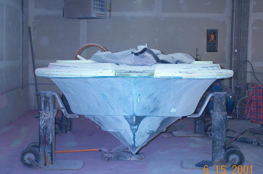

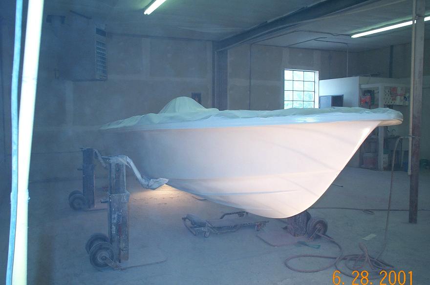

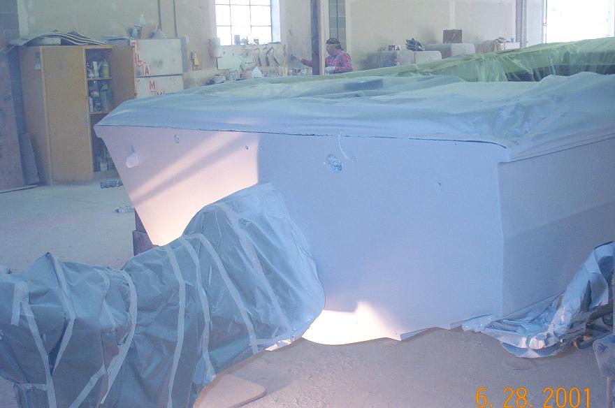

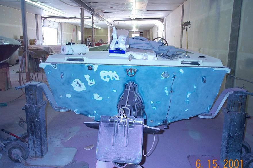

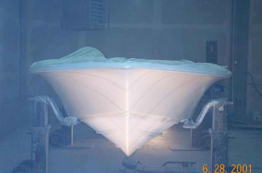

Here are some pictures from 2001 of the boat being sanded down and re gelcoated. When I purchased the boat it was painted a metallic blue. Underneath the paint was the original yellow and avocado green gelcoat just like the pictures in this websites library. I changed the yellow to an offwhite and the avocado green to teal. I also changed the avocado green dash to gray. I will add pictures later on the floor project of 2008-2009. Yes it took me two summers (almost 3) to complete. Having a new baby slowed me down!
