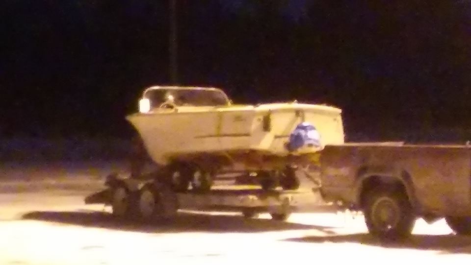

Now, not only do I have a dorsett sea hawk, I have a pretty decent all original 59 or 60 beuhler turbocraft. Plucked from Duluth MN

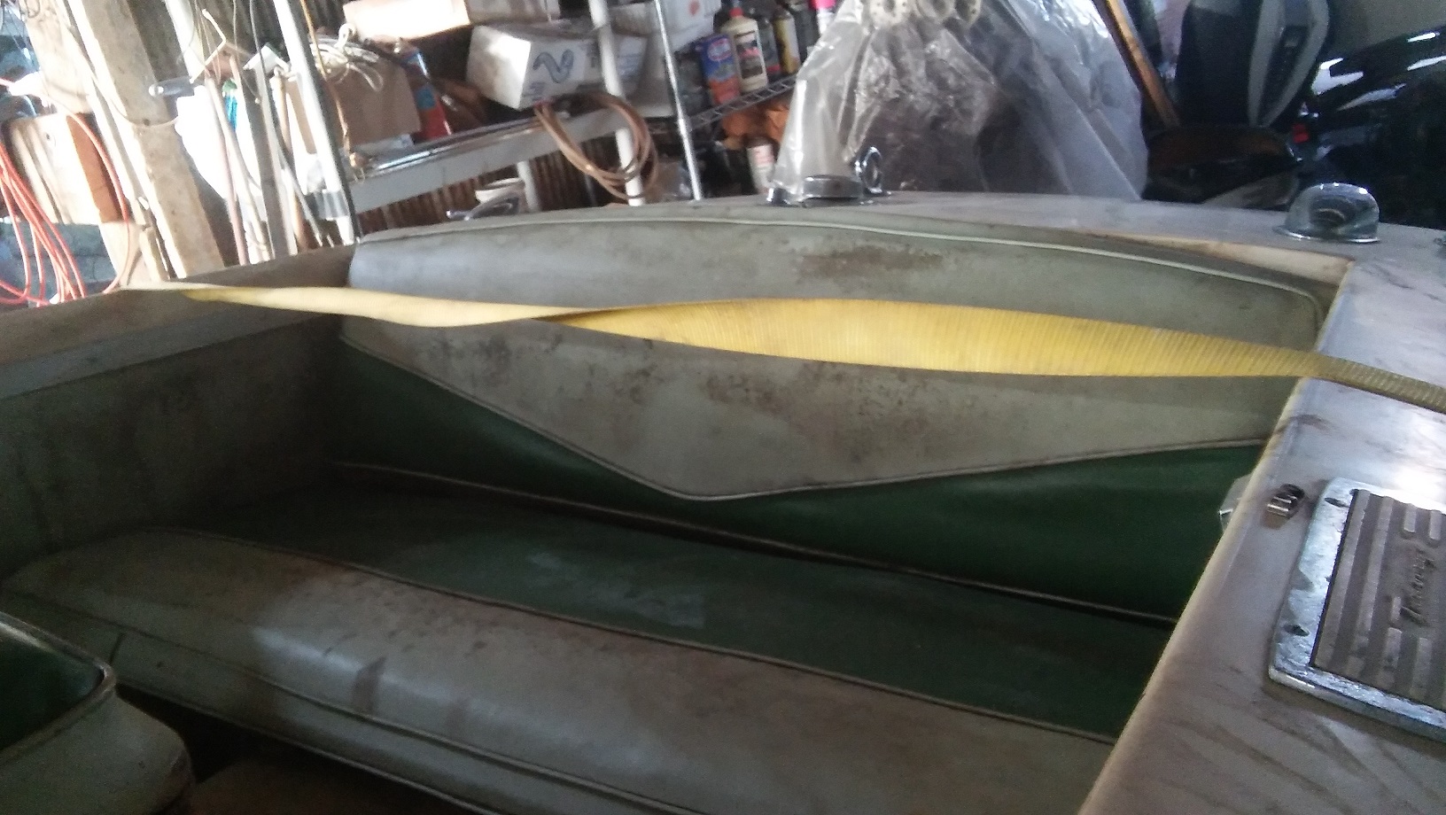

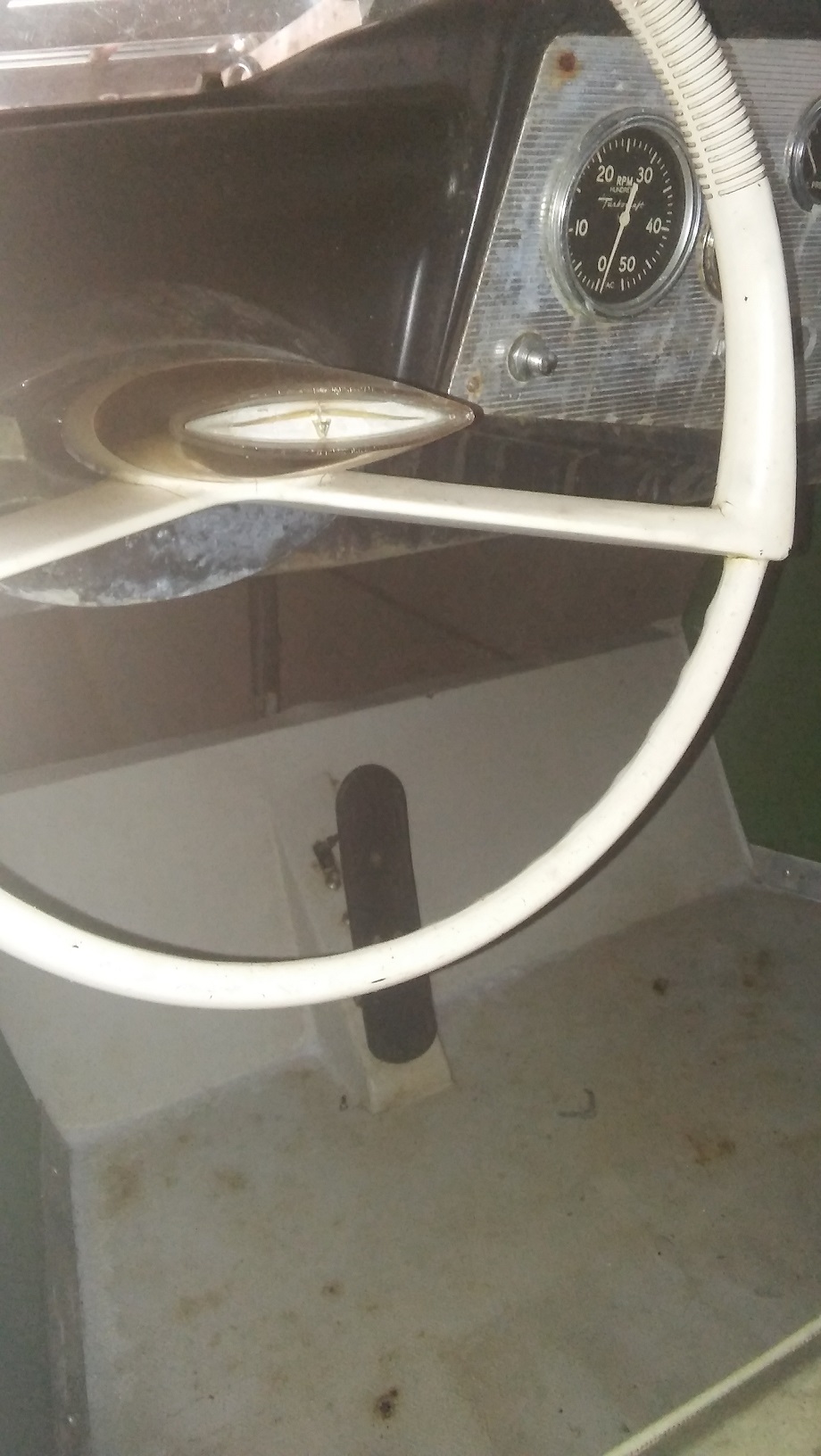

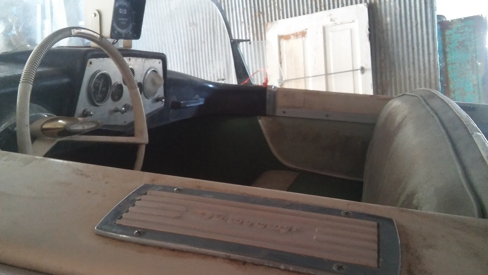

some pics I snapped today of the interior... the material is not brittle or dried out at all.. very pliable. Hoping it cleans up well...

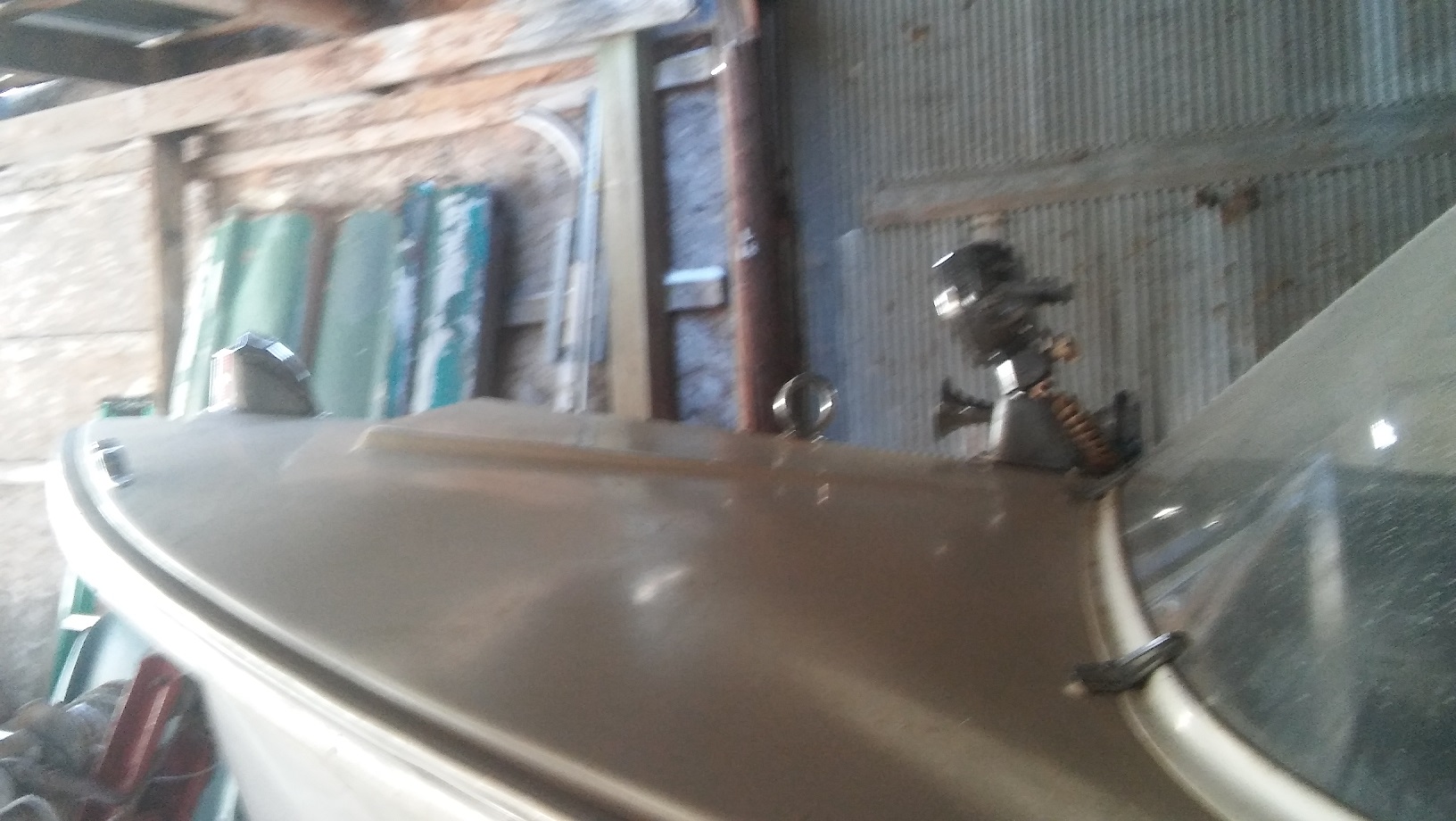

and the nice and fresh canvas navy top.. I am however missing the frame...

Shake, just about any canvas or auto upholstery shop can make up a frame four you.
I could use some info on that type of steering wheel you have. The one that is on my rocket has the silver inside the plastic center fading and disappearing. Do you know of any way to strip that silver paint off without harming the plastic? I can then splash paint inside the plastic to match my boat.

Shake...I also have a 60 turbocraft.I have a frame for the top but not the canvas.If you want to sell it,let me know.I can have one made,but I wouldn't mind having an original one.What motor does it have?Does it have the push button hydraulic gate control?

Cal, I dunno what would remove the paint without fogging the plastic,,,, I wonder if possibly testors paint thinner might work... Let me know if you need more pictures...

Caution: do not use testors paint thinner to remove paint from a clear plastic piece, it will haze. Example: I have an old line control Cox airplane, AT6 Texan, and I wanted to paint the frame detail on the planes canopy. Well, I painted it but didn't like the results and thought I'd remove the paint and start over. I used some Testors Model Master thinner and was shocked when I saw that the thinner was clouding up my nice smokey clear canopy. I was able to lightly sand the canopy and restore the clarity a little but it's not the same as it was. I would be careful with thinners.

Did the steel wool thing this morning with 00. When I was finished there were brown stains on the inside of the plastic from age so I did a quick rinse with lacquer thinner and immediately washed it with hot soapy water (within seconds). Cleaned out the stains. I coated the inside with color match from the boat and now waiting a few days for that to dry. I have found over the years that if you want to bring back the shine on those small plastic pieces after cleaning a coat of high gloss clear lacquer does the trick. There was one crack in the plastic so that will probably show but I think it will be satisfactory. Pictures in a day or so.

Good to hear that you had success and that crack will only add character!!!!

That is an awesome looking boat!! It looks to be well preserved, a real 'survivor'. I love the upholstery in that era...and the dash too. Very cool and space age.

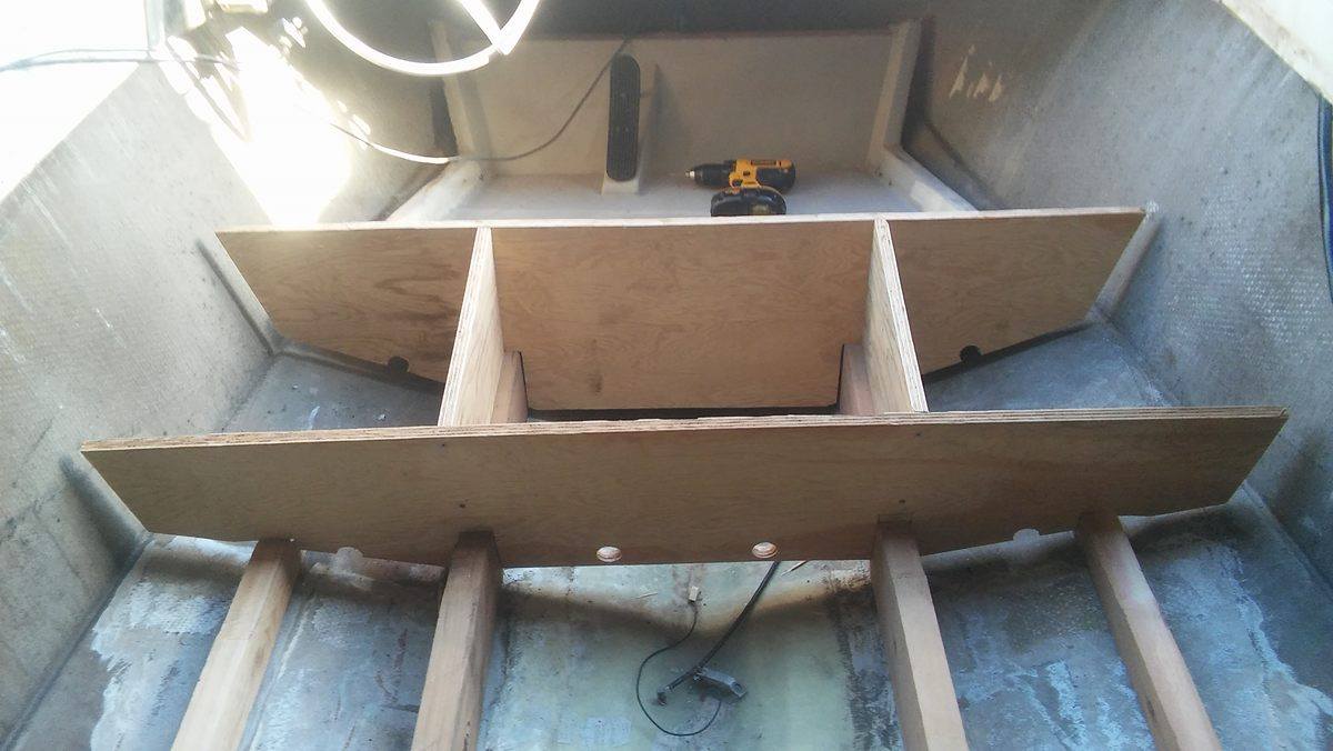

you can check out my progress on my facebook turbocraft fan page here.. Buehler Turbocraft & Dowty Turbocraft boats www.facebook.com/groups/264133554009196/

Looks like you have a great start Joe. Would like to see more progress pictures here, facebook has too much garbage between posts.
