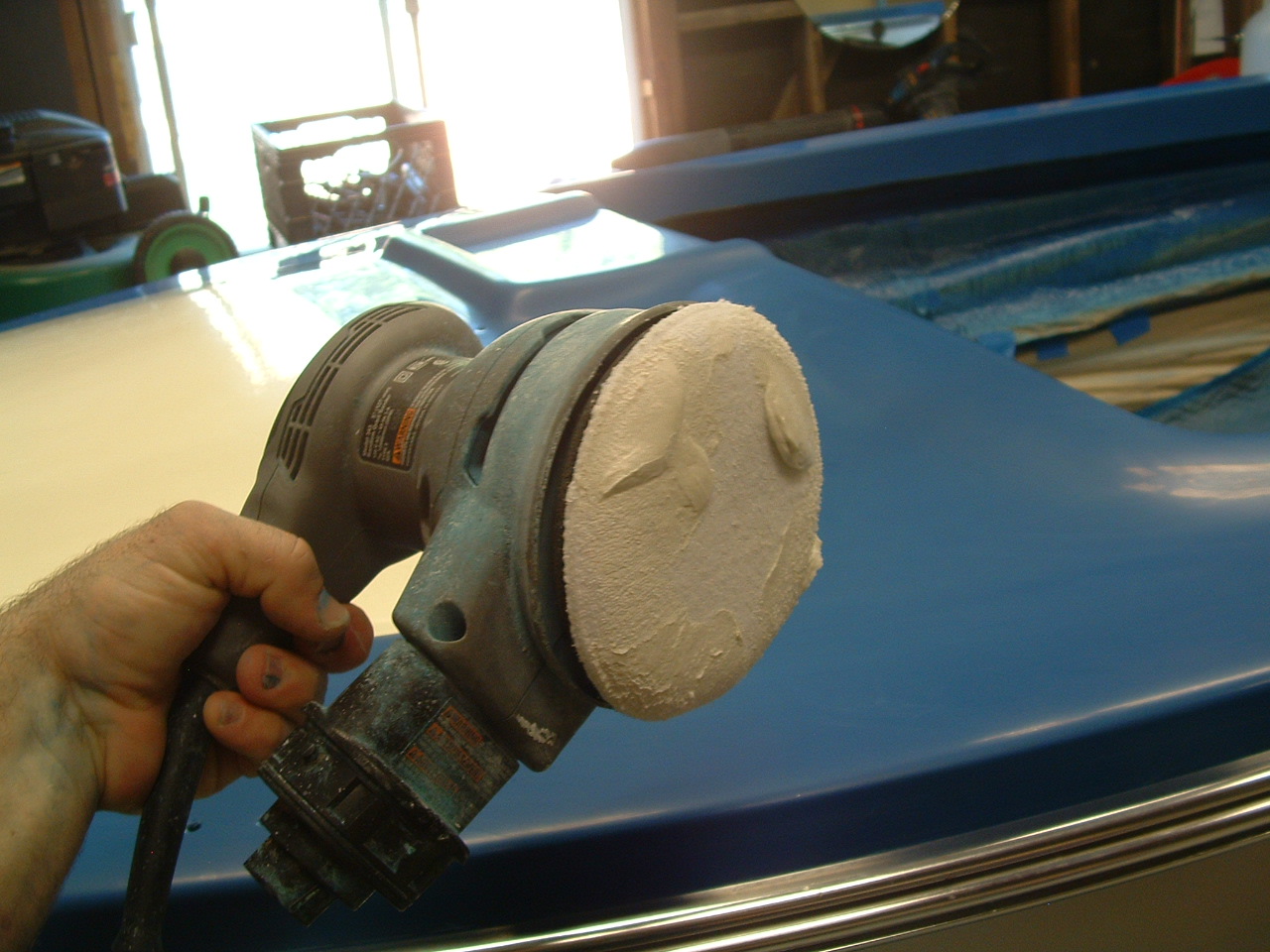

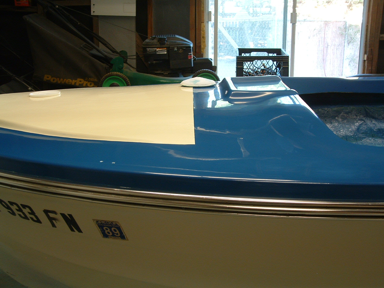

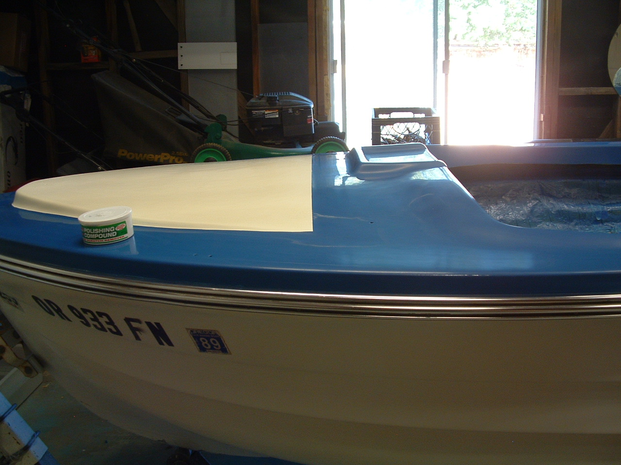

You Can probably hand sand everything like he said very lightly then use turtle was buffing compound in the red container and hand buff the deck but remove residue when it is still wet doing a sq ft at a time but this can take alot of your precious finish off so be careful then do it all over using the turtle wax polishing compound in the green container but this time you can be rougher then wax away and hopefully itll look new again.
The red compound is more gritty then the green but it would be nice to have a buffer on the last step with the green polishing compound. In the past I ise a rendom orbital sander and used contact cement to stick a new pad on then polished away.
The last two pics are before (the green polishing compound) and after however this is paint but you get the idea. Keep in mind gelcoat dosent shine like paint does and I dont know if this is the best way to shine gel coat and I think you want to use a marine wax on gel coat, Mike
