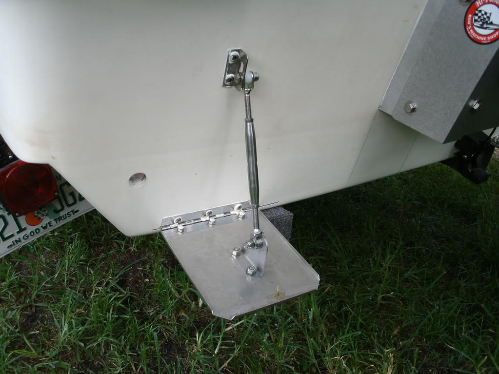

Rather than adding weight, I'd try trim tabs or at least one stationary tab on the starboard side that is be manually adjustable. It won't help when the boat is sitting still or at idling speed but once she gets moving. it should level out fine.

You might also try adjusting your trim tab's aft end hard to starboard, and see if it helps.
Another cause of the described behavior can be if the bow is dragging heavy in the water - perhaps because there is not enough positive tilt applied. (bow steering)
