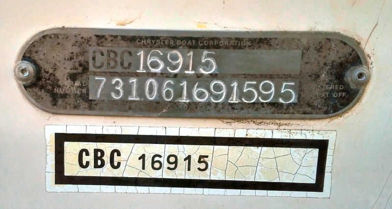

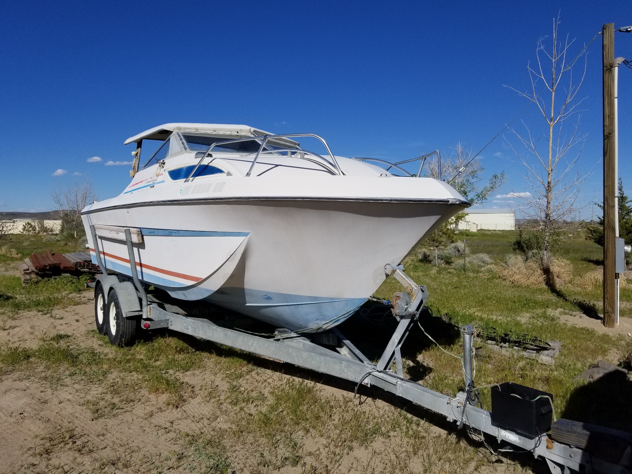

I just picked up a Chrysler C-486 Cruiser. It was sold as a 1973 but after doing some research I believe that mine is actually a 1974 or 75 model.
There does not seem to be very much info on the internet about these boats.
From what I could find these seem to be the largest boats made by Chrysler. Its 23' long with a 96" Beam. They were made from 1968 to 1977 but the styling of the cubby windows and the decals on the sides of my boat did not occur until 1974.
Does anyone have the following?...
1. Serial Number Information (mine is 731061691595)
2. Where I could locate an Owners Manual
3. Were is the Serial Number located on the engine? (I believe mine is a 318 V8. It has a "Super Bee" air cleaner.
Thanks!

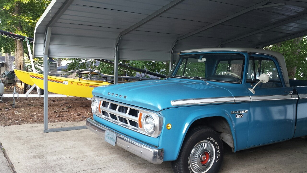

Re:Just aquired - Chrysler C-486 Commodore Cruiser 10 years 2 weeks ago #127263
Very nice, she's a big girl for sure. I'm a Mopar guy at heart and have a 1968 Dodge D100 truck that my Pawpaw bought new. My truck has a 318 V8 engine. Would love to see a picture of your boats engine and air cleaner. Happy Boating!!!
My truck at the cabin with my Hobie Cat H16 in the background.
Marty
Keeper of Pawpaws Boat
1962 Span America

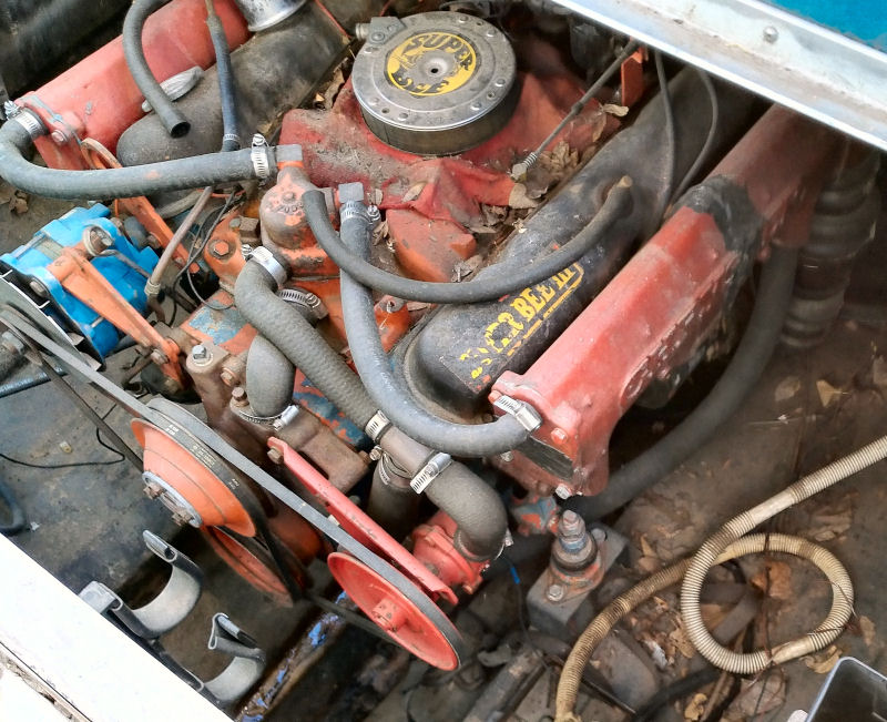

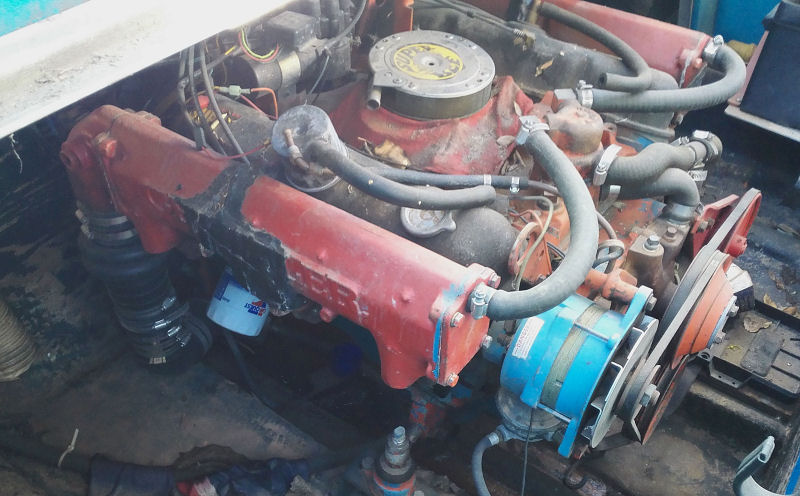

Here is a picture of the engine. (The carburetor is off at the moment being rebuilt).

That's a cool engine. The valve covers have Super Bee III on them. My Brother-in-law has a 2014 Dodge Charger Super Bee, can't wait to show him those pics, always kidd him about his car not being a "real" Super Bee like the '68 to 70 models.

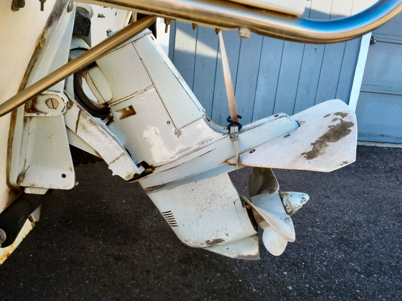

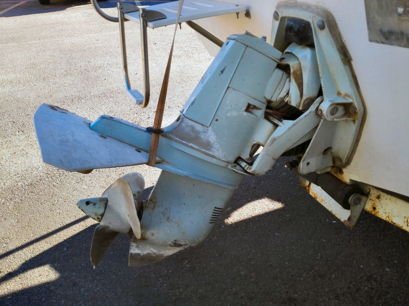

I have attached a few pictures of the stern drive. Anyone know its brand and model number? I cant find any numbers on it...maybe I don't know where to look. I need to know the correct lubricate to use in it.

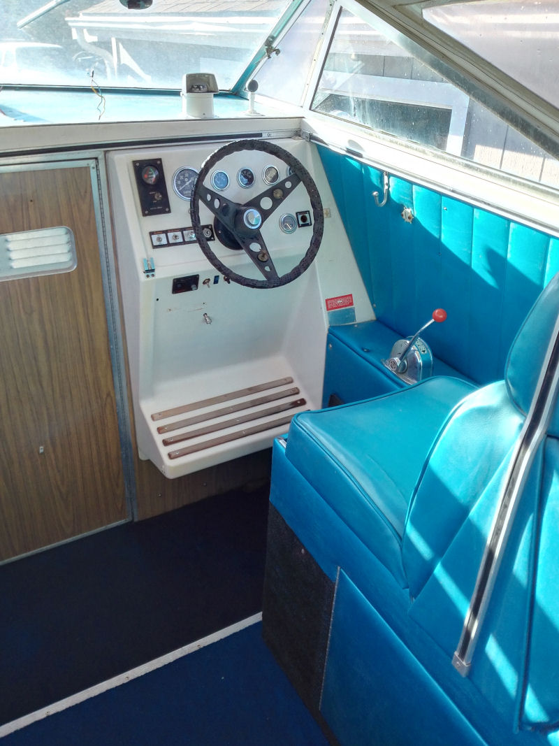

Re:Just aquired - Chrysler C-486 Commodore Cruiser 10 years 2 weeks ago #127350

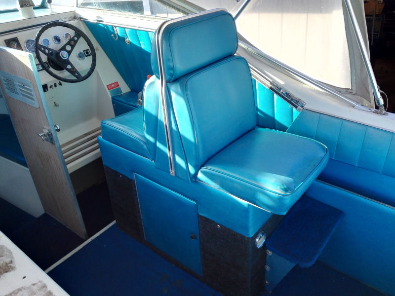

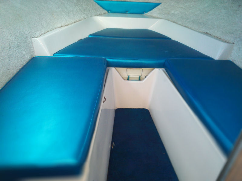

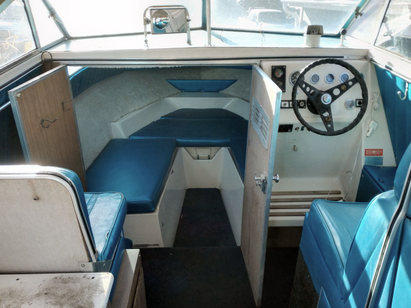

Here are a few pictures of the interior. Check out the shag in the cubby. Yeah baby!

Re:Just aquired - Chrysler C-486 Commodore Cruiser 10 years 2 weeks ago #127364
Mark,
I totally forgot to add this last night about the year of the boat. The serial number really doesn't mean a whole lot from what I have learned about the chrysler boats. What you can do is look at the block to see what size the motor is. IF its a 318 it will be cast into the block above the starter. Also on the other side you will find a clock looking thing case into the block and sometimes there stamped too. This is the production date of the block or engine. I have several mopar engines around here so let me know if you need help. I have been building mopar race motors for 30+years for our drag cars so trust me when I say parts are easy to find. Now the date code will tell you the year of the boat because the engine was made the year before as a rule.
Outdrive 10 years 2 weeks ago #127423
That's a very common Volvo Penta AQ series drive. Should be a metal tag near the transom shield with numbers and letters that probably have either a 27 or 28. That would designate a 280 or 270 outdrive. Plenty of available parts around.
Re:Outdrive 10 years 2 weeks ago #127444
I really appreciate the info about the stern drive. I have looked all over it but cannot find any tags or stamping's.

Well...it looks like the engine is a 340CI. I dont know the year yet but I should have it figured out tomorrow.

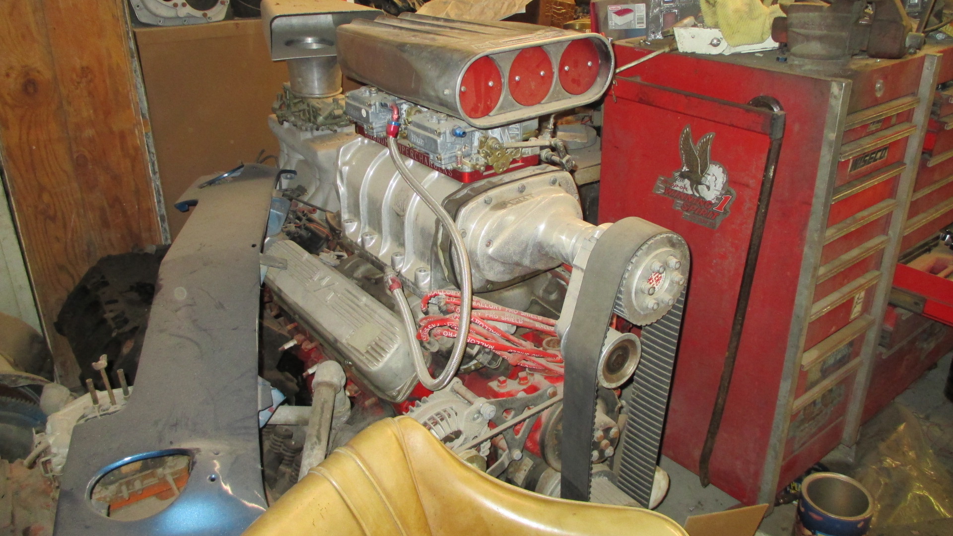

Re:Just aquired - Chrysler C-486 Commodore Cruiser 10 years 1 week ago #127524
Gee thanks mark. Ya I am kinda a mopar nut lol I am no Doc more like a Mad Scientist MUUUHAAAA!!!
SOrry I didn't get back to you till tonight. I did some research and the superbee III was a 340 and 340 is cast into the side of the block. Now as far as supercharging it, I would strongly advise you don't do it. First off you would need to spend about 10 grand on the motor to handle even 10lbs of boost. Plus that drive won't handle that much HP. Most aftermarket blowers exceed 10lbs more like 12 to 20lbs. I have worked on and built a bunch of Blown engines for racing and street. I learned a great deal from Mel Riggs regarding marine supercharged motors, Mel ran Mercurys offshore racing. I mostly have worked on Blown 502s in a marine app, All marine blown engines need inner cooler systems too so a auto supercharger like you have shown won't do anything but rip that 340 apart. SO what I am saying is enjoy it as it is. That 340 will put out 280hp give or take if its in good shape. I would guess your top speed at about 38 to 40mph and thats movin for that ol tub.

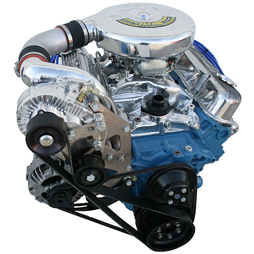

Here is a pic of my 850hp street blown 440 its going into a black 70 charger yet this fall.

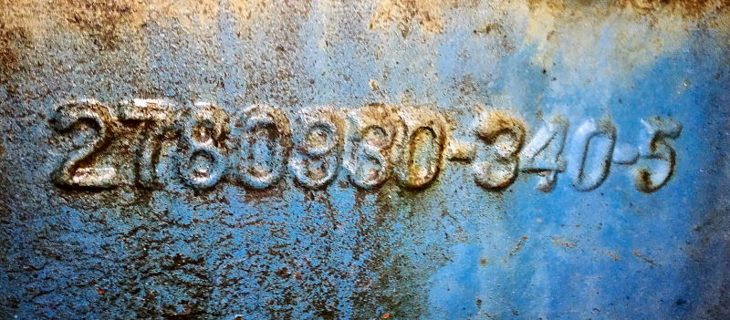

Re:Just aquired - Chrysler C-486 Commodore Cruiser 10 years 1 week ago #127562

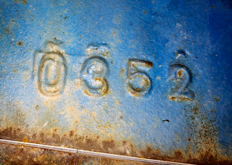

Here are a few pictures of the block casting numbers. What can you tell me?
I forgot to take a picture of the numbers stamped on the front pad. I will do that tomorrow.
Re:Just aquired - Chrysler C-486 Commodore Cruiser 10 years 1 week ago #127568

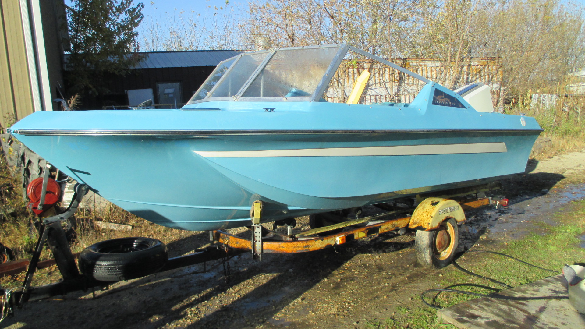

Ok thats what I need to see. The -340- in the casting number means its a 340CID and Date code on the block would be refered to as a 68 block But it was cast June 28th 1967. Now they cast many blocks and prebuilt countless motors that were crated up to go into marine apps. IF it was a car this motor would have been in a 68 GTS dart for instance. However being its a marine block the date code means very little as to the year of the boat. But this means when you need parts you tell them you have a 68 340. Now I will tell you that the 68 340 is the best block to have do to the high nickle content which made it very strong. Racers go gaga over them so you have the best of the best. Also this is a steel crank motor too so there pretty much bullet proof. Now this goes for all marine engines on what I am about to say next. People ask me all the time can I put a car or truck motor in there boat and I tell them no it will not live long. Here is why. First off the marine blocks are cast thicker in the main journal area to make them stronger for continued RPM. Which leads me to this part. Car and truck motors are designed for sustained RPM at 2500 to 3000rpm and marine apps are 4500 to 5500rpm so the engine balancing is totally different. Also load is different too. Marine is constant load and auto is on and off load. Ie varied speed and shift points in auto. Marine is full load and sustained RPM. As for using this info to figure out the year of your boat you can't really go by when your motor was made as chrysler made tons of engines and crated them up till they were needed. This has been talked about widely with the guys in The Chrysler Crew. Still the best way to determine the year of your boat is title info or brochure pics. Look at little details like logos and styling and do your best guess. I had a heck of a time figuring out my Charger boat and thats how I did it. It was registered with the wrong year. Keep this motor stock or it will eat that drive up. I will tell you, if you are hell bent on making more HP it will only cost you more money in broken parts down the road. I know there is a hotter cam that is offered for the Conqueror III Jet model that jacks up the RPM but that boat is way lighter and your boat is heavy so you need a torque motor not a high rev motor. I hope this helps ya.
Here is a pic of a bit of a sleeper marine 340 in a hotrod 79 dodge truck, lol Ya its mine. Going 750hp 440 next with NOS so I can get into the 9sec range. 12sec is way to slow for me. I forgot to add this comment. You can put a marine motor in a car but not the other way around. Marine 426 hemi X Blocks were used in Nascar by Richard Petty and also by Sox and Martin racing. Last picture is my 426X block in my 70 charger, Petty Block and Sox and Martin aluminum Heads.

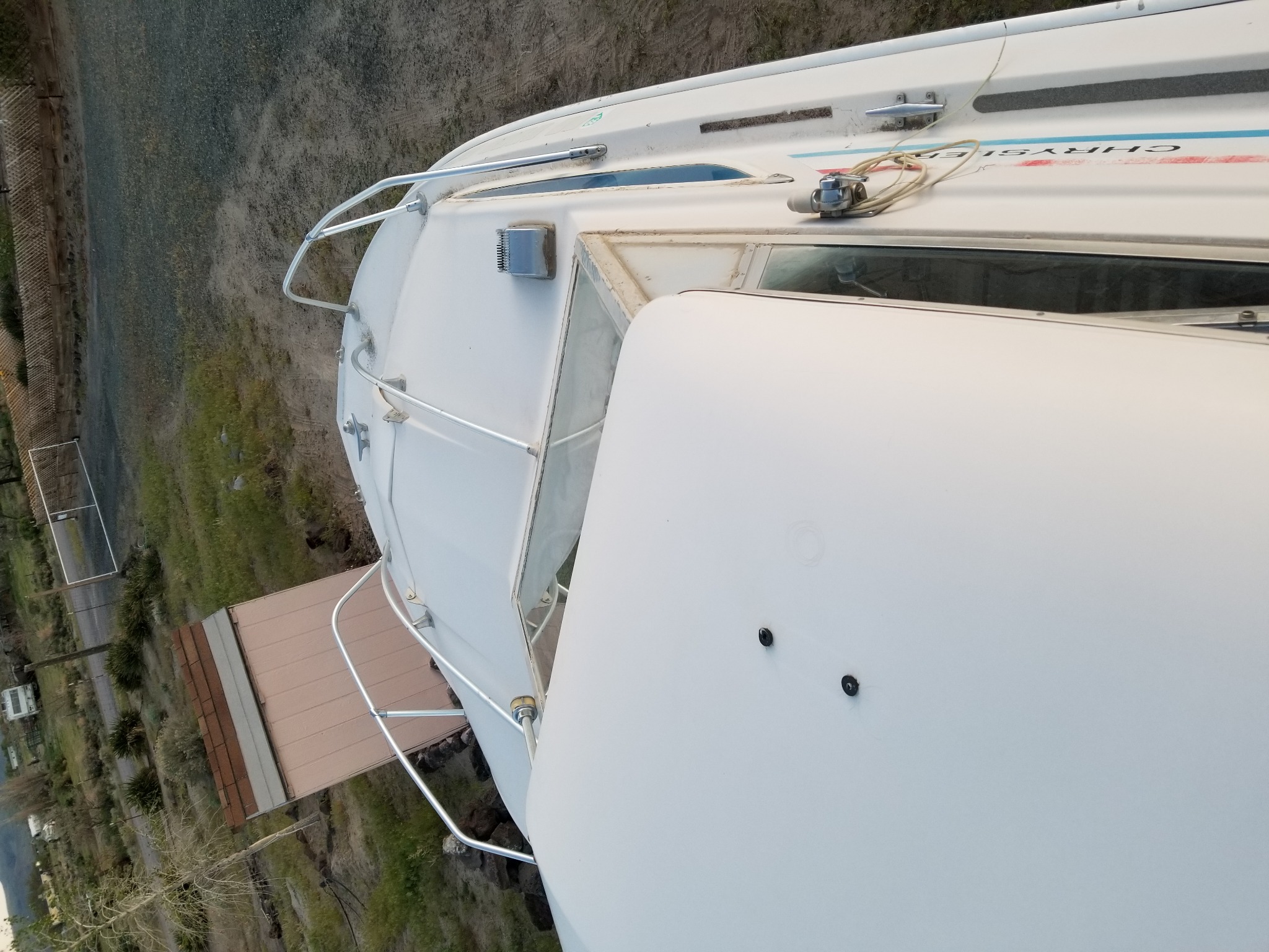

Re:Just aquired - Chrysler C-486 Commodore Cruiser 10 years 1 week ago #127577

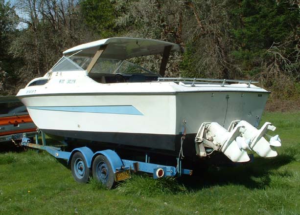

During my research of this boat I found that a hardtop was an available option.
I would really like to have a hardtop but I know that finding an original would be next to impossible. That means I need to make one.
The problem is that my shop is not really set up for fiberglass manufacturing and I really don't have the time. If any of you forum members are in Colorado and would like to build a top please contact me.
Thanks!
Re:Just aquired - Chrysler C-486 Commodore Cruiser 10 years 1 week ago #127578
Patience Mark lol your going about it the right way. I don't think there is a manual for what you have to do, so keep doing what your doing. I would bet that its propped correct so watch the tach. Minor things like changing intake and carb could be a benefit down the road but best get it wet first. Gear oil is just 85/90 old school. Check with Franz on the chrysler crew yahoo group. Good group to join for parts and knowledge.
I may have a lead on a top or a glass guy in your area. Camper tops are way nicer, less weight and easier to store. The coolest thing you could do is put in transum exhaust and let that 340 breathe and rumble. Again I know people that can make that happen.

Re:Just aquired - Chrysler C-486 Commodore Cruiser 10 years 1 week ago #127579
I forgot to mention to check the water pump impeller located on the right side of the motor. I would bet its cooked, Watch your engine temp very close if you don't replace it. I would replace it before even thinking about putting it in the water. they get stuck and when you fire them up it rips them apart. I took one out on my 312 Chris Craft Stinger and it almost cost me a 502 motor. I have the same type of pump.
Re:Just aquired - Chrysler C-486 Commodore Cruiser 10 years 1 week ago #127587
I really want to duplicate the style of the original top so I dont think a camper top will work. If you know of a good fiberglass guy in or near Denver please let me know.
Thanks!
Re:Just aquired - Chrysler C-486 Commodore Cruiser 10 years 1 week ago #127588
I tried to get a photo of the numbers stamped into the front of the block but I could not get the camera in there so I had to settle for writing the numbers down;
DW34022590314
340
77768J
Hopefully you can give me some more information about this engine.
While I was working today I noticed that one of the block drain plugs had been removed. I assumed this was done by the previous owner to drain the block for winterizing. I replaced the plug today.
It appears that there is a drain plug on each side of the block. Are these the only two or are there other locations I should look for?

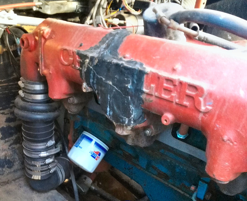

If you look at the attached photo you can see that both of my exhaust manifolds have a large amount of some kind of epoxy painted in the center.
I have a bad feeling that this engine was once frozen and the manifolds cracked. I have not put water in the engine yet so I don't know if they leak but even if they don't I would feel better with a new set.
If anyone knows where I can find a set please let me know.

Re:Just aquired - Chrysler C-486 Commodore Cruiser 10 years 1 week ago #127593
I will try to answer most of this.
Engine Numbers
D= 1968
W= Water tested
340=cid
22500314= Production number
77768J= no real explaination but could be related to the heads, the 68 could be year J was common for the 2.02 valve head. In automotive apps the J was cast on the outside of the head.
There should be drains on the manifolds too on the bottom. IF it was not properly drained that is why they cracked or from to much heat then cold water hitting them happened too. Now finding a good set of manifolds would be tuff and that goop on there is JB weld. A common fix from back yard mechanics. IF you send them to me I can weld them but not that big of deal if they don't leak leave them go. Water pump impeller rebuild should be on your to do list after first fire up. oh and yes there is plugs on both sides of the block so make sure they are in before fire up. DON'T try to use muffs to feed this thing water for fire up. Put it in the water at a boat launch and leave it on the trailer.
You have not talked about the carb yet other than it was off. IF your rebuilding it I would like to know if its a AFB OR AVS. AVS will have a door over the secondaries, Ie Air Valve Secondaries AVS.
Now on to the glass top. Big boat scrap yards is your only hope to find one. I have some connections so I will get the word out but I am sure there will be a silent moment fallowed but laughter. IF you had a used one I could pop a mold off it. I make Polaris PDC hoods here at the shop so I can make stuff. BUT I have a Buddy Mark that lives in Denver and he has a Span boat I sold him, he had it restored some place out there. He did it the right way with all new gelcoat so that would be the guy you need to find. Regardless that top is going to cost you a fortune to make so used would be cheaper. Count on it being trashed and needing restoration. I will call Franz, Dave and Mark tomorrow.
Again I can NOT STRESS THIS ENOUGH INSPECT THAT WATER PUMP. UNLESS YOU KNOW IT WAS FIRED UP IN THE LAST 6MO. About every offshore boat I work on has junk impellers from sitting. When I fire them up I try to prelube them with waterpump lube so they don't start dry. When I rebuild them I lube them with Vaseline. they spin really fast and get hot quick.
Re:Just aquired - Chrysler C-486 Commodore Cruiser 10 years 1 week ago #127594
Here is a link to the actual block casting numbers and about 1/2 way down the list you will find the numbers you posted above.
www.rosevillemoparts.com/reference_castingnumbers1.php
Re:Just aquired - Chrysler C-486 Commodore Cruiser 10 years 1 week ago #127596

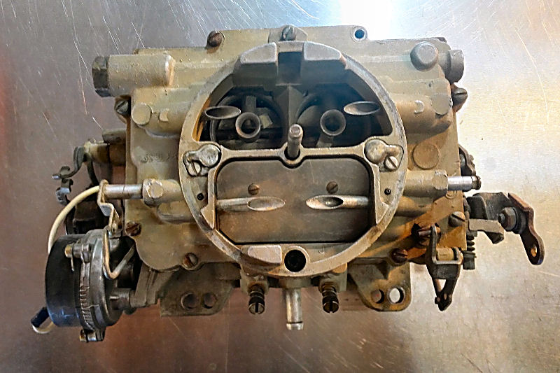

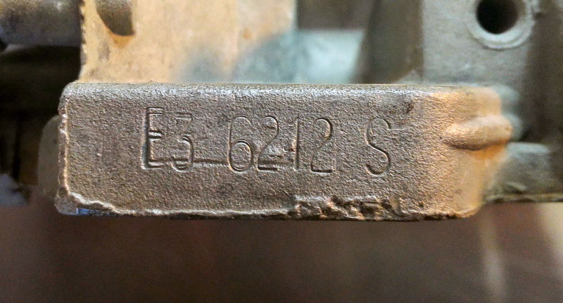

As for the carb...its a 6212S AFB. It has the weighted butterflies over the secondaries. I have already completed the rebuild and reinstalled it on the engine.
(These pictures were taken prior to cleaning and rebuilding)
Thanks!

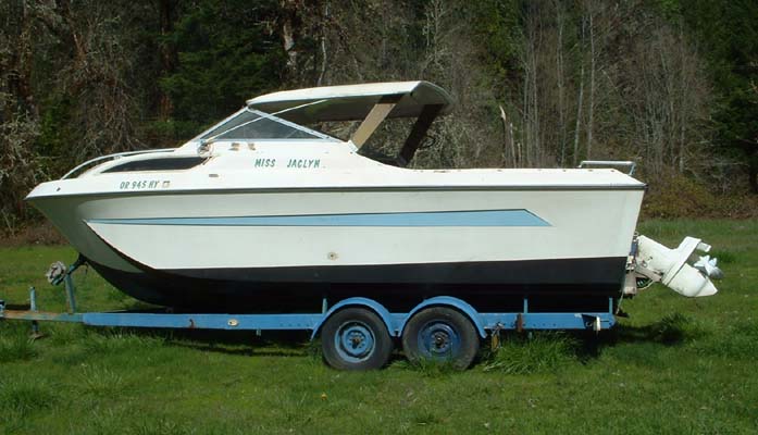

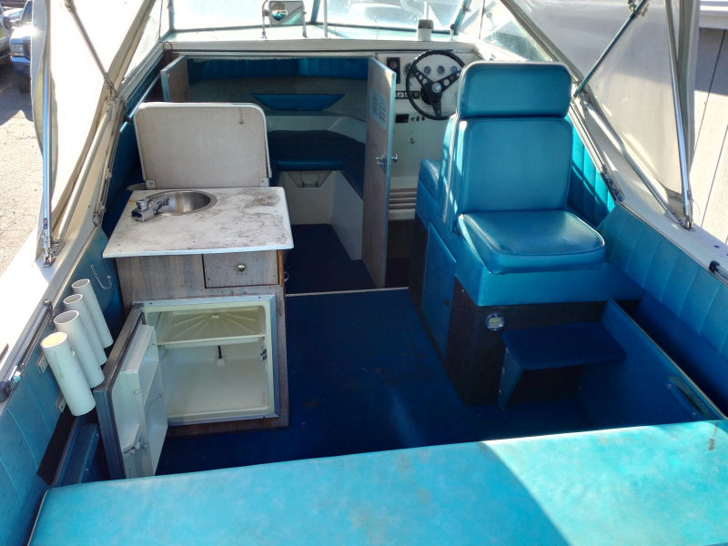

I too have recently purchased a Chrysler C-486 with matching Chrysler trailer. It has the optional hard top. I can give you measurements of it of you like. The guy I got it from sold it to a kid who never paid him so he got it back and found the kid was working on the inside of the boat ripping out the foam because he said it was squishy. Has the 340 motor . No heads or intake. Thinking about getting some 308 heads for it . Your boat looks way better. I'm going to restore this one and get it back in the water .

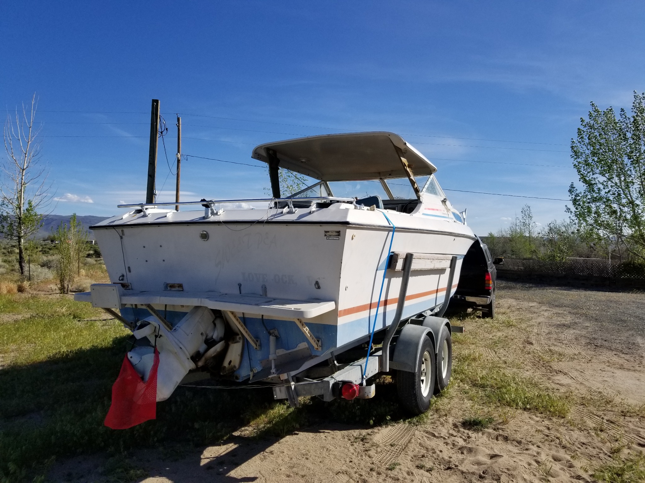

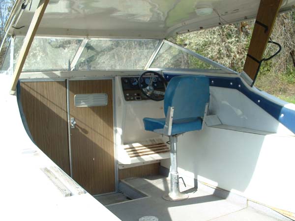

My Chrysler C-486 has the factory hardtop and twin Volvo 4 cylinder engines, great for the ocean. The owner's manual that I got with it is sort of generic, not specifically for the C-486 but covers all the Chrysler boats from that year. I like the hardtop but the wooden struts supporting the top don't really match the style or look good.
